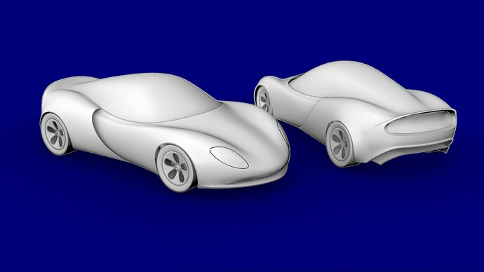

I have already designed the body on cad. The program is going to be used for cam.

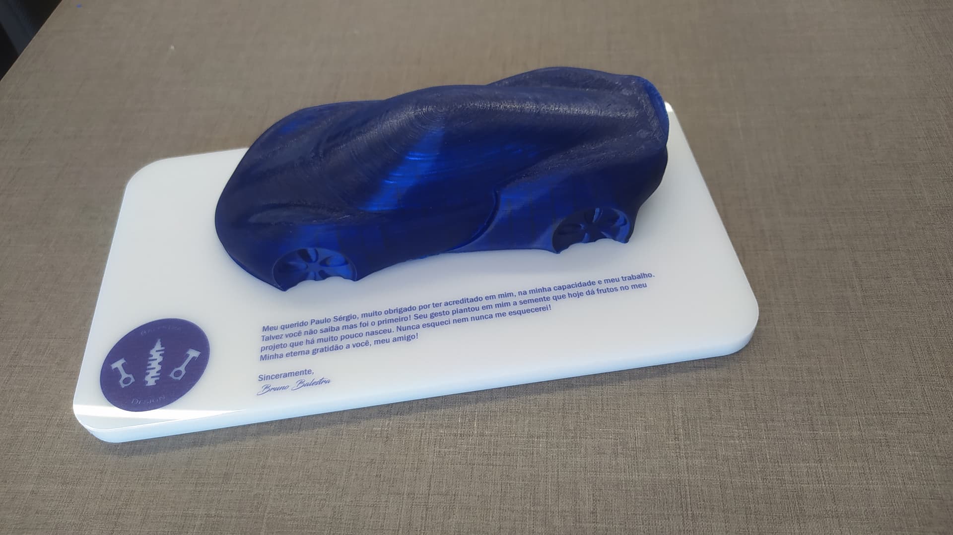

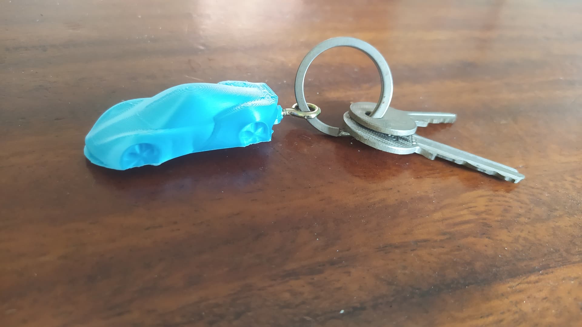

This is my design those are a keychain and a simplified version I 3D printed as a sculpture.
Even though I have been doing 3D printing for a while, CNC is kicking my butt.
My intention is to only use it for cam. I use rhino 7 for modeling and that program can export in so many different formats. It’s own format is 3dm, but it can import and export OBJ, STL, iges, SOLIDWORKS files, DXF, dawg, illustrator and so on.
I got the shape dialed in and now moved on to the important things we don’t think about when dreaming of building a car, such as door jambs, seals, hinges, where body parts join and fix to the chassis and etc.
