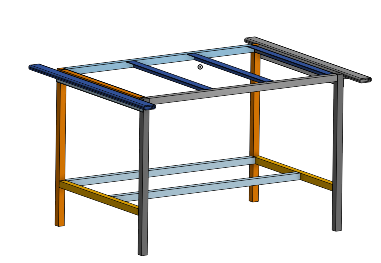

Yeah that’s what really motivated me to replace the table I was using. I designed this to fit my tool chest under the front with a bit shelf area in the back I plan to use for cutoff storage.
One mistake I made was that I got some measurements in my head confused. I thought I would have 18" next to the tool chest to build some drawers under the bench. But that was based on the rail to rail width not the leg to leg width. So I have an 8" wide x 20" deep x 34" tall space next to the tool chest mocking me. I’ll need to figure out a good use of the space. Maybe some sort of pull out then flip out laptop stand.
You could mount a vertical piece of wood on drawer slides and then hang tools on it.
Or spray paint storage.
