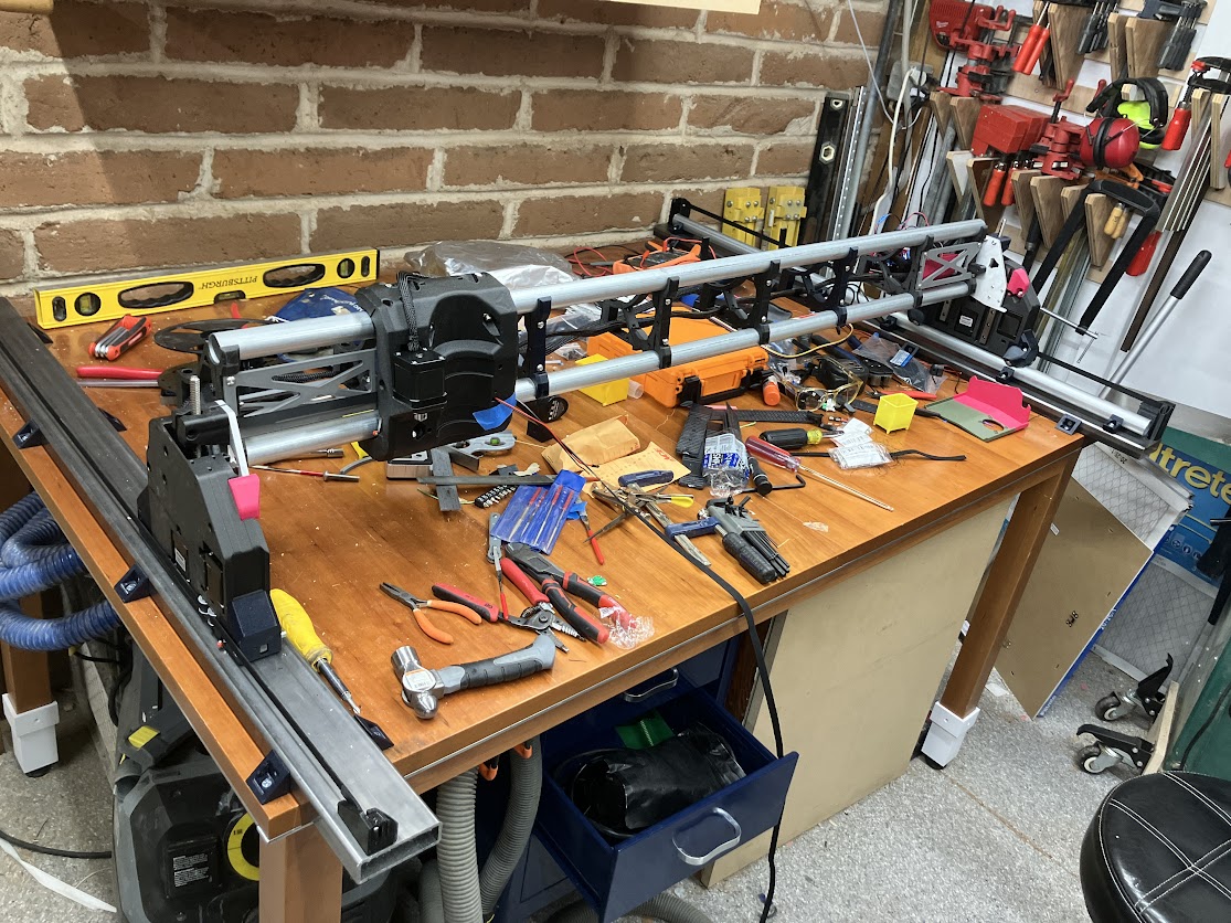

I finished installing the belts and powered on the motion system last night. Man seating the x belt was a real pain! But it was super fun to see it move around! Tonight I’ll clean up the area and start squaring the machine.
I ended up using 1"x3" steel tubing as for tracks under the y-z assemblies. This is because the dining table I’m repurposing has a nearly 1/8" dip in the middle. So I settled on this as the easiest way to get the two sides co-planar. Then I’ll just use the machine to flatten the spoil board.
Nice idea with that steel tubing. I think I’ll do that too :smiling_face:
Yeah not the cheapest option or necessarily better than wood but for me at the time it was the simplest. I was able to order the tube cut to length for a reasonable price and have them bring it out to my car without me unloading my 1 and 5 year old.
I pre-drilled pilot holes for drywall screws (yes drywall screws in steel justification) for the y rail clips. Then I put the tubes on the table and attached them with some little 3d printed 90 degree clips after checking them for parallel.

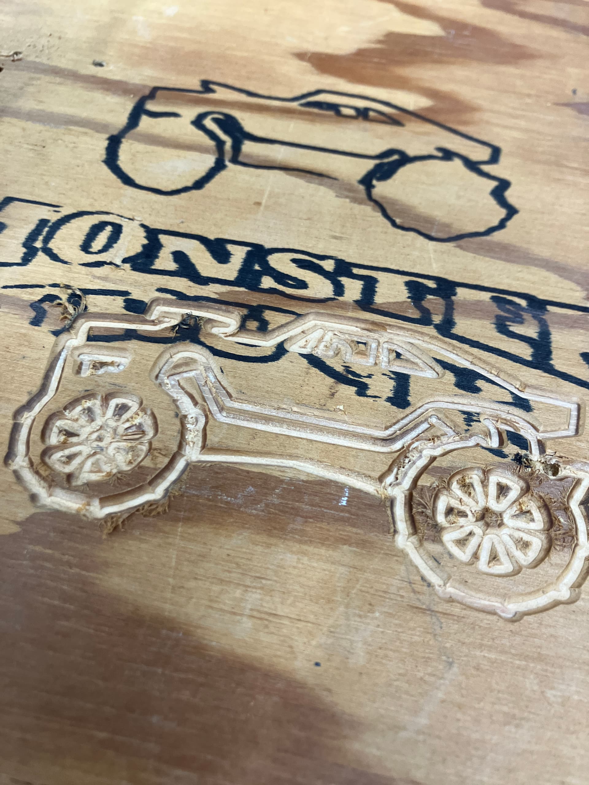

The other day I was testing the machine with a sharpie taped to the core. I chose a svg of a monster truck to keep my 5 year old interested in the process. After a couple successful sketches I said to myself “you know what…send it”. So I slapped in my trim router (not intended to live in the machine I have one with ER-11 collet coming today) and a crappy random v bit from a giant pack of generic router bits someone gave me once and ran the same gcode as I did with the sharpie and it turned out just fine!

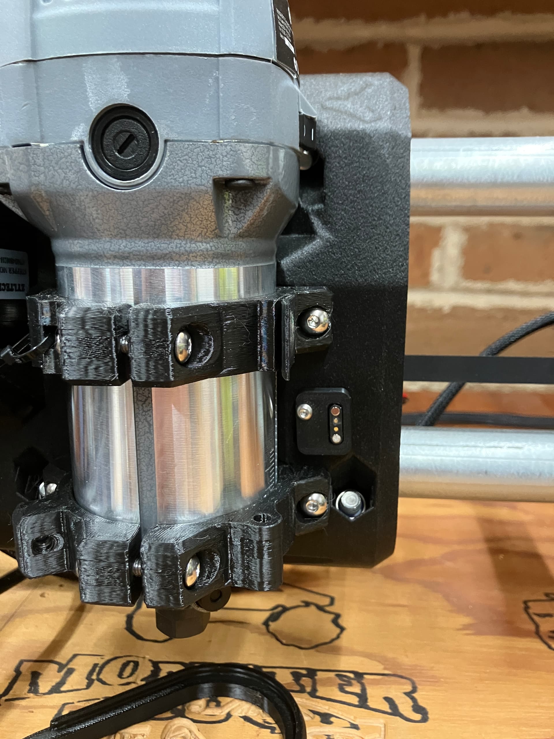

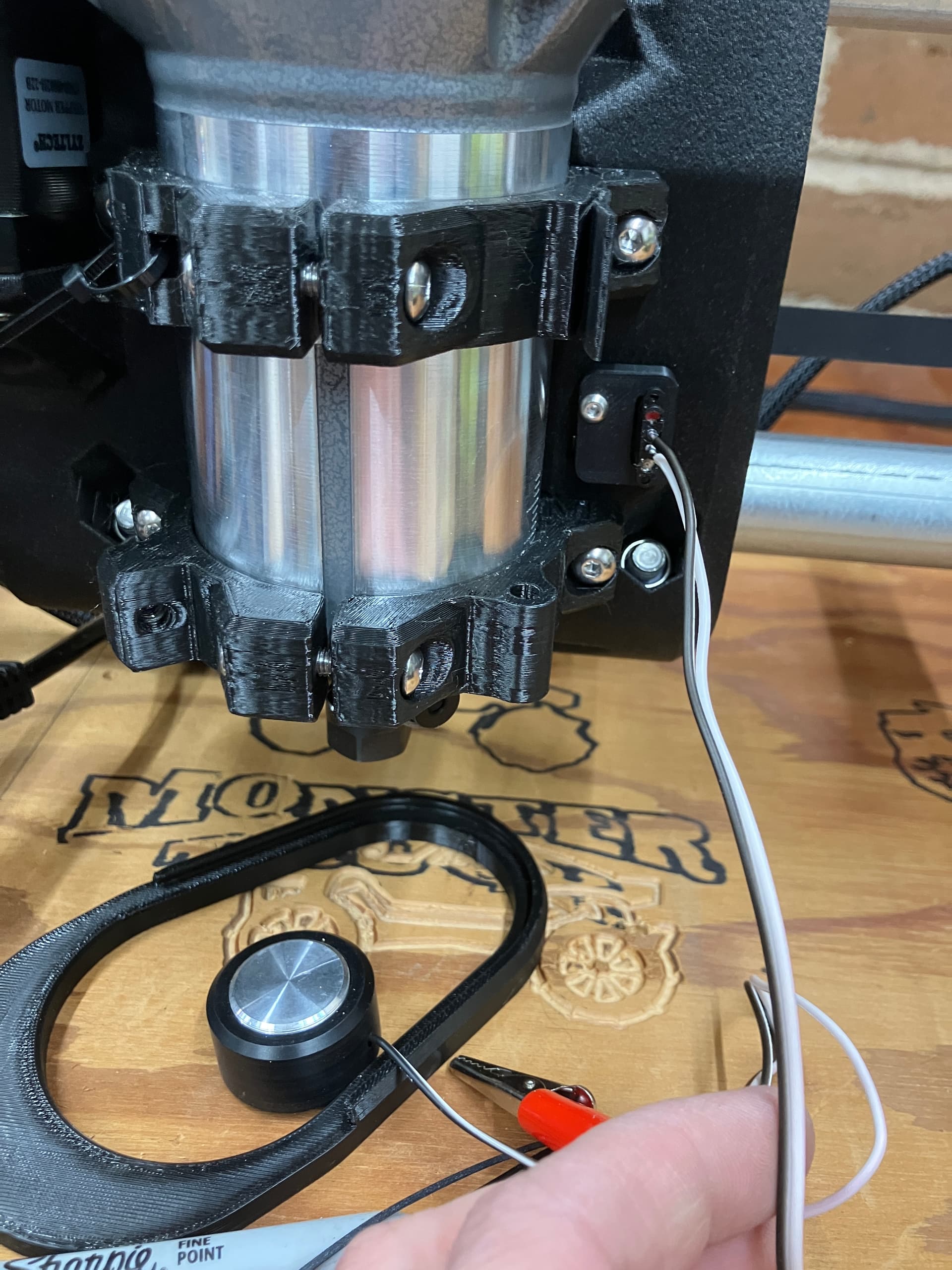

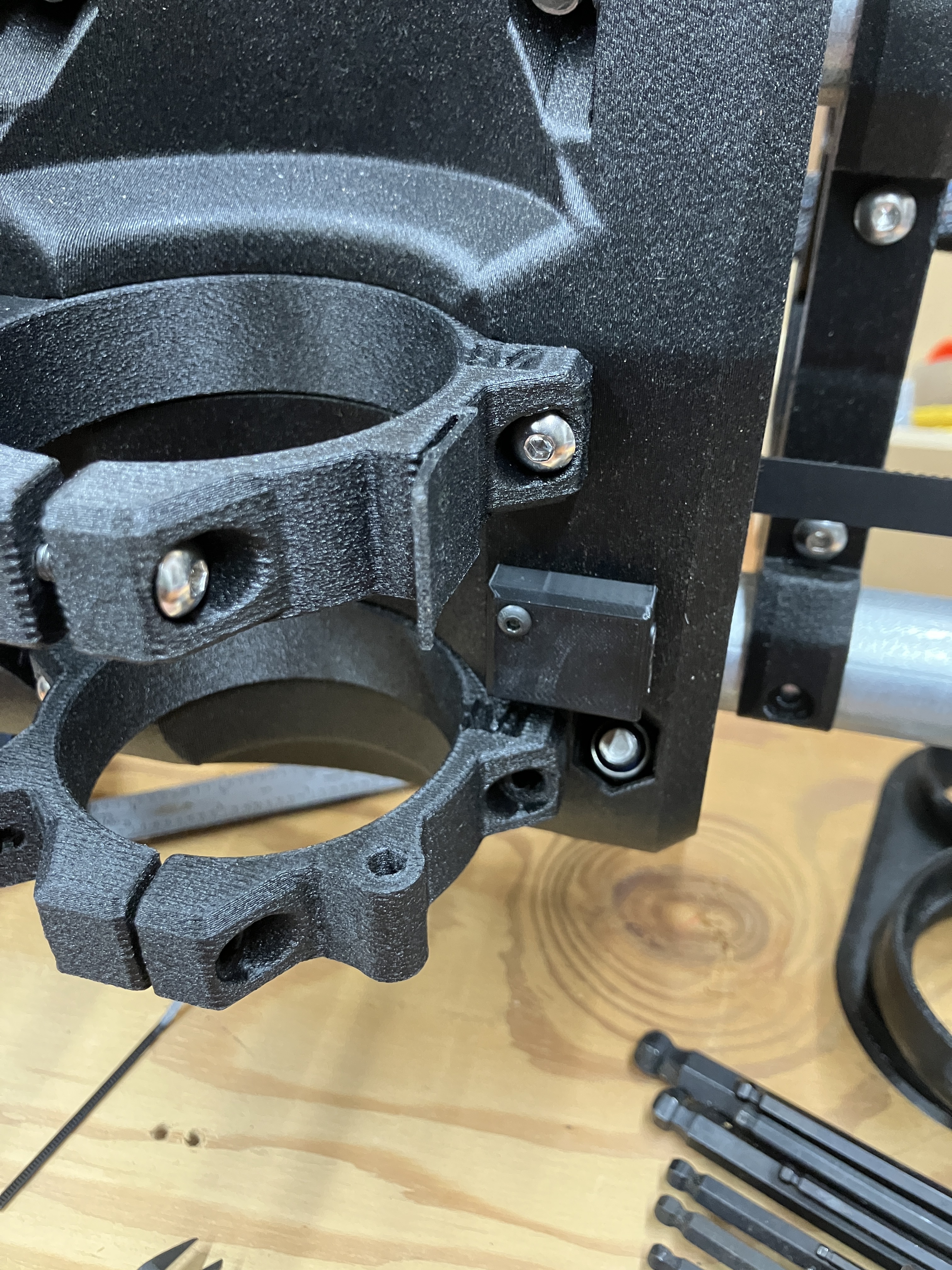

Printed out a quick mount for a magnetic pogo connector for my touch plate. Pretty happy with how it turned out but I’ve got a couple tweaks I might add.
Congrats on all the progress!

I freaking love it! That is exactly why I added the screw hole there!! I need to get a bunch of those connectors for the shop.

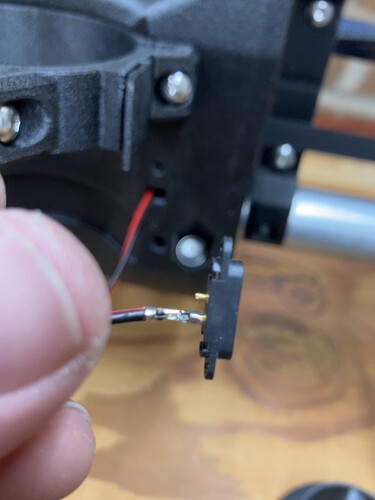

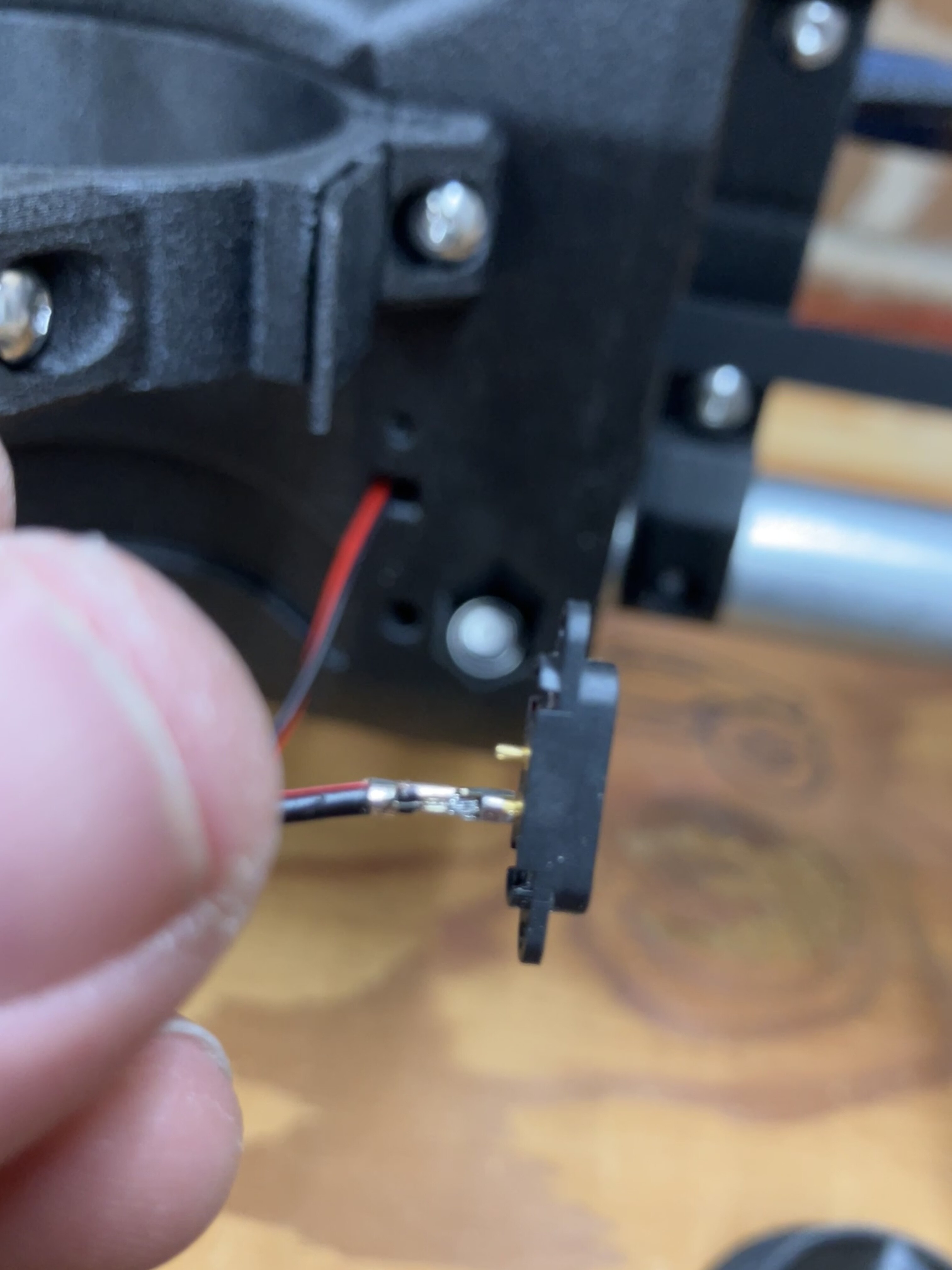

Get ones with pig tails! Soldering to the tiny pins was a real pain!

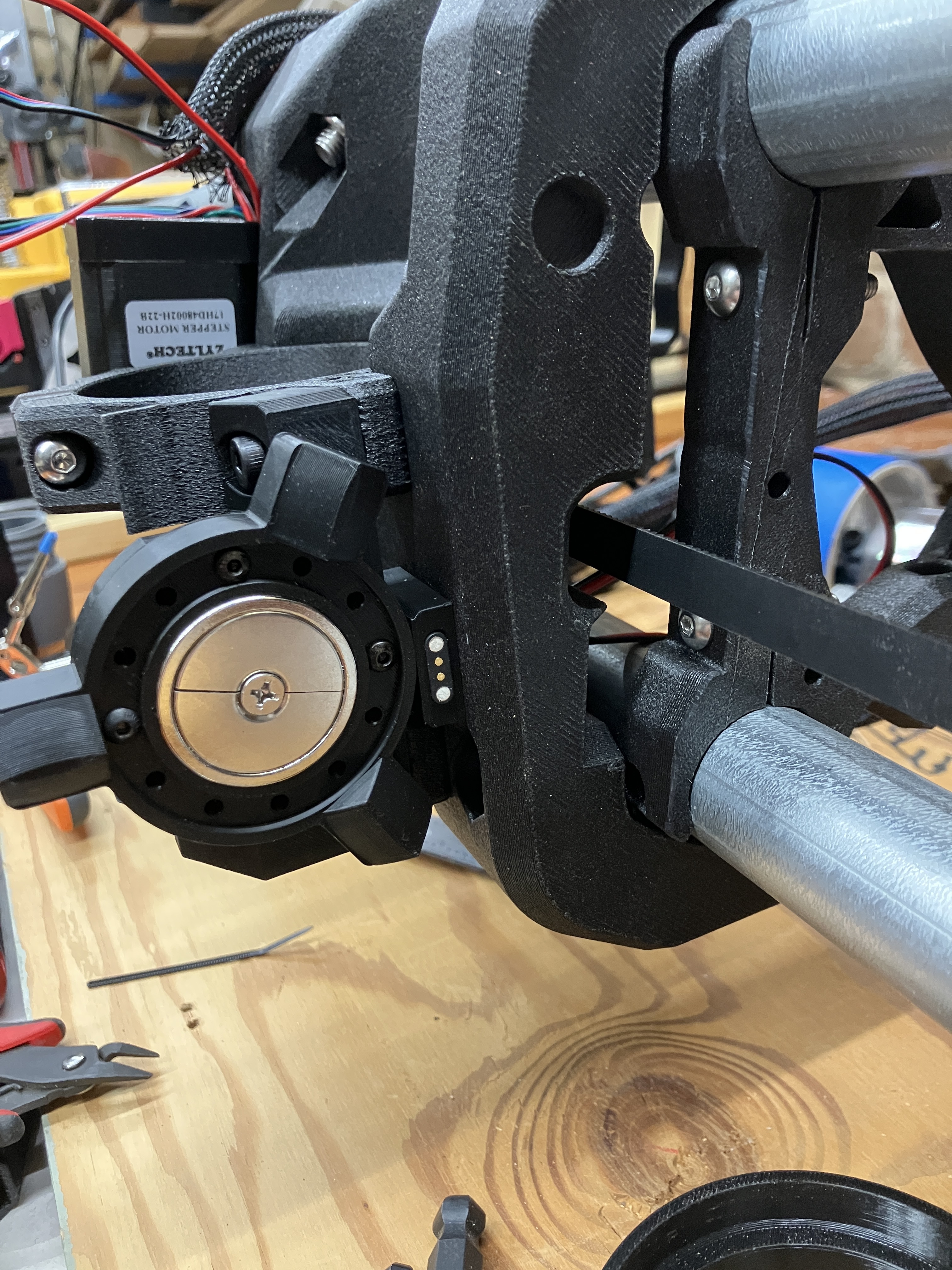

I’m currently reworking the mount to come out to the side to work with Doug’s kinematic mount. Once I’ve tested that one I’ll upload both styles to printables.
I made a new mount for my touch plate connector that comes out of the side so I can use Doug’s tool mount.
I found what seems to be a good way to solder the tiny pins of the pogo connectors I have. I took a female DuPont connector and cut off about 1mm at the front. After crimping the modified connector I held it onto the pin and soldered it which seemed to work well.
That’s awesome. Looking sharp.

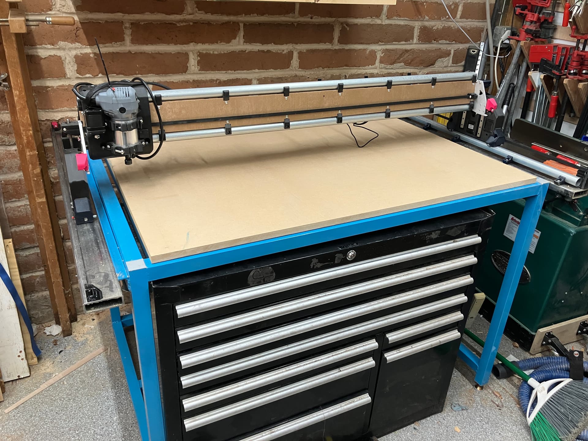

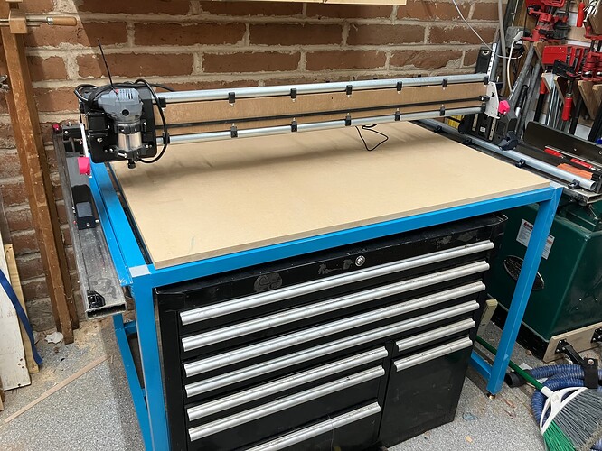

I think I can call the build officially finished. I got sick of the rickety dining table I was using and decided to weld together a steel one. The great thing about welding is I can order all the parts pre-cut from my local supplier and weld a custom table up in about 2 1/2 hours. This one cost me about $120 to throw together.
Oh and it doesn’t show up well in the picture but I decided to paint my strut plates with whatever spray paint happened to have on hand so they’re sparkly gold!

That is an awesome table. I have never developed any welding skills, but it looks sturdy without taking up too much space. I also love the pogo connection for the touchplate! I just purchased a few to try something similar. Have you shared the printed bracket?
