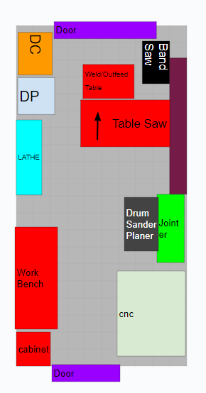

Here’s a drawing of my current shop layout. The grid is one foot square.
The layout works pretty well. I definitely have to play tetris when I want to use the jointer or planer on anything longer than a couple feet but that’s fine in a shop my size. I’ve found that the countertop space on the right just collects junk and is rarely useful. I’ve decided to tear out most of it and the lower cabinets in order to make room for a cnc machine. I’ll be leaving a small 2’x2’ section because my 3d printer is happily housed in the cabinet below and it can be my dedicated electronics surface.

The Plan
I’m currently planning to build an LR4 with a usable area of 3’x, 4’y. I’m waffling quite a bit and debating this. The largest project I anticipate doing is some kitchen cabinets and I would be able to fit two sides in that space. But I’m debating making the x gantry 4’ so that I could more easily expand the y to 8 feet and do a full sheet of plywood if I wanted to in the future. I’d probably prefer the stiffness of a 3’x over the larger volume. I’d be glad for any input anyone has on sizing.
Here’s a diagram of the changes I plan to make.
I’ve already torn out the countertop/cabinet and moved my tools to their new spaces and left the things that had been stored in the cabinets where the cnc will live since they will have to be stored under the table. And all in all I think I like the layout better than what I had before.

Yeah, I built it to be 3/4" shorter than the table saw so it’s flush when I put a piece of mdf on it. To weld I take that off and roll it out the doors.
