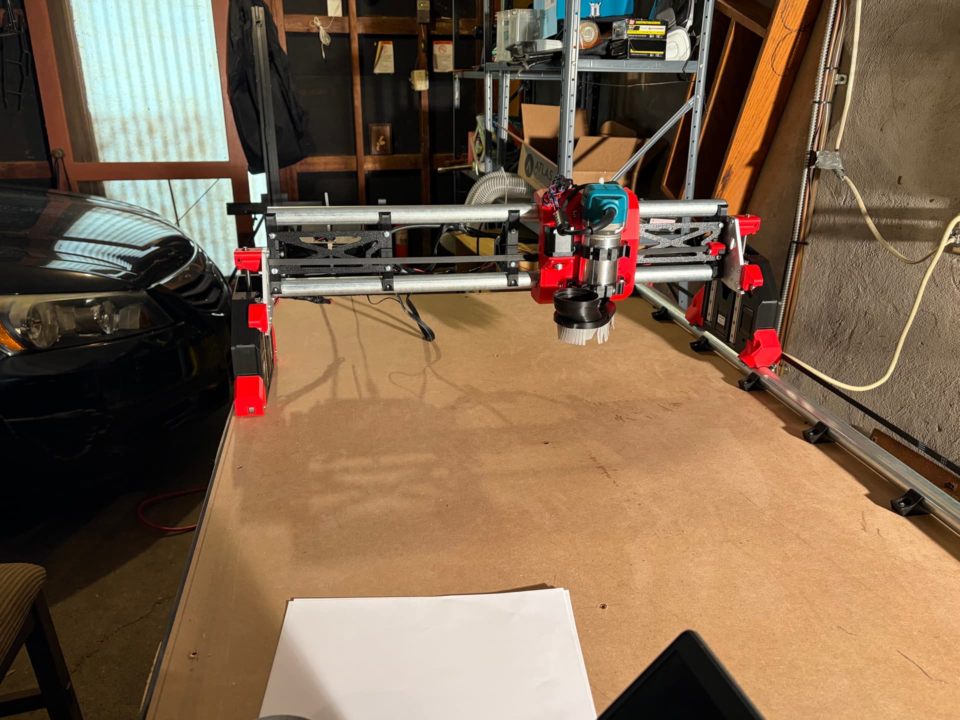

Hello, I’m attempting to build an LR4 as a complete newb. I should have been more involved here early on but a little worried my questions were going to be too stupid. Super proud to have gotten to the point I have (trying to calibrate), but I’m at an important point and don’t want to screw it up. Firstly I’ve read through the Thailand build and I struggled at a lot of the same spots, and dumber ones. Forgive me for probably using all the terms wrong

My main issue is that I followed the instructions, which seemed to put the X-stop on the core on the Right side (if the tool mount is facing away from me), and the instructions had me build YZ ends that put the rail on the left side of the table. So if I understand correctly, if I don’t move anything, I’d have to X-home to the right side (non-rail). Is that okay? Or should I do something like move the X-stop to the other side?

I think, just to be clear, you should post some pictures of your build.
Words like left/right will get confusing and having a picture to see the exact state you are in will stop from accidental bad advice being given.
From the docs though, you can see the example
Standing at the end of the table with the router facing you, rail on the right.
Endstops and homing should happen on the left, non-rail side for X. Y Homing should happen at the front, router-side.
Is your build different than this?
If you build directly and exactly from the calculator, it assumes they are at the edge, like in the above picture
Thank you Mike. I will post a pic soon, but thankfully I think I’m good since my machine is built to home on the non-rail side. I’ll admit I talked to AIChat throughout this, and they just really wanted to insist that homing needed to happen on the rail side, and that I should rip the endstop off and superglue it to the other side to make it happen if needed.
So from this perspective, home should be in the front, left, top of the z-range? And then X+ jog should move right, Y+ jog should move away, and Z+ jog should move down? So home is (0,0,0)
Z- will jog down. Everything else you are correct on

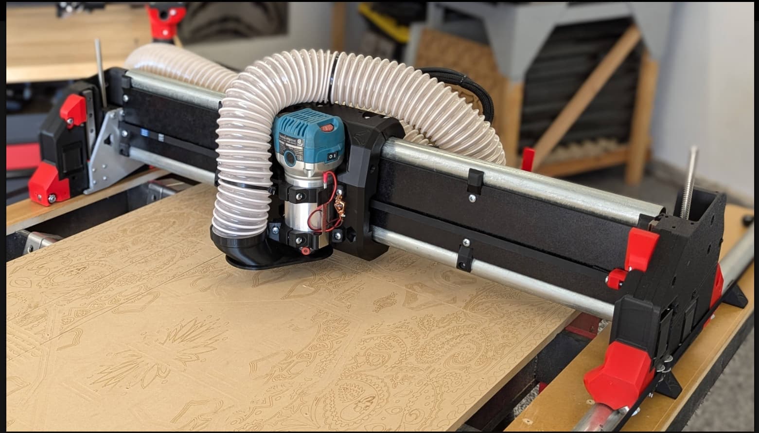

So one more question, you can maybe see i sized this for a 24x36 in cutting area. I tried to test the motion with a 2.5 vac hose attached to the gantry and just couldn’t make any progress. Is that too short a gantry to make that style work? Do I need to come in from the ceiling or just work harder on attaching to the gantry?
Don’t be ashamed, let us help you. We love getting people through build and use of these machines.
Welcome aboard! I had that excited feeling when I first powered my Lowrider up as well.
I have my dust hose coming from the ceiling with a boom arm. My cutting area is 1225 X 2570. I’m sure with the cutting area you have you could just attach one to the ceiling centered above your cutting area.
