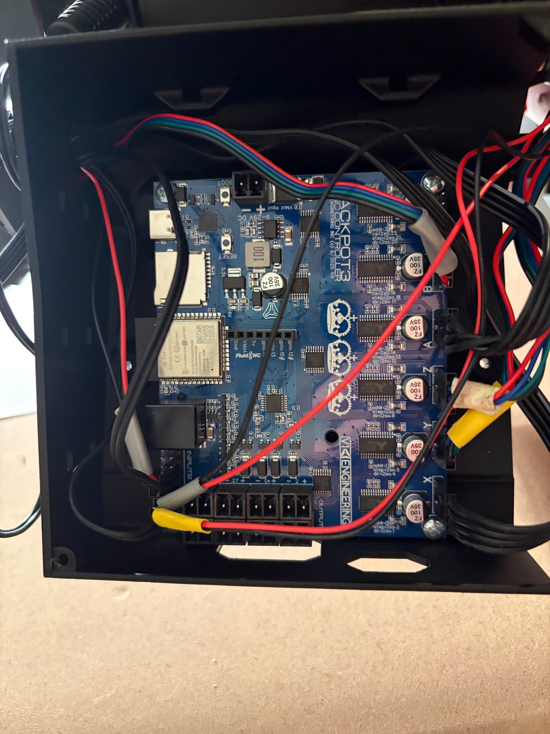

I’ve never used an SD card, and never wired anything before, so I know the wiring is messy. I will probably redo the whole thing if I can get the permanent strut plate cut. Lmk if this is not a good enough pic. Maybe it is the wrong box?
Your using the JP1 box with a JP3 board. You need to print the box for the JP3 and it will all line up much better and be a ton easier to use.

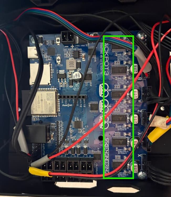

Also don’t forget to put the heat sinks on the drivers
Thanks so much Jonathan, I had always thought the holes in the box couldn’t be right. I don’t know what heat sinks on the drivers means, did I miss that step?
You should have gotten a little bag with the wire plugs for the board and 6 black aluminum heat sinks with tape on the bottom. The tape has a blue cover on it. You peal that blue off and then stick them on top of each of the 6 drivers.
Easy enough, I wondered what those were for, thank you so much.

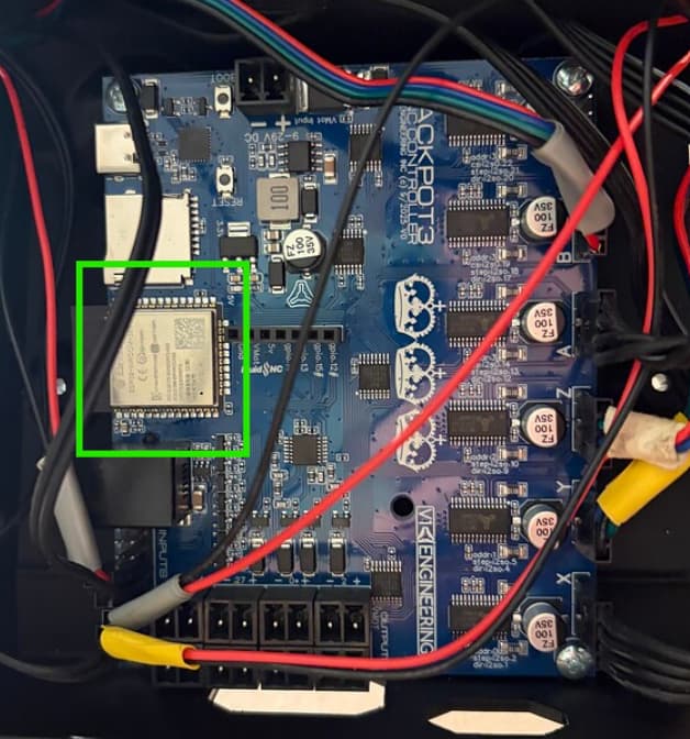

When you get your new box printed and you clean up your wires, make sure no wires go on top of this part here. If they do it can mess up your WIFI connection
After you print the new box the board will be turned 90° and that will be at the bottom and much easier to avoid but wanted to mention it anyways.
