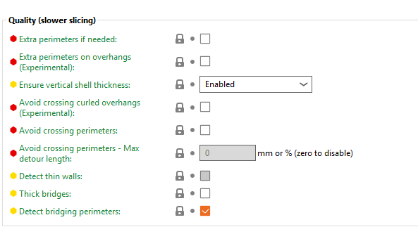

Things are getting more curious - it’s enabled by default! But I’m glad others are on the same page!
Really? I’ve never touched those settings… Maybe I should reset all of them.
Maybe it’s turned off by default for 0.6 nozzle?
It’s turned off for all the profiles and the lock indicates that it is the default for all of them not having it enabled. Maybe they did that because it could create errors?

Man, the stupid printer did it again with a file that worked two times before… at another location, just to make it more exciting. The nozzle snags on very small protrusions that form when printing the overhangs for the holes. Really, really frustrating. Had two prints fail at the very bottom hole and now one for the very top hole again.
I am now trying a different printer profile that adds two hours of print time… I also have the oldest profile that used to work, maybe I should get that out again…
Try slowing down your rapids a little. That should gain a lot of torque during moves.
I tweaked the settings and went down to 0.32mm, maybe that helps. Takes longer to print, but should not be a problem.
I still didn’t try my old profile that I had used before the new features were introduced. I printed at least 8 cores without any problems with it. Going to do that after this one has printed, need to send a kit out to Italy after the weekend. :slightly_smiling_face:
Update: It works without issues with 0.32 because there is less curling.
It also works with the old profile (that I had used before to print 8 cores or so). So the changes Prusa made to the slicer to have the nicer finish with Balanced and Speed profiles mess something up that makes some of the edges curl more. Probably… -_-
