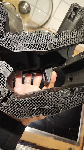

Well, I don’t know how that happened… Wtf. There’s nothing where it could have caught…
The overhang of that upper bolt hole.
Should be fine though. If the part fans are on full blast might want to look at extrusion temp a little closer.
Oh yeah, interesting. Prusa changed their strategy of printing to reduce the visual artifacts, so the outer layer is always printed at max speed to ensure that it always looks good. Might lead to warping. Good catch, thanks. Will see how that goes this time. :slight_smile:

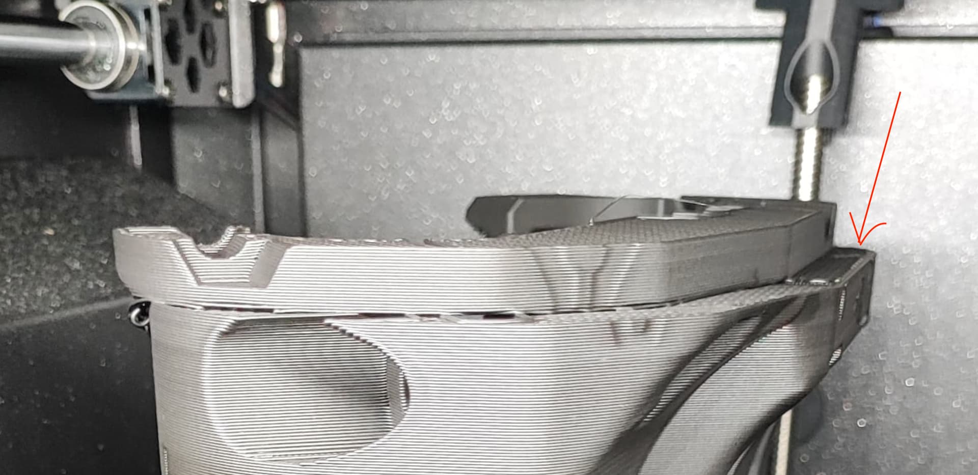

It failed at the exact same spot, it was definitely not the Core’s fault but looks like a slicing error. F…
100% the same shift, that was not a collision… I should have listened to my gut and sliced it again… :sob:

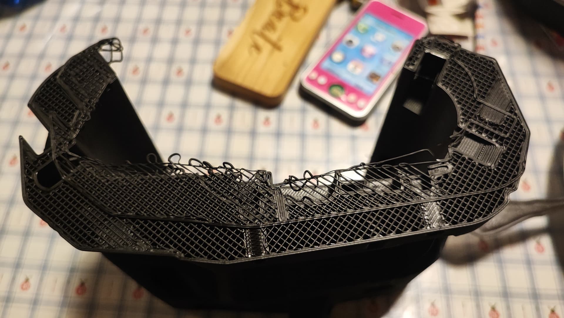

These were also the first two tries after having sliced them after the new update of the Slicer, so it was a completely new file that might have been messed up. I had this happen once before.
I had that problem. at the time I was using PrusaSlicer for the TAZ, lately it’s been Orca…

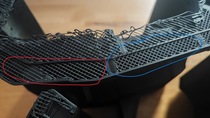

I just re-sliced it again, this time I moved it around on the printbed. I can pinpoint the layer when it happens, it’s one layer before it’s supposed to print the bridging over the hole. Still, there is no binding or anything, the last time I caught it directly after it happened, this time I am going to film it (if I don’t miss it…).
For all three it has completed the infill for the bottom part (blue), but fails on the infill for the top part (red). So it fails doing infill. I really don’t get it.

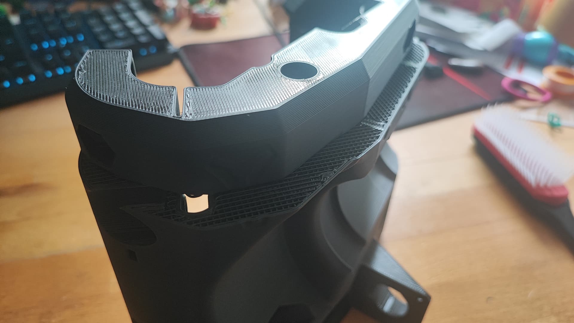

It’s not dragging on anything, the file looks fine. Regrettably there aren’t other gcode viewers that read bgcode and Notepad does not want to open it because it’s so large.
I have the theory that it fails at a certain height, but that means a) printing another core (which I am doing at the moment) or b) printing another large object and see whether that happens as well.
So two theories: mechanical problem or Slicer bug.

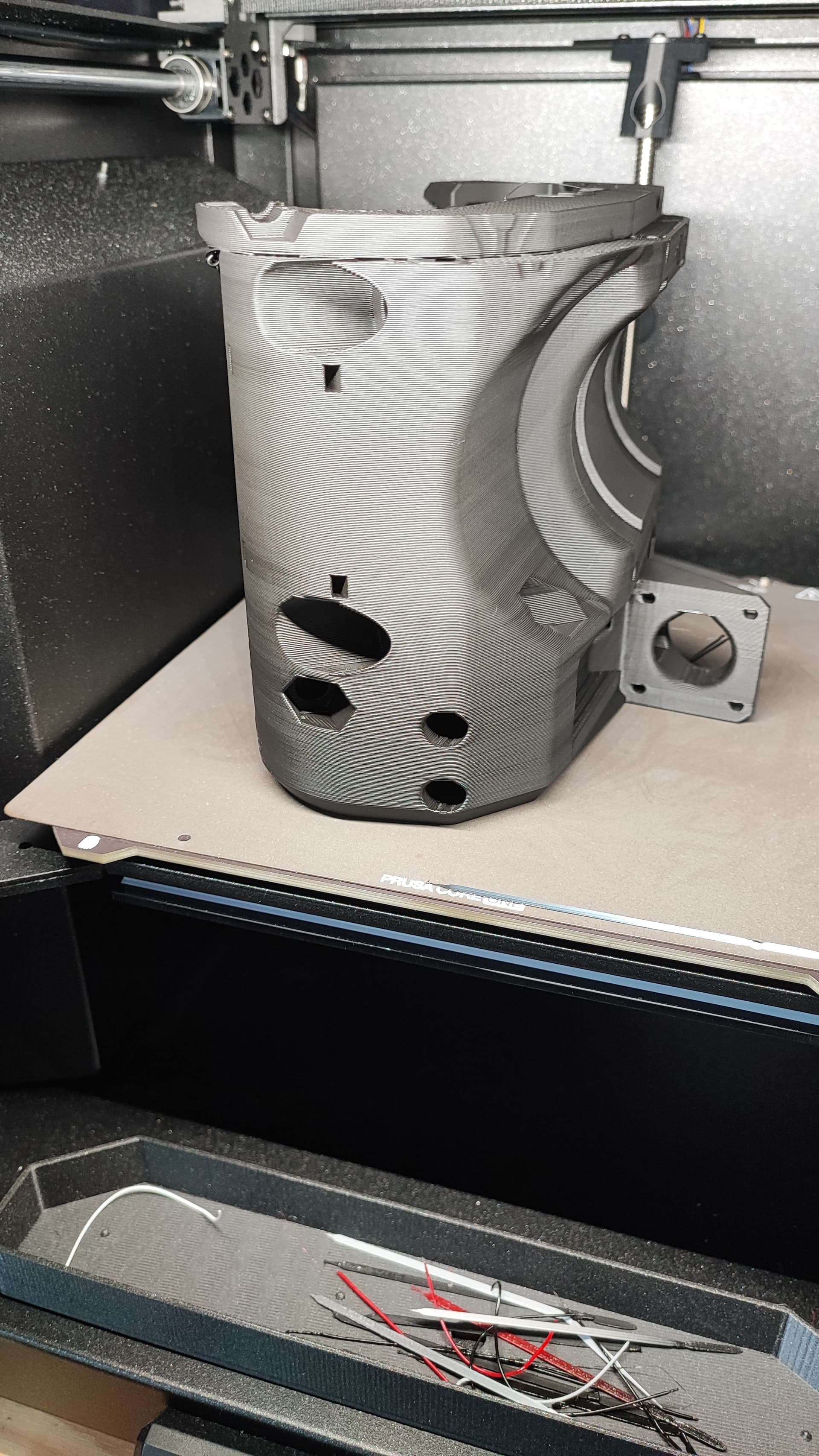

It’s pretty weird, have you printed things of this height before on this machine? Is it something a simple tall tower can reproduce or is it just this model?
I’m wondering if there’s a jump in one of the Z screws, a burr or just enough of a catch to throw off the layer. Have you lubed 'em? Curiously the early instructions had detailed instructions to do that including a printed gadget, but they’ve disappeared. Presumably that was a cut an paste from the XL that wasn’t picked up - the current maintenance knowledge base doesn’t mention anything.
