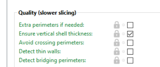

So the belt slides are having random print issues in Prusa slicer and cura so far. Some people are having the belt slot too wide and not locking the belt (~1.5mm too wide). Switch to a different slicer and the part is fine.
There are success and failures in both.
So can anyone think of a setting that might be causing this. I dug through prusa slicer and this is the only thing that has caught my eye so far.
I can try to print a few with different settings but I think crowdsourcing this might find it faster than me randomly changing settings.
If you have a fail or a success in either slicer maybe take a quick look through and see what you have changed from default settings?

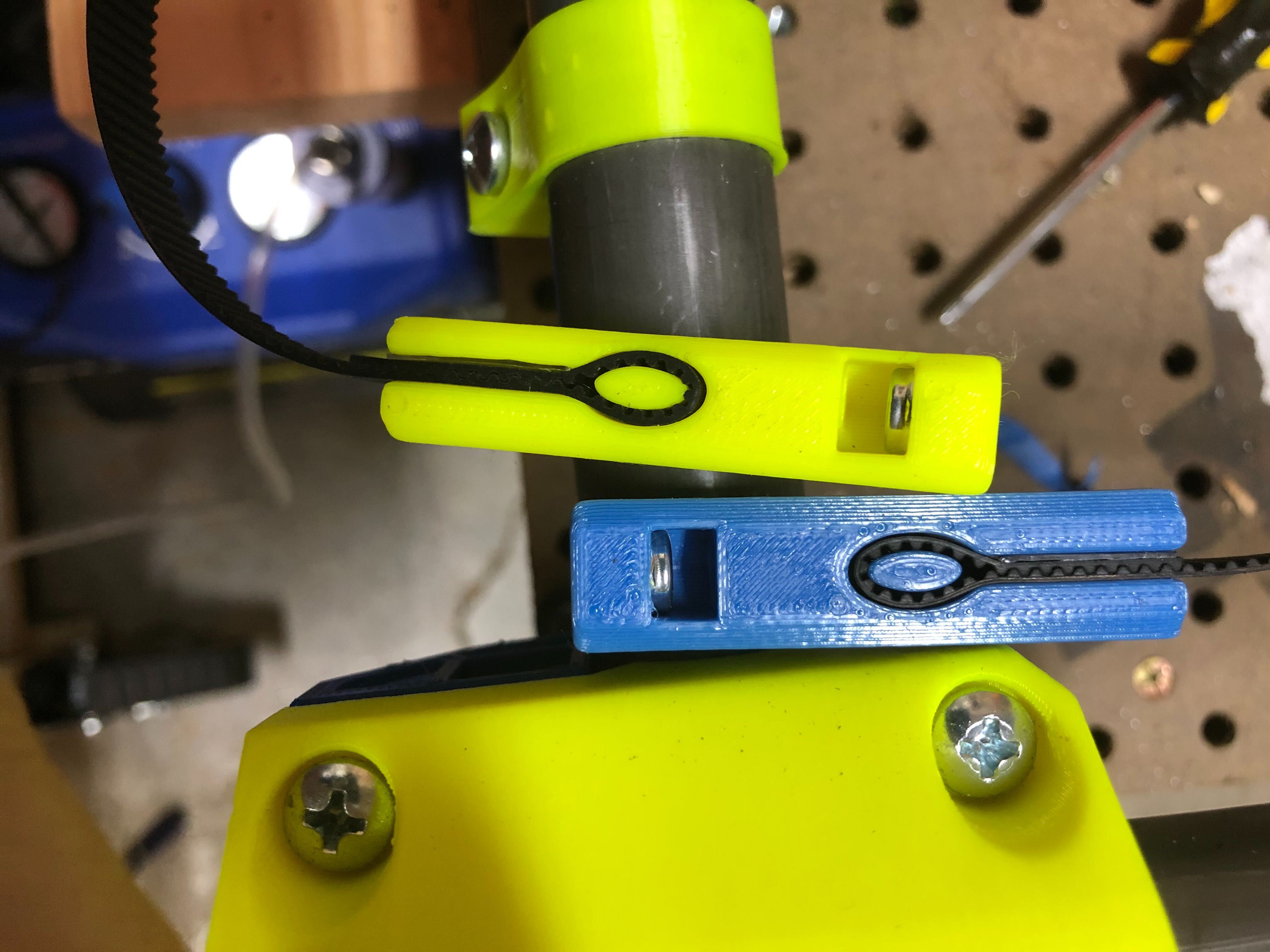

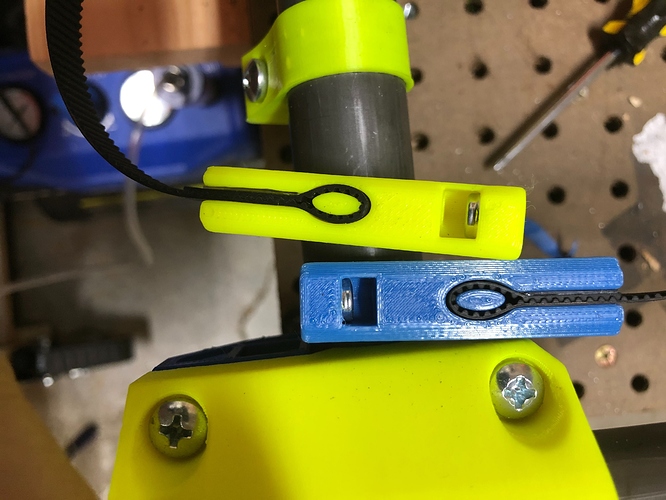

Can you post a picture of the belt holder? It might be a combination of multiple factors besides just slicing.
nellson
(Nick Ellson)
July 24, 2020, 4:02pm
10
Here is one of each. Using the plastic blister shield of a pair of pliers package to wedge into the slot works like a charm. The Yellow was a tad tighter than the blue.
