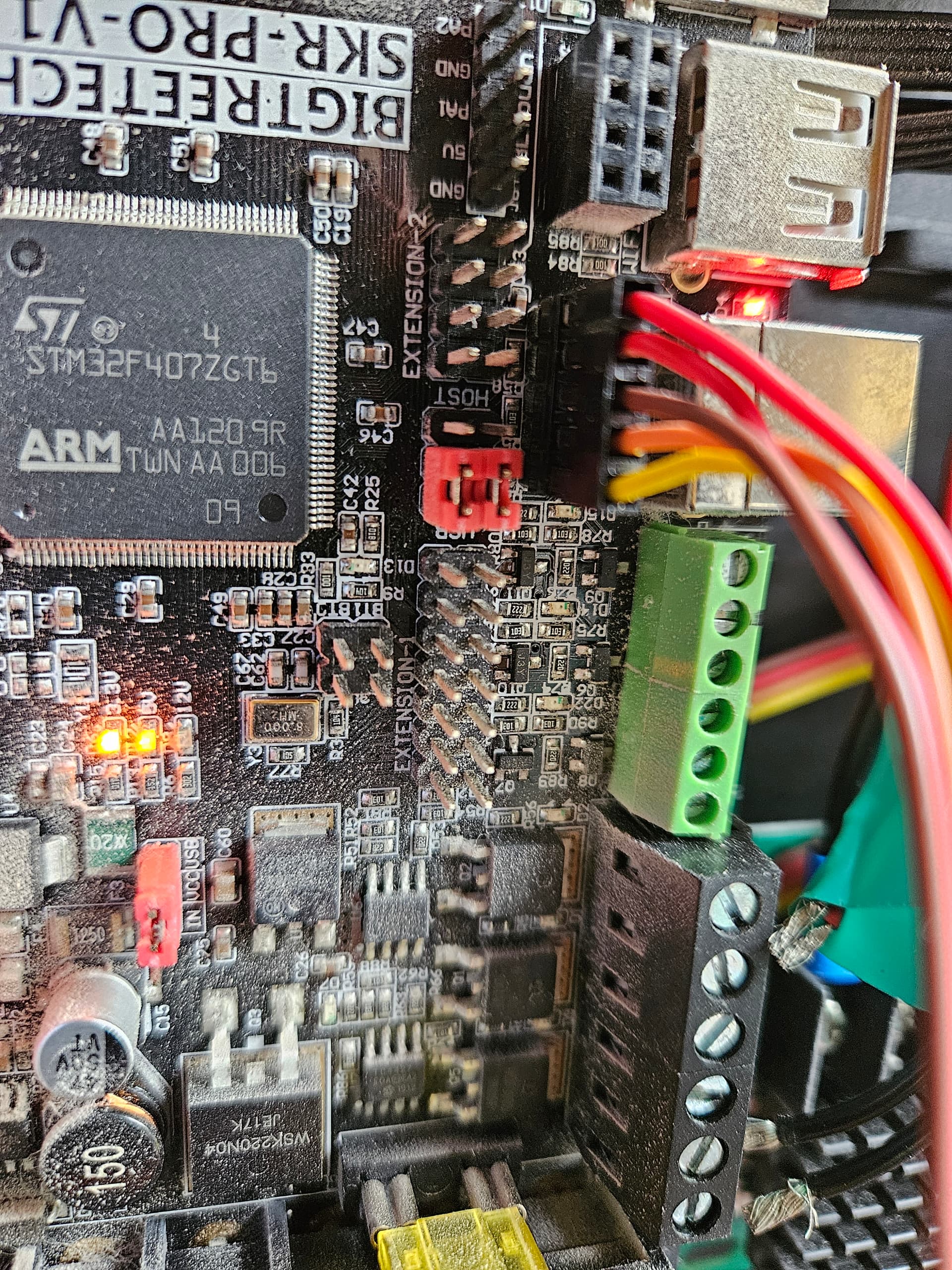

Edit to add: Since you previously tried to flash a bootloader, you might want to double check that you returned all the jumpers on your SKR board to the proper position afterwards. Failing to do so would also leave you in a no-boot scenario.
That’s one reason I suggested you share a picture of your setup in the replies up above.

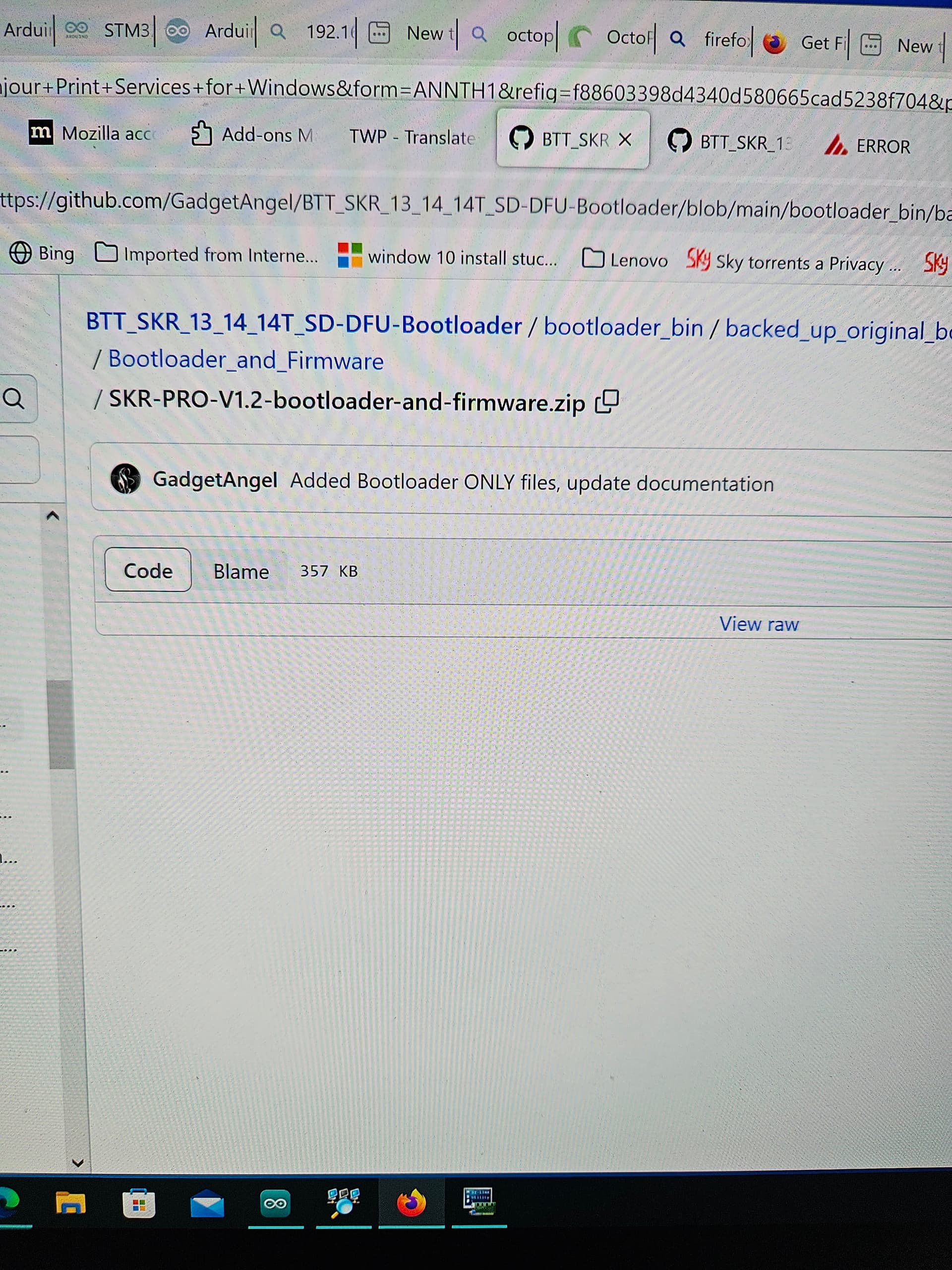

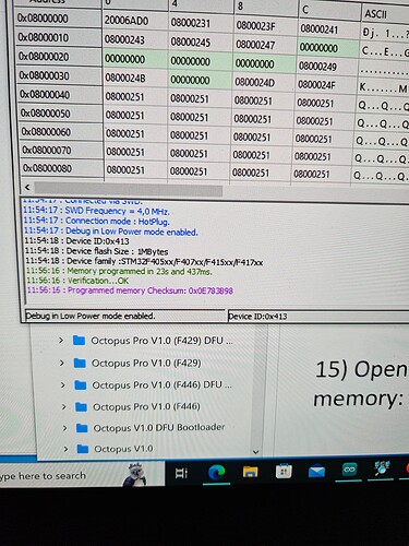

I had another go with the STM32 St link utility and flashed the firmware and bootloader to the SKR board as shown:-
I got the firmware and bootloader from this website well rather GitHub as shown:-
But still no connection with Octoprint!
I have now got the Mobo to accept the Firmware.bin file via sd card.
but, still no joy in either Octoprint or the screen yet!
That’s a good start. It’s still possible there’s something wrong with Marlin- where did you download Marlin from?

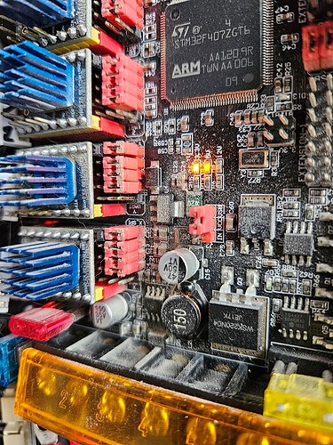

This is what I’m getting now
Still no sign of life from Marlin. Those dmesg entries are the tail end of your last boot, then nothing.
You could try a different USB cable, or plug in some other USB device into the Pi (To prove your USB cable/port is working correctly).

One more thing to check: On the SKR, there is a jumper that sets whether the microcontroller gets power from USB or from the board power.
When installed in the printer, you need that jumper to be in the position where it gets power from the printer, or things won’t work. Let’s double check that.
It also wouldn’t hurt to grab some compressed air and blow that board off thouroughly.
