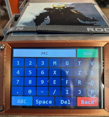

Have the MPCNC Primo running SKR Pro V1.2 with Marlin. Just added the NEJE 40640. I have been able to get the board talking to the laser and get a pulse to fire from the LCD screen, but I cannot get Lightburn to fire the laser. It connects and it will move the laser as if it is running the test file, but it doesn’t fire. It also doesn’t fire the laser when I hit the button test fire.
After reading the forums for wiring, I have a dedicated power supply for the laser, have the PWM board hooked up to the laser with the 4 wire cable and the two pin cable from that board hooked up to PC9 and ground
There are a couple of things to be aware of. First, there is a laser timeout to prevents the laser from continuing to fire if the laser is not moving. I believe in the latest V1 maintained version of Marlin, there is a bug in Marlin where the timeout does not play well with the laser menu. Marlin has fixed this bug, but V1 has not made a release version with the fix.
Second, starting with the latest V1 maintained version of Marlin, if you want to use inline commands (highly recommended), you need the following at the top of your laser file:
M3 I
If you have Lightburn setup for inline commands and the top of file does not have this command, the laser will not fire. This line can automatically be added to all Lightburn files by using the Start GCode section. If you haven’t already found it, inline commands are enabled in the following section:
This is on the Basic Settings page. Due to a bug in Lightburn, on some displays, you must resize the Basic Settings dialog to see this setting. Note that M03/M05 will work without the M3 I above, but the cut and engraving quality will not be as good as using inline commands.
Finally, if you just want to verify that your laser is working, you can use M42 to manipulate PC9 directly. This bypasses all laser-specific code. You can try with different S values in the range of 0 to 255 to make sure the laser varies in intensity.

I’m sorry if this is a stupid question, when you say use M42 do you mean from the Console tab of Lightburn?
Also, the laser timeout issue that you mentioned, would that be why I can fire the laser for 1/2 a second from the Marlin menu and then have to toggle it off and back on to get it to flash for another half second?
I’ve got Lightburn controlling my axes very nicely, but something is still amiss with laser control.
Anywhere you can set or run g-code will work with an M42. That includes the console line in Lightburn. I have the command in a couple of places for my machine, including a file on my SD card.
