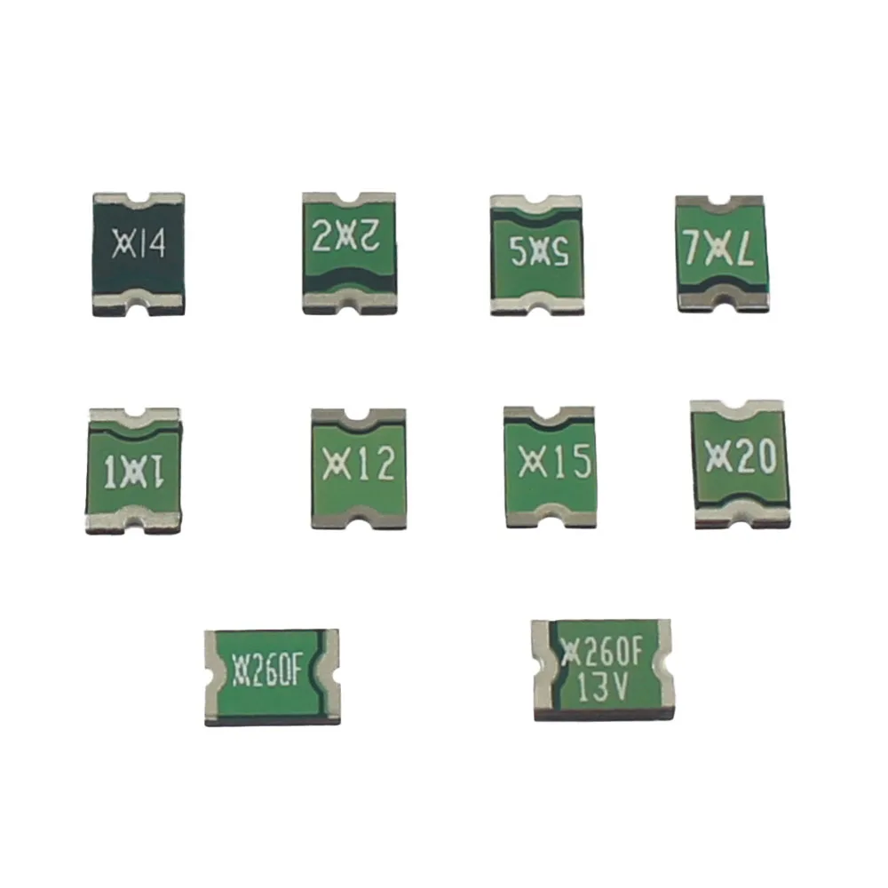

Knowing myself and given the price of these cards yes for sure I would try to repair them, at least I would try 2 simple things:
Replacing the 3.3v regulator because it only costs a few cents for one card.
The component is the U4, it is a AMS1117-3.3V :
But because it would cost nothing I would first look at the fuse as proposed by Robert(not Bob) :
For testing prupose you can short it and see if you get your 3.3V back, if it does i would then want to replace the F3 fuse(according to shematic, it’s the 0.75A one):
