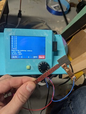

My MPCNC has the V1E touch plate. it’s been working fine, but all of a sudden, it just stopped triggering when it’s closed the circuit. I unplugged it from the board and tested with a multimeter - I have continuity from the touchplate to the pin in the plug and from the magnet in the copper clamp to its pin as well.
I replugged it and the issue persisted - when the magnet in the copper clamp (wired to ground) is on the bit of the router, and it touches the touch plate (wired to signal), the light on the SKR Pro which usually lights up when the touchplate is triggered does not light up. Z homing fails since it’s not ever seeing the circuit as completed.
I’ve unplugged/replugged, power cycled, even resoldered the touch plate to the signal wire, but the situation persists. Anyone know anything I can try?

I put back the last tool I used, which worked fine with the touch plate, and the issue persisted. I don’t even get the light on the board when I touch the clamp to the touch plate directly.
Could be surface corrosion providing a bit of insulation/resistance. Give both a rub with wire wool and/or wipe with acetone and try again.
When you touch the clamp directly to the plate does it trigger?
What do you get if you jumper the probe GPIO pin on the SKR to ground?
Does the LED change state?
I’m not sure if you meant for me to put the jumper here, but doing so did not change the state of the board - the Z0 LED still does not light up and the Z homing still fails to trigger.
That’s acting like a blown GPIO. If you temporarily hook up the touch plate to an endstop location and then touch the plate to the probe ground, does it then light up?
Well that’s not good.
If I move the touch plate plug from E1 to Y (immediately to the left of where it’s always been) and move Y to E1, both the touchplate and endstop trigger normally without incident. If I return Y to its original location and move the touchplate to E2, and touch the touchplate with the copper clamp, E2 seems to function without issue. Granted, it’s operating as NC - the light on the SKR stays on and goes off when the touchplate is triggered.

Let’s see what M119 says, for four test configurations:
  • The original setup, with the probe open
  • The original setup, with the probe touching (circuit complete)
  • The swapped setup, with the probe open
  • The swapped setup, with the probe touching.
Report the full M119 results for all four cases

Original setup, probe open:
Original setup, probe touching itself:
Touchplate probe in Y-/T2 plug, Y1 endstop in Z-/T3 plug (literally swapped their positions), probe open:
Touchplate probe in Y-/T2, Y1 endstop in Z-/T3 plug, probe touching itself:
When you have the swapped setup, if you toggle the Y1 endstop by hand, does M119 show a change in the Z_min?
There’s a small chance that this is a manifestation of a problem that SKRs get where they have a wacky LED pull up circuit. These can sometimes work for a while then get flaky.
The last possible steps to troubleshoot this would be to try making a pigtail to modify the pullup circuit, or moving the probe pin to another location on the board and rebuilding the firmware for that different GPIO.
It does look to me like a board issue, possibly the pigtail can work around it and possibly a firmware change to move to a different GPIO are the last options I see.
No change in z_min when the Y1 endstop is triggered, but when Y1 is triggered, it shows Y_MIN as triggered. Which is weird because Y1 is still in the Z- plug.
The E2 plug is open, i could just move the touchplate to that and rebuild the firmware to use that. At least that way I don’t have to physically risk the board by soldering a pigtail. Is there maybe a guide for flashing the firmware somewhere?

I copied the compiled elf file to a microSD, put it in the microSD slot on the SKR, put the touchplate in the E2 plug, and booted. Now it lights the E2 light whenever the touchplate is open and the light goes off when it is closed.
It still doesn’t trigger a Z stop - if I move Z up a few cm, then run Home Z, then touch the touchplate to the clamp, the light goes off but the tool keeps moving.
M119 shows all endstops as open when I run it either with or without the touchplate triggered.
Anything further I should change or try?
