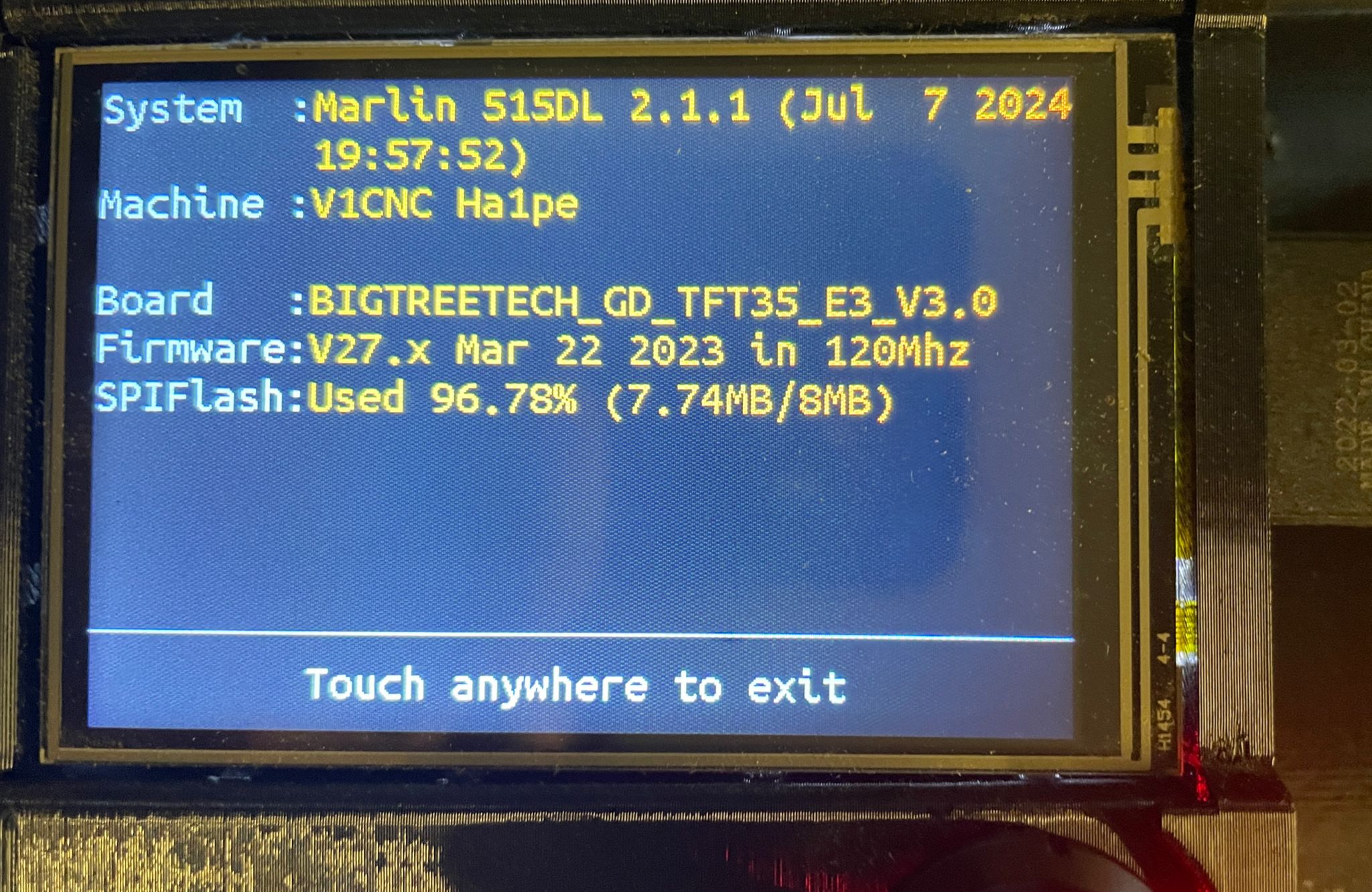

Hey! New user here, bought a used LR3 a few weeks ago and having a blast so far. I am having some weird problems intermittently and (after having done all mechanical and wiring-related things I could think of) wondering if there is a new firmware for the controller (and display).
It´s using a SKR PRO V1.2 with dual endstops, Firmware page in the TFT35 says:
System: Marlin 515DL 2.1.1 (Jul 7 2024)
Machine: V1CNC Ha1pe
Board: BIGTREETECH_GD_TFT35_E3_V3.0
Firmware: V27.x Mar 22 2023 in 120Mhz
I tried to get all informations I could and go from there, but I am somewhat confused. I have a few questions:
  1. Is it the most recent firmware there is for the SKR 1.2 Pro? Judging by the MarlinBuilder Repo in Github, 515 seems to be the most recent one, however I am unsure about the “Ha1pe” part
  2. Am i right that there is indeed a new firmware for the display, which is currently on 3.0 and newest one is 3.27? (BIGTREE_GD_TFT35_V3.0_E3.27.x.bin)
  3. Is there any way for me to check the current firmware and more importantly, the configured values?

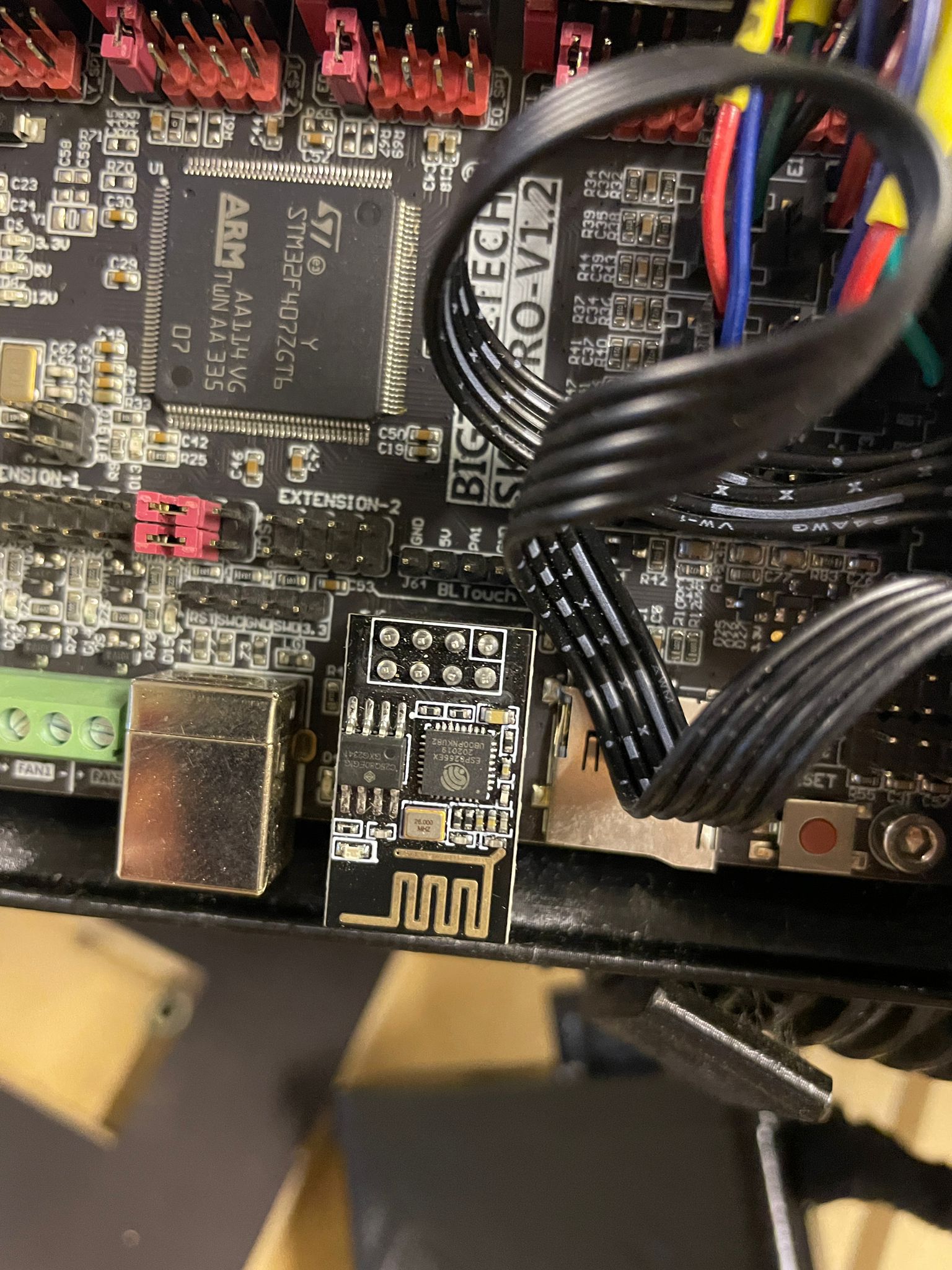

Let’s see pictures of your controller with the WiFi setup. Is it an ESP-01?

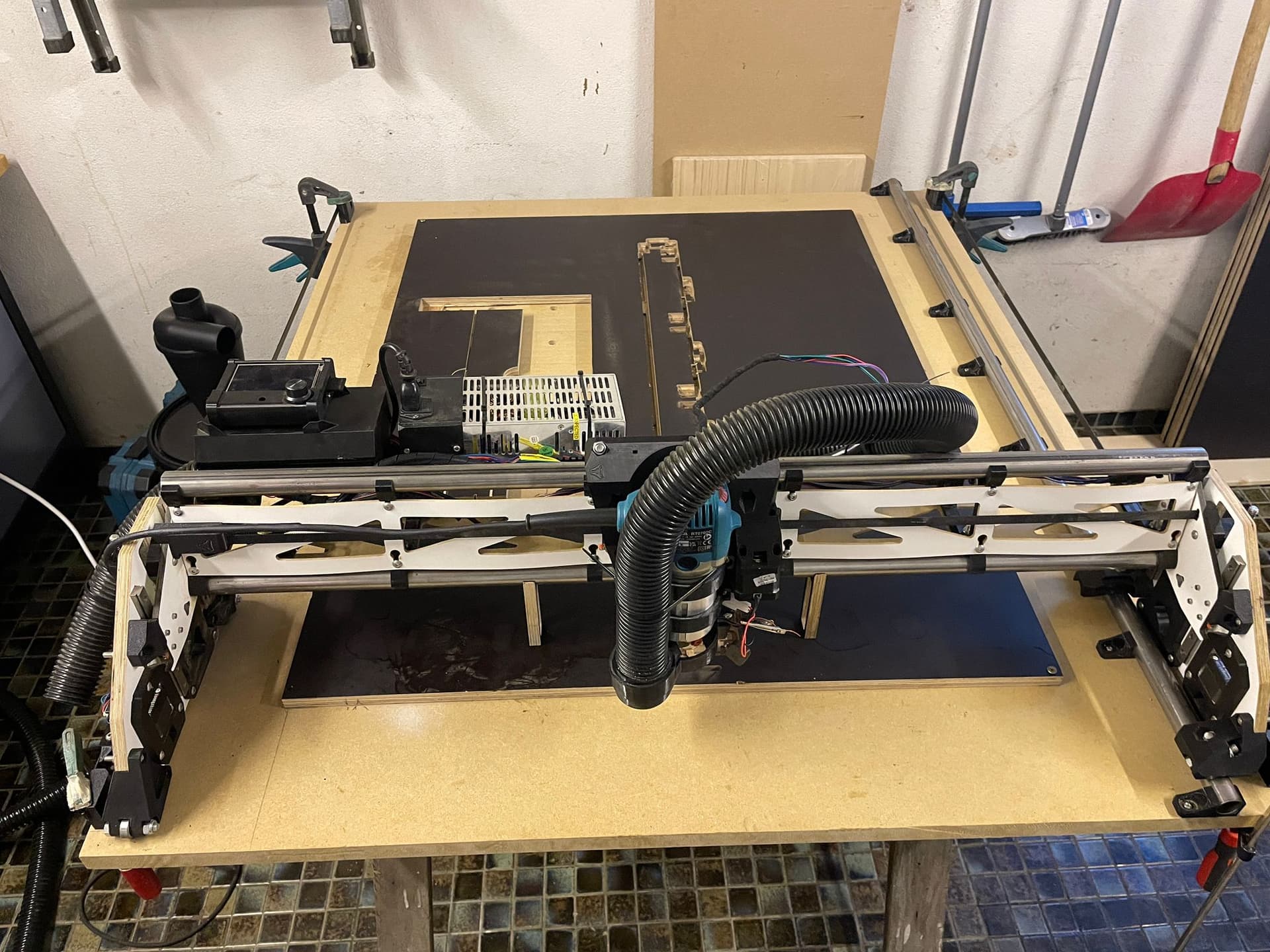

You should instead tell us more about your machine (pictures would be a great introduction), and most importantly the specific details about your “Weird problems.”

This is the machine:
and this the Wi-Fi board, which does seem to be the ESP-01:
With “weird problems” I mean:
  1. Sometime Homeing the Z axis spins the Z steppers in the wrong direction, e.g. into the spillboard. I can replicate this issue with the manual move buttons, but only sometimes. Rebooting the board fixes it, and I never had an issue like this running any gcode, where everything works fine
  2. Probing down the Z Axis is also intermittently producing an issue where it touches the probe, sits for a moment and then “falls” into the probe. I don´t know if thats because of steppers being powerless for a second or something else. It seems to have gotten better by modifying the Touch-Probe gcode from the “Milling basics” site, by plunging way slower to Z0 and adding a M400 after the G38.2. I re-did the Z-Endstop wiring from the Pins of the board to the Plate and clamp too, just to be sure.
Other than that I cleaned up all the moving parts, greased the leadscrews, tightened the belts, and verified squareness (there is probably more precision to be gained, but I don´t require it, neither do I believe it has to do with these issues) The machine is working nicely when it does, despite me still tuning my feed rates. I have had a few cases of missed steps on the X Axis, but most likely linked to high feed rates.

Yes, 515 is the correct firmware, but it looks like you may have the wrong version (“asset”)

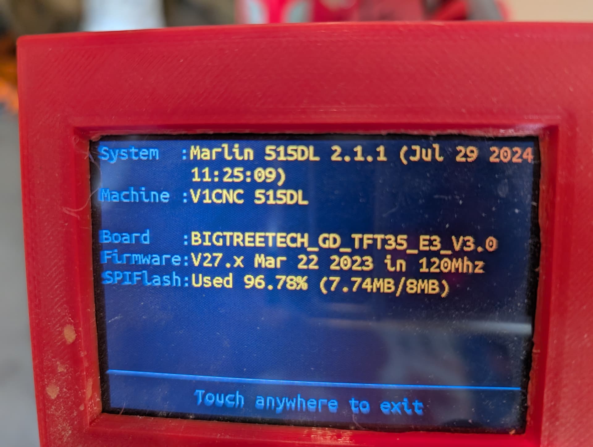

From the “Settings - Info” page on my machine:
(ignore the different date on the System firmware, I modified and recompiled mine)
On the link on the V1E Docs page , you need to click on the “Show all 37 Assets” button at the bottom of the 515 section. That will expand the available assets. From there, select the V1CNC_SkrPro_DualLR_2209-2.1.1.zip asset (note that there are many similarly named files - make sure it is SKR PRO and DUAL LR). Follow the instructions to load the .bin file using an SD card.
Note that the “board” is 3.0, while the firmware is v27.x Can you post a picture of your “Settings - Info” screen?
For the firmware, the Settings - Info screen shows everything. For the settings, you can use the Terminal screen to run a M503 command . Note that this shows what is in Volatile (SRAM) memory. To see the contents of EEPROM (non-volatile), issue a M501 command first, or simply reboot and then issue the M503 command.

This is what my settings page looks like:
Will definitely have a look at the current settings in both volatile and non-volatile memory and then re-flash the board firmware, just to get on the “official” latest firmware. There are no changes I need to make to any config file, right?
I also now understand the version naming of the display firmwares, thanks. So the display is actually on the newest version. :ok_hand:

If you’re only using the wifi interface, I would try using only the screen for a while and see if you still see it. The wifi is the least tested.
