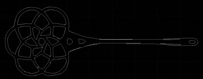

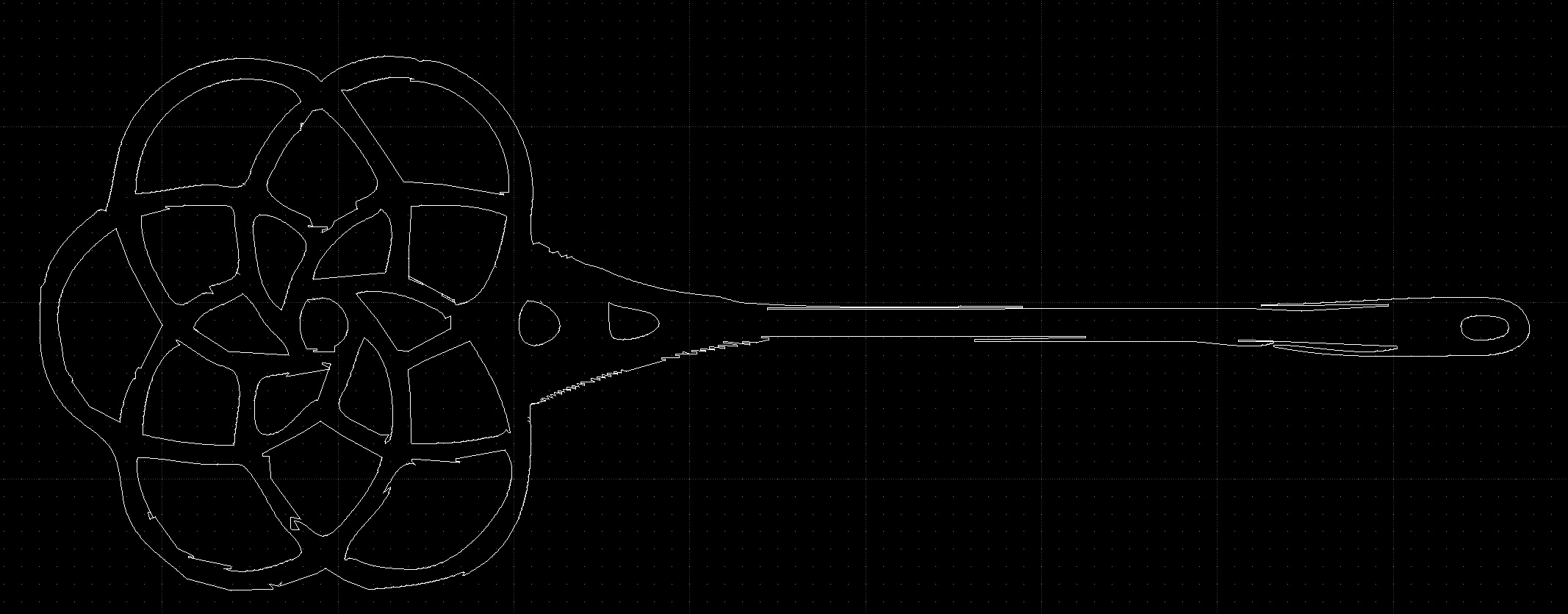

Tracing.dxf (323.7 KB)

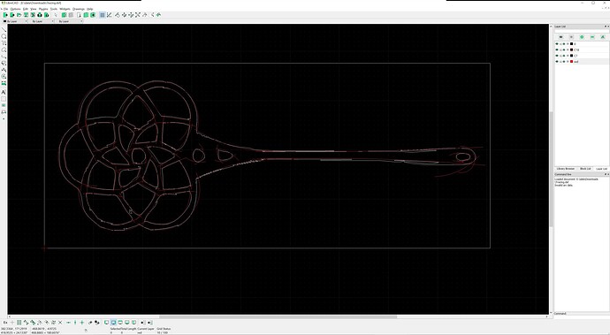

Yes… carpet beater. Don’t ask me… she said she needs it for her doll house. Order is order nevertheless. Can you help me with vectors? Is it possible to “simplify” this file so it will start looking like it should? How would I do that in inkscape?
Thanks!

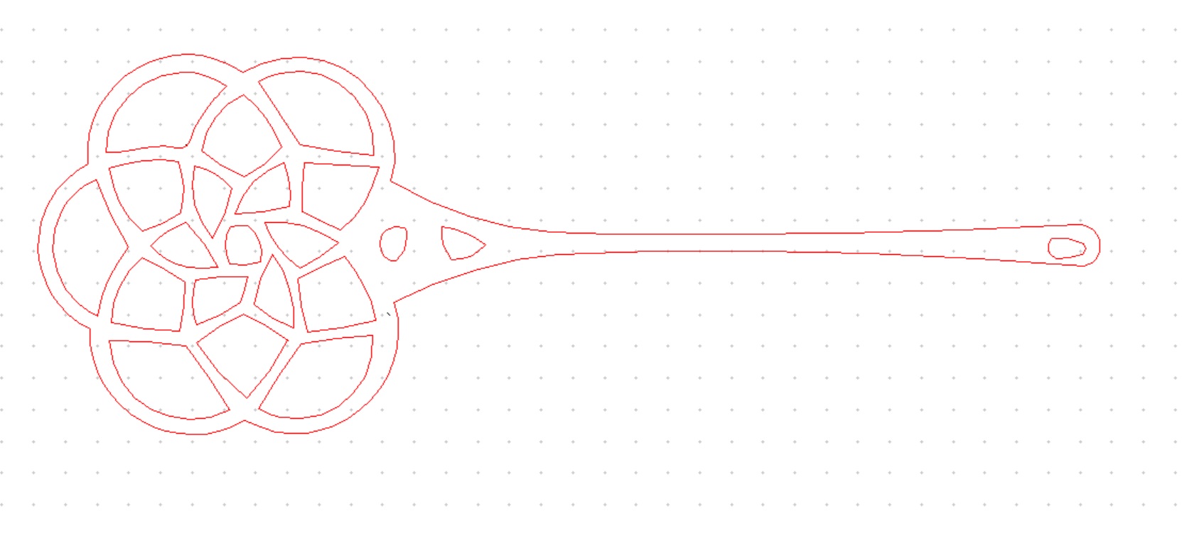

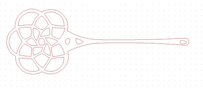

I use Librecad. Import the dxf -
Clean up the 'dross by block selecting it and hitting delete, then create a new layer and use the straight and curved line tool to trace around the shapes
export the dxf into Vetric Aspire to cleanup all the loose tails and export the finished dxf
beater_finished.dxf (135.9 KB)
OK… it’s only an approximation of the original!

Do you have it as a jpg, png etc? Inkscape can trace it and it usually is pretty good at it.
OK, I will have to watch some tutorials, because Inkscape is a bit… non-intuitive for me.
What is this option/feature called?
Edit: Ah, there is trace bitmap - is that the thing you’re thinking of?
Correct, you can do that, delete the png and then save as a DXF. Those are usually pretty clean already.

I played a bit with Inkscape’s trace bitmap thing @Tokoloshe suggested and it’s awesome. For simple things like this carpet beater it works with no manual intervention after at all! I will probably play with more complicated files at later date to check :slight_smile:

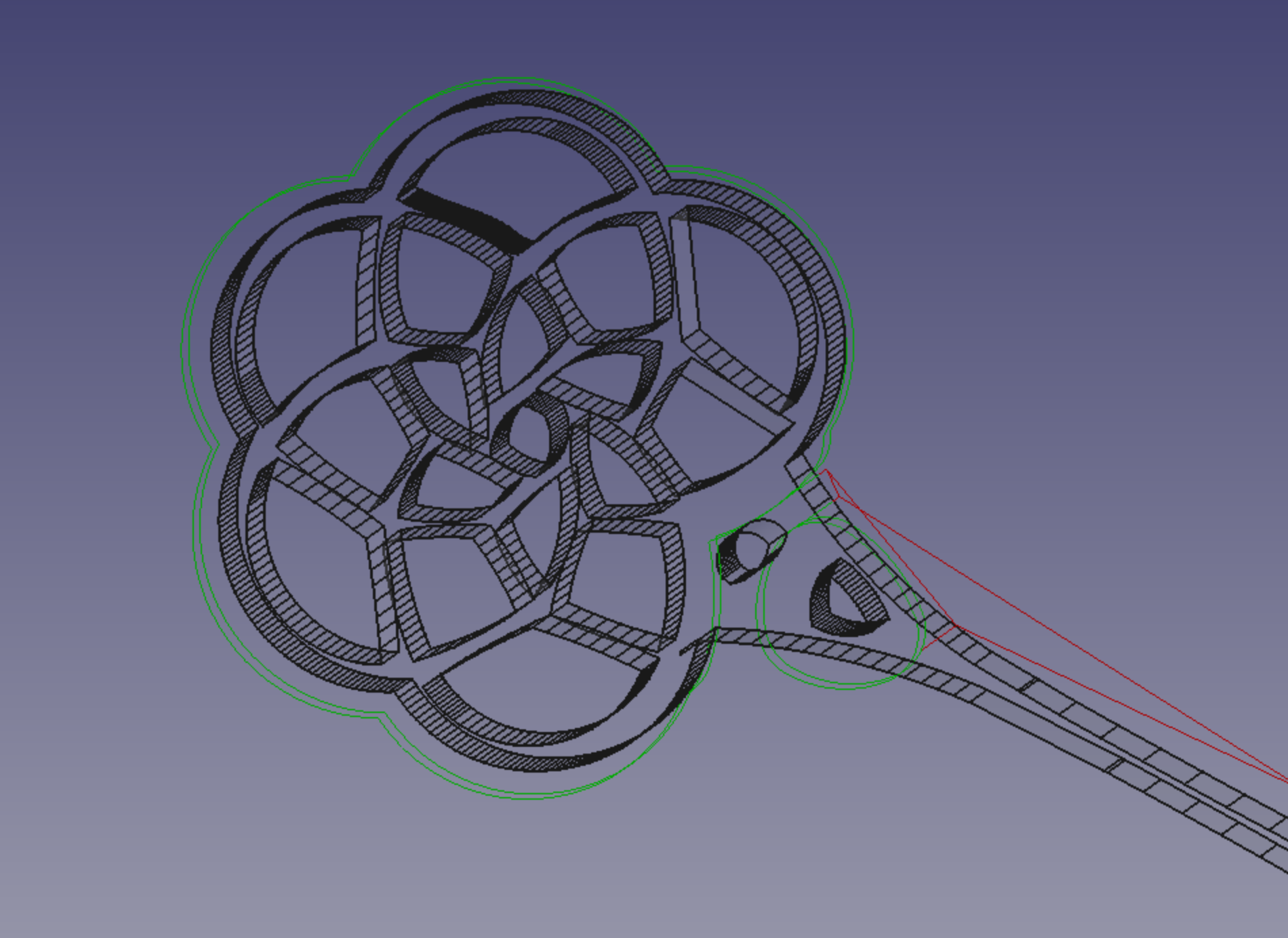

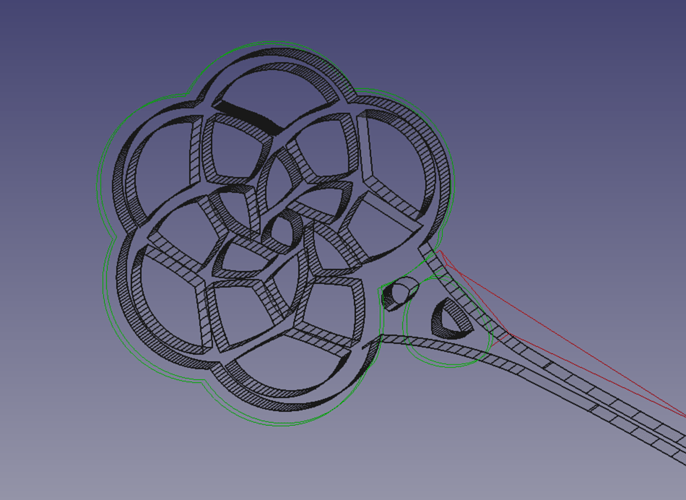

I just imported the dxf in freecad (used old python methode) extruded the beater as a part and voila.
