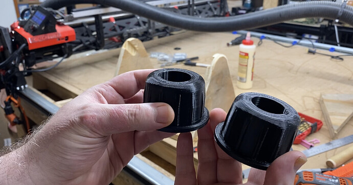

Fit for “WypAll General Clean L30 Heavy Cleaning Towels” - makes functional use of 1" wooden dowel - see my YouTube video of this part in action:
“LowRider v3 DIY CNC - Easy quick project - super satisfying!”
I am including the SVG files for the CNC cut job to make the sides.
The towel holder shown can be mounted on a wall, or placed on a table.
Plywood used in this project:
• Thickness: 3/4" (18.9mm)
• Total area needed: 32.64" x 11.5" (829 x 291 mm)
• Base: Plywood Dimensions: 14.5" x 11.5" (368.2 x 291 mm)
• CNC cut area: Plywood Dimensions: 18" x 11.5" (457.2 x 291 mm)
Dowel rod (broom handle?) wood used in this project:
• Diameter: 26 mm
• Length: ~350 mm (or so)
• Possible source: Birch Wooden Dowel Rod | 1" Diameter x 36" Long | Pack of 2 - Amazon.com

Small suggestion:
Make only one side have a slot for the center axle, the other side as just a round hole. This is how most of the commercial holders are made, and its slightly harder to accidentally bump the whole roll out of the holder, but still reasonably easy to replace the roll.
From using similar holders in the past, the asymmetric design is functionally more secure, particularly at the end of the roll when there isn’t much mass and the rate that the axle rolls at increases. It wants to drive up the side of the holder and it can’t at the captured end.
I actually did enter it. However, I have not read the fine print on the contest concepts, and I tend to think that a solution that requires other materials beyond 3-D printing may not fare well.
This is a great suggestion!
I had considered that if there is any instance of the roller coming out of the holder, that I can simply drill from the outside in through the dowel and run a screw into each end of the dowel from the outside, then when it finally came time to change the roll I would simply need to remove two screws.
I now have this holder hung up vertically.
And now… it could be a single screw. :smiley:
Yep. It’s a great suggestion. However I’m probably not going to redo it, so the benefit of that will be any others who make it. :grinning:
Also, because that roll is so fat, and the clearance into the holder is so narrow, I would have to check to make sure that the dowel rod could even get inserted into the hole on the one side. I’m guessing that maybe by just simply pushing until the paper towels get deformed, it could be fit.
There isn’t a lot of area topside of the hole, so it shouldn’t be too bad for the shop towels.
