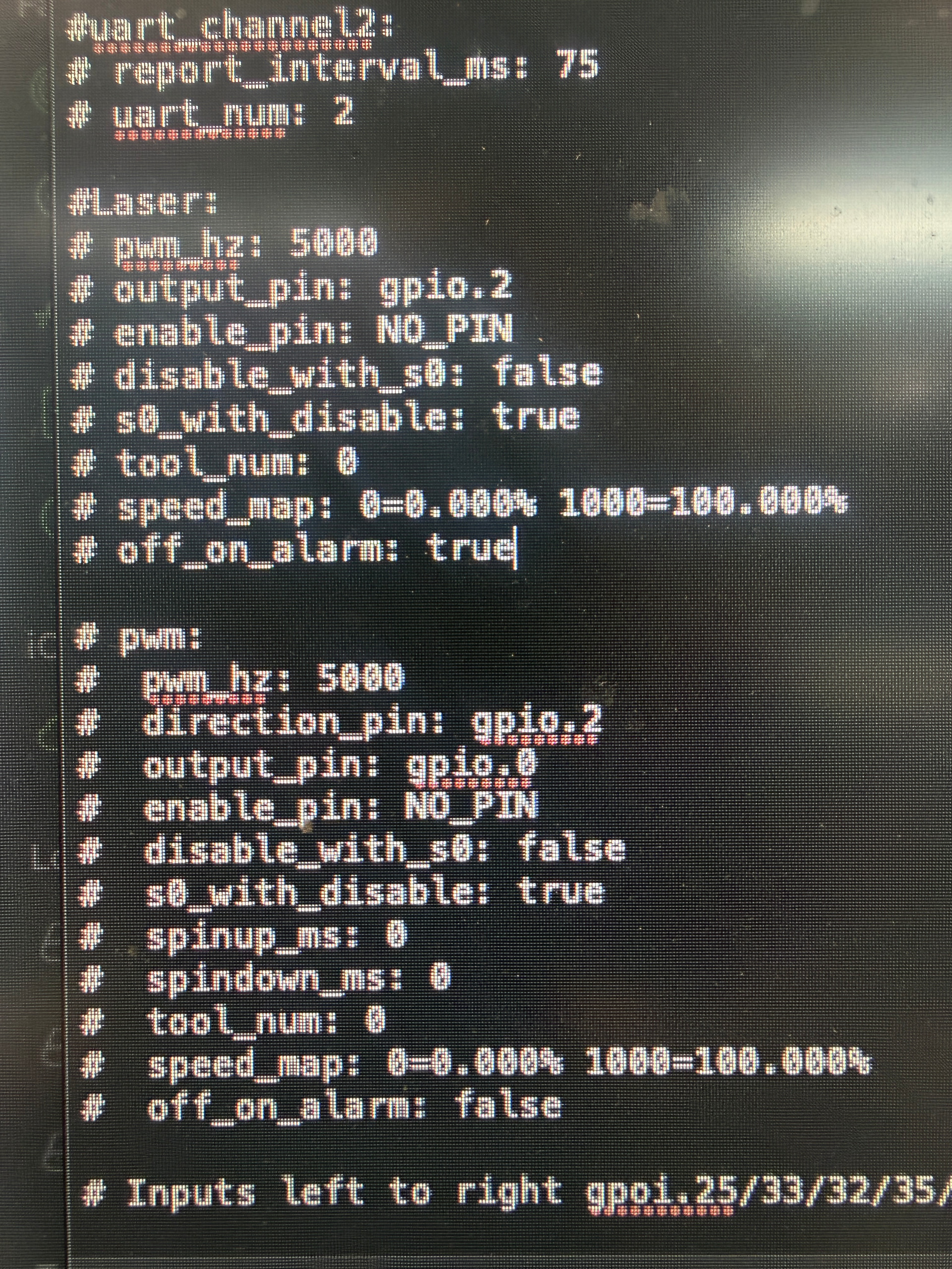

Laser still does not fire. I have checked the config file, and gone over my LB settings, even deleted and re added the laser. Here is a photo of the laser section of the config. From what I have read online, fluidnc is supposed to default to laser mode, but my $32 remains 0, and I cannot get it to change either in the webui or LB.
The “#” in front of all those lines means it is NOT enabled.From PWM_hz to off_on_alarm, remove the # in front of each line, leave one space.
Edited, and re uploaded through webui, cycled power, deleted and added laser in LB and still not working. I verified that if I plug into pin 2 and fire through button 2 in webui the laser does fire.
Do you have any errors in the webui terminal on boot or $ss?
You have to make sure you only have pin 2 configured once. I’m sorry I can’t just give you a config but I do not currently have lightburn to test with. Doing my best to help blind.

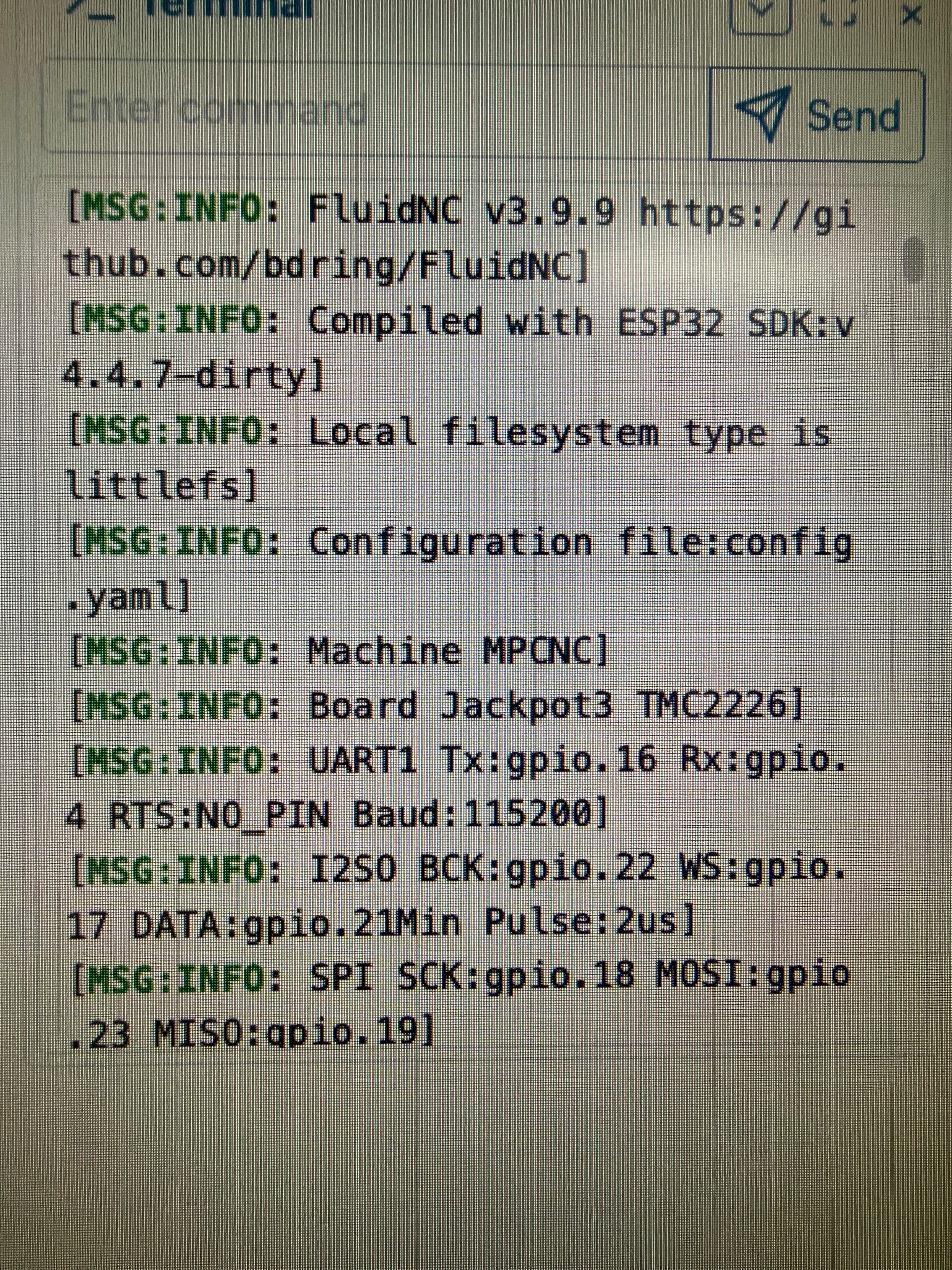

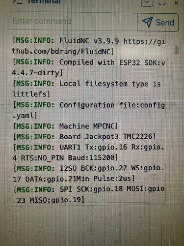

At boot I have a “sdmmc_card_init failed code 0x108]”

Laser does not work in webui. Now when I turn the board on, it’s in an actual alarm state with the same sdmmc_card (do not have a sd card in the slot), with every line beginning with a orange “alarm” and I cannot do anything.
