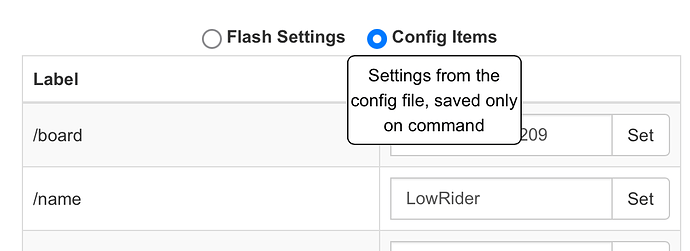

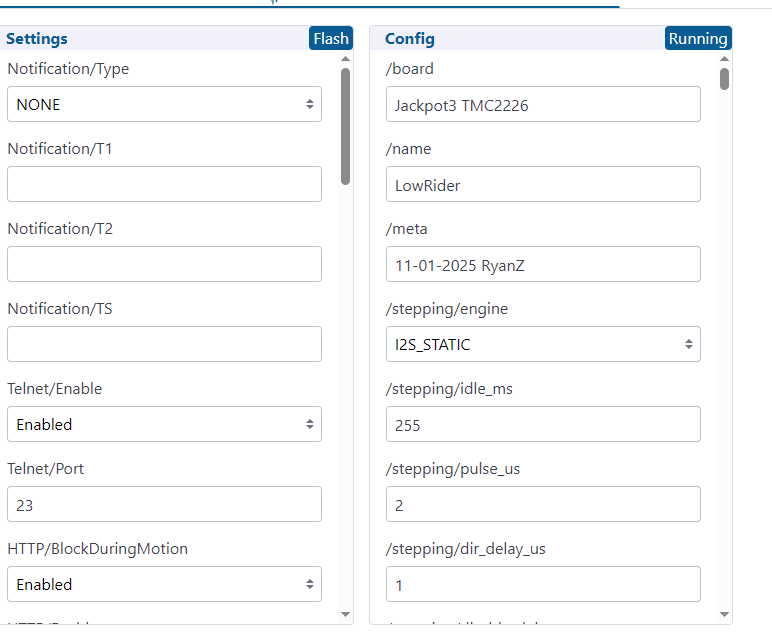

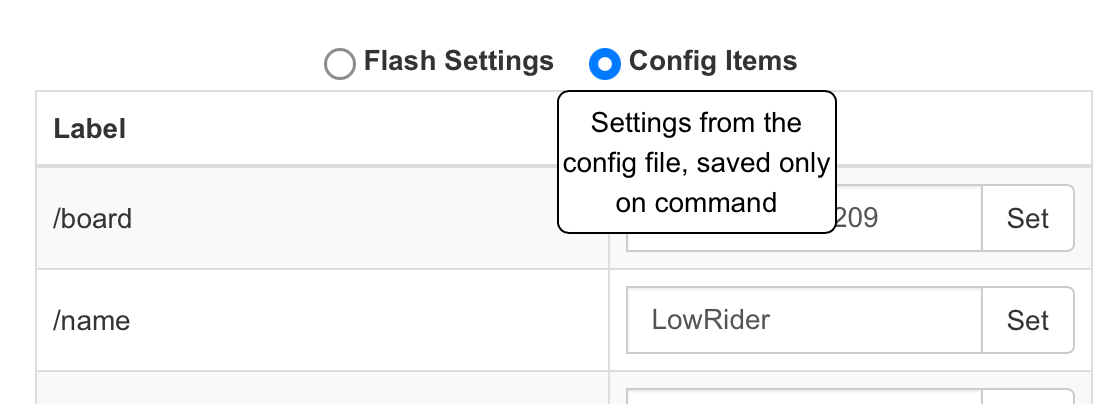

I bought two jackpot 3 and wanted on LR firmware and the other Primo but when I got the setup screen I see both board name LowRider . How do I get the Primo Firmware updated
You don’t need to change the firmware, just upload the Primo config.yaml file and reboot.

On v2 UI those text fields were active and you could update it there and save using the ‘Save’ macro, is that no longer the case in v3UI?
