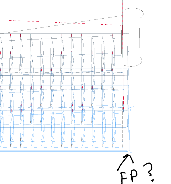

I haven’t had a chance to test for real yet, but would it show in the 3d preview in ESTLCam?
I’ve tried a few times and can’t get a full depth pass to work, it always steps down for every path - wondering if it shows in the preview for others using their workable settings?
You are going to see stepdown for the normal path. If seeing it up, check whether there’s a second, lighter colour line around the part. That’s the finishing pass.
Thanks, I think I can see it.
In this preview, the final/deepest layer has like a pointy outline, which must be the finishing pass. That is done last, after all the other layers are done and stepped down one by one.

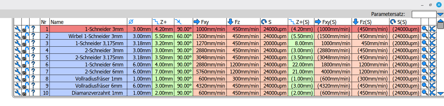

Is there a way to make the finishing pass automatically match the cutting depth of each Gcode program? Or doesn’t this need to adjusted manually with the tool edit each time overall cutting depth is changed?
You set the depth of the finishing pass in an extra setting in Estlcam’s toolsettings. You just put the maximum depth your endmill’s edge is, for instance my 6mm endmills can cut 21mm deep in one go, so you just put that in. The idea is to do a full depth finishing pass if your endmill allows it for an immaculate look. :slight_smile:
When doing a finishing pass, it’s going to use this depth up until 21mm, after that it will split the pass in two sections.
The fnishing pass is the Fxy(S). If the value is in brackets, it’s the same one from the “normal” cutting (so basically I never used it with those tools). The ones without brackets show you where I changed the values.
okay and so the 21mm you’re referencing is only a maximum doc? ie. if I’ve set the overall doc for a project to say 12mm, the finishing pass will be done at 12mm or will it try to plunge to 21mm?
It will then only do 12mm. The Z+ you set is always a maximum depth, also for the “normal” Z settings.
The factual DOC is then set when programming the toolpath and Estlcam calculates whether it can do it in one pass or several. So for Z, always set the maximum Z depth you are comfortable with for normal cuts and for the finishing pass set the maximum depth to the length of the cutting edge of your endmill. :slight_smile:
