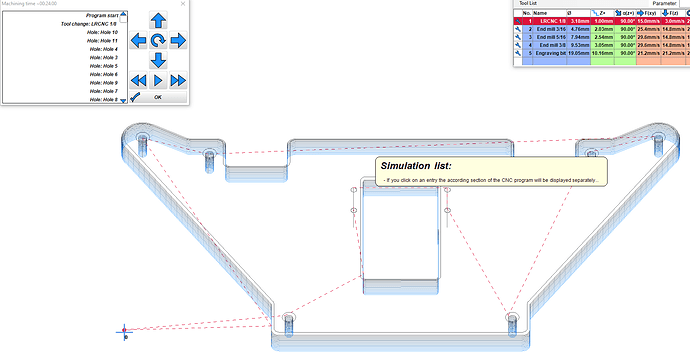

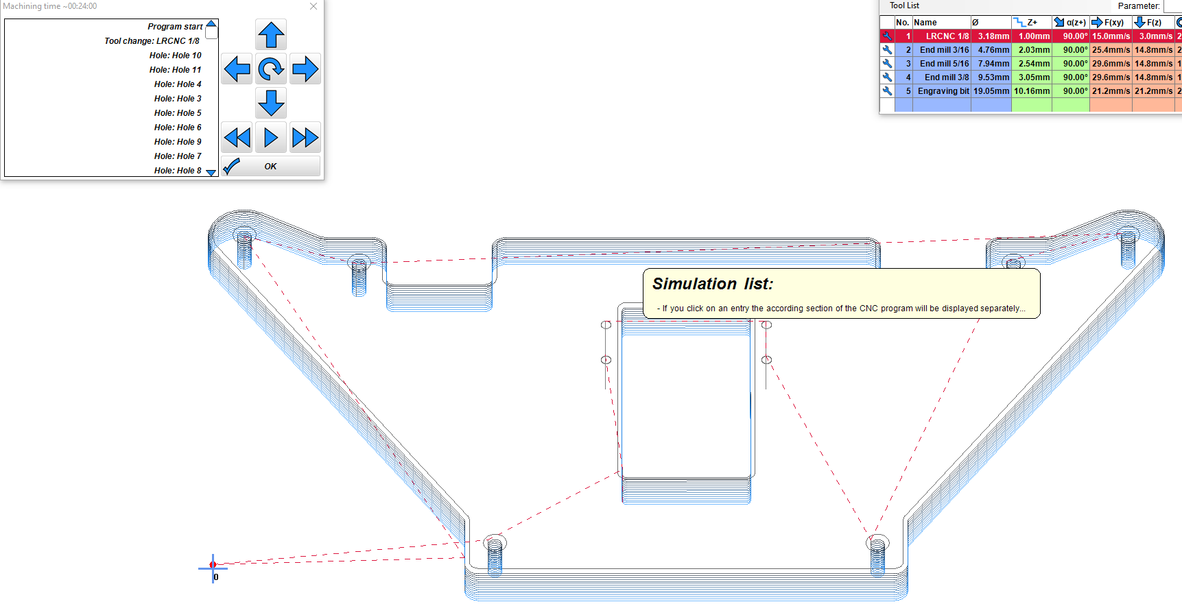

Hello, I’m trying to make my first “cuts” on my lowrider2. I’m using the V1CNC_SkrTurbo_DualLR_2209-bugfix-2.0.x firmware on a SKR1.4 turbo with TMC2209 and a tft35 touch screen. I have the machine moving well and my endstops working correctly. I’m following the “Estlcam Basics” instructions on V1 and trying to make new Y plates as I’m running printed ones at the moment. Z Orgin is set for material uperside.
When I try to start the gcode, the Z access will drop much too far down, crashing my tool and casing me to hit the E-stop. While my endstops work for homing I’m unsure how to stop this crashing. I’m thinking the machine wants to go to it’s Z origin but I’m unsure where that is set and how to change it. Not sure if’s in Estlcam, marlin, etc.

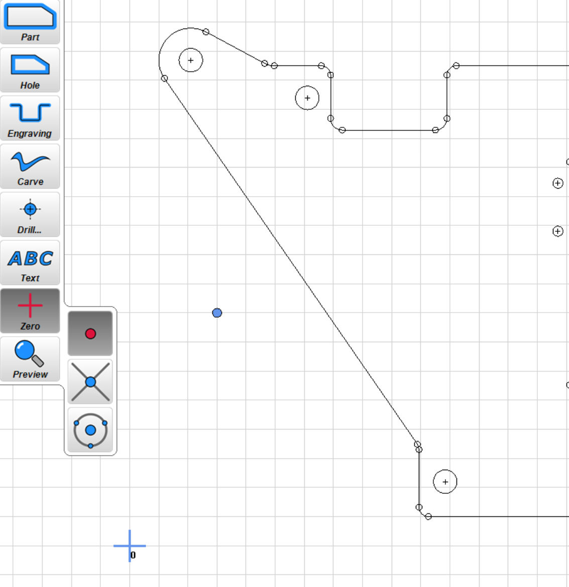

Okay, so in your example above, before you create the gcode, move your origin point say, 10mm off the sides of what you want to cut.
Then you can save it out to your gcode.
Now get your wood mounted on your table and manually move the endmill to where you want to start, don’t forget to make sure you’re not going to hit whatever you’re using to hold down the wood.
Drop the tip of the endmill down to the top of the surface, and in repetier host issue a G92 X0 Y0 Z0 in the console window.
This will set the zero point on the wood where the cross is in estlcam.
There is some info in the docs about coordinate frames:
https://docs.v1engineering.com/learn/coordinates/
But you just need to do something that works for you to set the zero location. G92 X0 Y0 Z0 works great, either as macro, or from the screen, or part of the starting gcode.
The G92 command sets the current location to become the work origin, so you need to be there before you issue the command.
Just in case it’s not clear from the context, jog the machine so that the tool is at the 0,0,0 point you want, then issue the G92 X0 Y0 Z0 command.
