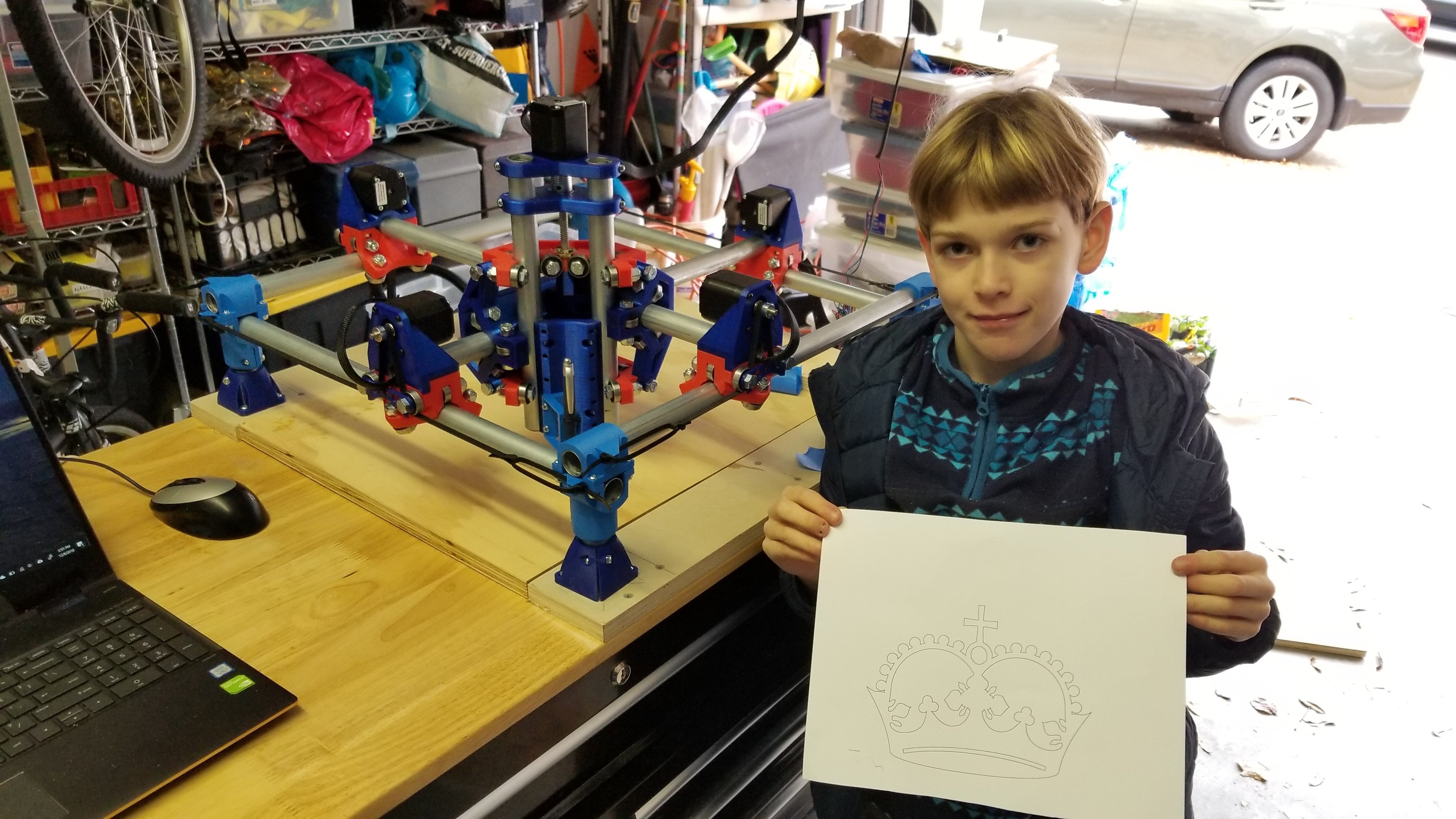

Hi all, this is my first post.
My son and I just finished setting up a standard sized MPCNC. What an incredible project, we’ve had a lot of fun.
I have not been able to figure out how to make repetier host, or the RAMBO 1.4 to recognize the current location as home. I know I can manually move the router to where I want for x/y before powering up, but moving Z manually is difficult. If I use the controls in repetier host to manually lower the Z to the top of the workpiece, it sees that as negative and moves away when the print starts. I’ve tried sending G92 X0 Y0 Z0 E0 after positioning to no effect. The only thing I’ve found that works is to use repetier host to move down to the Z I want, then disconnect, power off the RAMBO, and power back up again.
This is pretty simple, I must be missing something basic.

Perfect Giant Crown!
