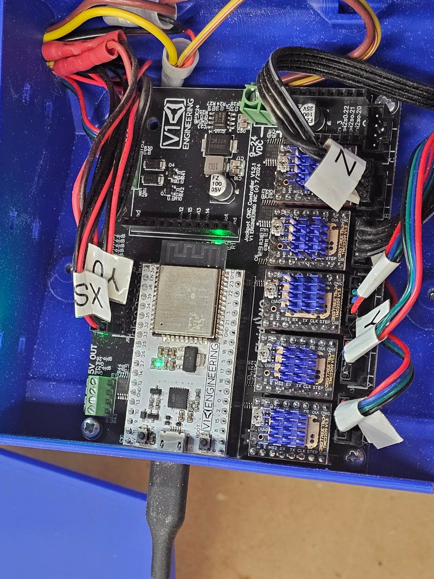

I had rolled back Fluidnc to 3.7.13, now have it back to 3.9.1 with the current yaml. I have not been able to get an SD card to register, ordered 3 from Ryan. The new cards all failed to register as well. I am using Fluidnc in AP mode where I am able to jog and home the machine on all three axis with no issues or errors being reported.
I have been working on this issue for a week now and asking for help.
I hope I am doing something incorrectly but at this point I am thinking it may be a bad jackpot controller.
I believe Ryan has said he tests them all before shipping so it’s not impossible but not the most likely culprit.

Are you plugging in the USB before powering up the Jackpot?
Make sure the USB is unplugged, and power it fully with the power supply first just to be sure everything is initialized correctly.
Yes, it is plugged into the card in the picture but unplugged at the computer, easier that way

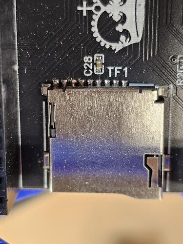

If you take the ESP32 off the top can you see any issues with the solder on the SD card slot pins.
I have not checked every SD card so it looks like I will need to start doing that.
If the solder looks good and or you are not handy with a fine tip soldering iron please PM me your order number.
I am not comfortable with the fine tip soldering iron, sorry.
Here is a closeup of card slot.

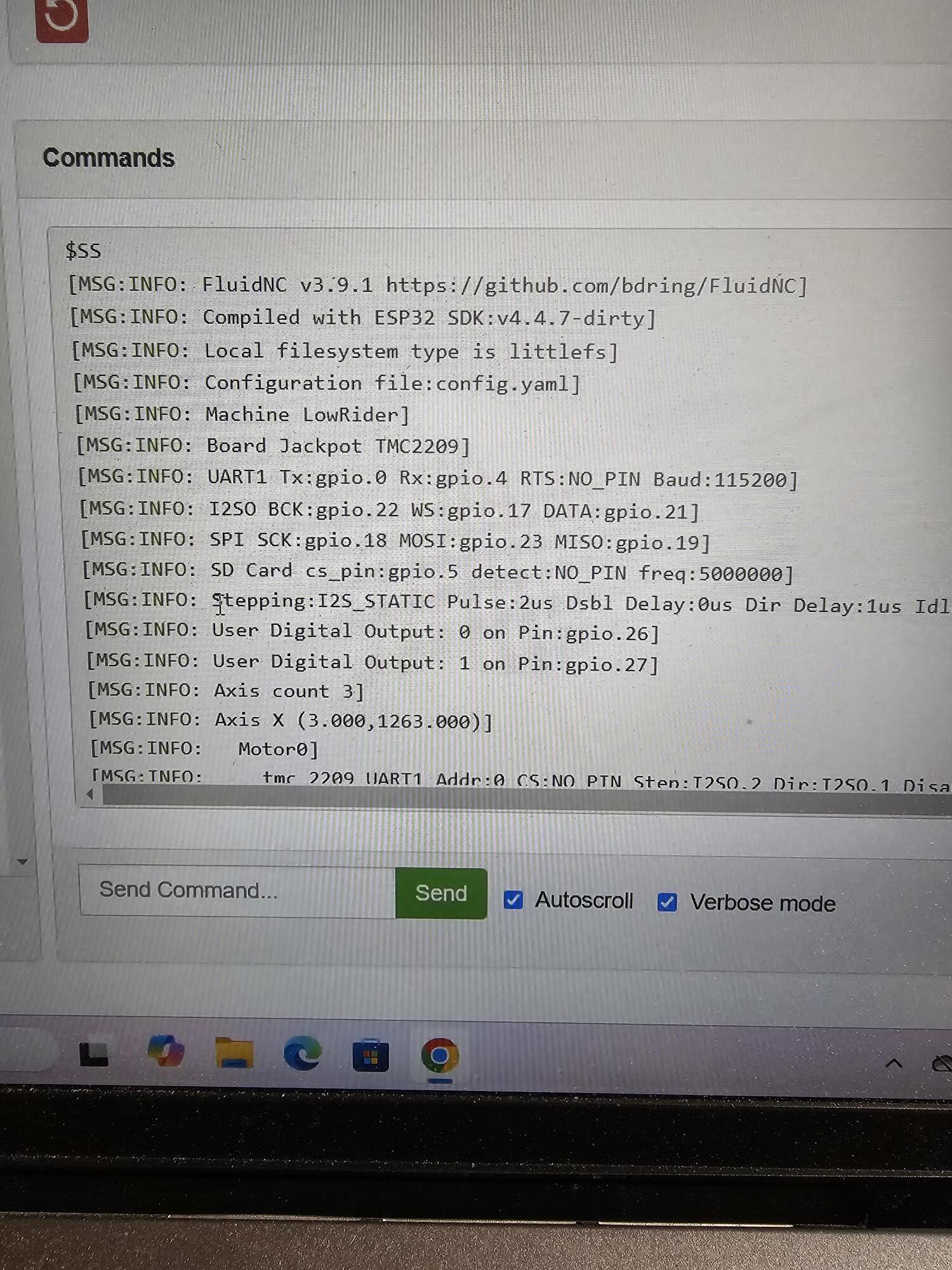

If you power on your jackpot with an SD card in it, you sould be able to pull an $SS diag command out of it and see a message like this one:
What do you get?
I read the Fluidnc Wiki on the SD Cards, I don’t know for sure if all the old chips I had here supported SPI however all the new ones I have purchased do. The larger one is one I had on hand. I tried to keep the size to 32 but did buy on 64 hoping just maybe it would work. Some of them were formatted with the exFAT32, that was changed to FAT32.
I will send the message I get in the morning so this is from memory, up near the top are 2 lines for the SD Card, one looks like it is looking for a signal from pin 5
At the bottom is the line
MSG:ERR sdmmc_card_ini failed code 0x108
When I hit the refresh button it just repeats this message. This has never changed regardless of what SD Card I have in the socket.
I believe it is the same with no Card in the socket also.
Another troubleshooting step you can try is to lower the access frequency.
Change you config .yaml section frequency_hz to a lower rate- something like the following.

I followed your instructions, the results are still consistant, no difference.
