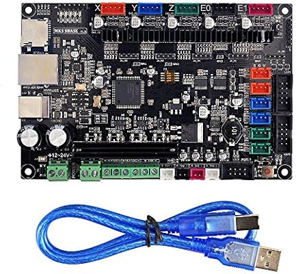

Before anyone gets offended, I tried to buy legit smoothieboards. I understand there is some open source beef going on in the smoothie world. For me I might be able to buy a single smoothieboard but if I want to be able to offer them as a bundle option, I need a bunch of boards. I have emailed the US supplier many times over the last few months.
No Reply.
So I bought an SBase v1.3. I have no idea the difference between the v1.2 and the v1.3 I can only assume it is the quick fixes of the v1.2 added in and someone renamed it but not MKS.
Hardware-
-The board is very easy from my perspective I don’t have to assemble anything (unless you count inserting a micro SD). I don’t have to manually adjust pots.
-This would also make the power supplies easier for me to deal with.
-The full graphic LCD from the shop works (although the plugs have to be inserted the wrong way in the jacks).
-The standard stepper plugs are a bad fit, pulling the white plug housings off the board makes them fit much better.
-large heatsinks preinstalled and it looks like you can also add some to the bottoms of all the chips (drv8825 chips drain heat from the bottoms much better I have read)
Software-
-Smoothieware is easy enough to configure. I will not say it is easier than marlin, not even a little bit. It can be much more easily customized in some ways but the polish is not there like it is in marlin, and I think repetier firmware is even more polished than marlin.
-I understand that these processors are more powerful but for what we do it doesn’t matter.
-All the same settings as marlin really, no game changers in my book.
-It does have some direct settings for spindles and other external components, marlin/ramps does as well but smoothie makes it easier.
If anyone want to give it a try, I will attach my bare bones config for the MPCNC. I have not fully tested this cutting anything yet but it all works as well as the LCD.
Anyone think I am missing something?
Cool boards and software, hope to offer them as a bundle option soon.
config.zip (2.93 KB)

I have read a little up on the smoothie boards, mostly in this forum and from comparing buying a new mega, new ramps and new drv8825s and then comparing that to the $65 buck for and smoothieboard that has everything in one board, has integrated sdcard reader, network port, lcd interface integrated single power connection, integrated drv8825s and several other pluses AND fusion 360 processor I think i am going to go that route.

This is the board i am looking at -
https://www.amazon.com/gp/aw/d/B01FVT5VA8/ref=pd_aw_sbs_147_of_4?ie=UTF8&psc=1&refRID=YYPV16G7A15GABQV5TCK

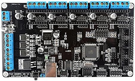

I am also looking at a SainSmart 2-in-1 3D Printer Mainboard Controller Panel for RepRap Arduino, Combination of Mega2560 R3 and Ramps 1.4. With screw terminals instead of the dupont connects , which i loathe.
Have to purchase the drv8825 seperate, but still

well the sainsmart 2 in 1 was just totally disappointing.
I plugged it into my usb port - NO DRIVER - no standard driver. Had to hunt down the official FTDI drivers and install manually from inf files.
That gave me a ‘VIRTUAL’ USB port. Reconnected to my computer and launched the Arduino IDE. Complied Marlin firmware fine but on upload it just set there uploading until it timed out. OVER AND OVER.
So I had to hunt for hours for relevant documenation and when I did find documentation I CRINGED.
Apparently the boards, which are supposed to be new, were launched with and ancient bootloader.
This bootloader will not work with anything newer than Arduino IDE 1.0.4. The current version 1.8.4 will not work.
Downloaded Arduino IDE 1.0.4 ZIP. Ran from unzipped folder.
Attempted to compile Marlin and it refused to compiled because it did not support that OLD of a bootloader.
By that time I was furious and BOXED IT UP AND SENT IT BACK TO AMAZON FOR A REFUND.

BROKE DOWN AND PAID THE EXTRA BUCKS FOR THE Gowoops MKS SBASE V1.3 3D Printer Control Board, 32bit Arm Platform Smooth Open Source MCU-LPC1768, Compatible with Smoothieware

I recently got my MPCNC upgraded some & had everything hooked up I thought. Turned it on & something went on the board. Think I have fried 3 mega boards over the last couple years. This is the 1st time I have fried a board on the MPCNC though. I am deciding whether to buy another mega board, a single mks base V1.5 board or something similar. In the past I have replaced the Ramps+Mega+DRV825 because I was not sure whether any of the other boards were affected. This is the board I am looking at, https://www.amazon.com/gp/product/B01FVTQQ2K/ref=ox_sc_act_title_1?ie=UTF8&psc=1&smid=A1LCDIR1SM8KTJ
One thing that I just discovered was the motor connections on the board are different from the ramps. Why did they change this connection from the Ramps when that is usually what people are upgrading from? I saw earlier in this thread that Ryan just pulled the plastic casings off the SBase board & maybe that is all I need to do.

I was able to just push my dupont connectors into the jst connectors and it seems to be working fine. I tried to pull the jst plastic adapters from the board but they seems to be in position fairly well and I was worried I would damage the board so I was able to just push them into position.

I went ahead & ordered the MKS Sbase board that you gave a link to on Amazon. Since Ryan has a config file for the 32bit now &you having good luck with, it seems like a good choice.
