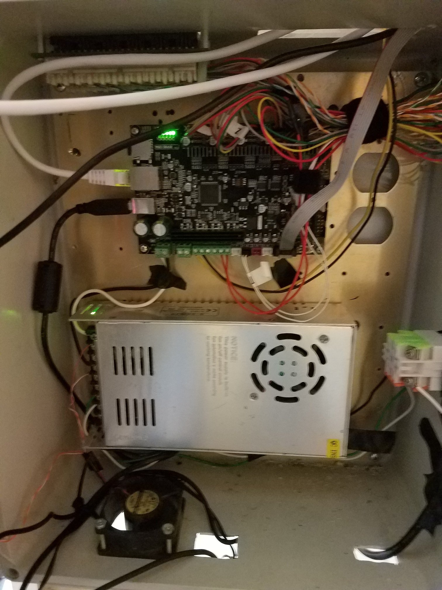

Sounds good. I have a few more questions if you don’t mind answering them. I am still planning to put a fuse on the 12volt line. Do you know what amp fuse I should use? I am not running a heatbed or extruder off it. I am only connecting the motors & endstops. From looking at that config file, should be only 4.5amps for the motors, so maybe a 5amp or 7.5amp fuse. Are you using x & y endstops? I might have to change the wiring on those. Do you have a photo of yours all wired up? The last question is there a resistor plug required on the hotend thermistor connection?
Thanks,
David
Do you know what amp fuse I should use? I am not running a heatbed or extruder off it. I am only connecting the motors & endstops - From looking at that config file, should be only 4.5amps for the motors, so maybe a 5amp or 7.5 amp fuse. - I am not using fuses. I maybe should. I am not sure how to impliment a fuse - If you end up using fuses let me know what you did and I will follow suite. I know you would want the fuses to blow before reaching the max limit. The config file says 1.5 amperes per axis but each axis is wired in parallel so 3 amps per axis?? Not sure how that works - already forgot my RETS Electronics ohms law stuff
Are you using x & y endstops? YES - I am using the alpha, beta and gamma (x,y,z) min endstops for homing - I eventually want to use max endstops as well - I am using WGCD 20 PCS AC 125V 5A Micro Limit Mini Switch Roller Lever Arm Snap Action SPDT 3 Pin from amazon - pack of 20 for less than $10.00
The last question is there a resistor plug required on the hotend thermistor connection? - I dont know. I purchase my hotend from the vicious1 shop MK8 already built and have been using the same one for over a year and half without a single problem.
I have images of the smoothie board wired up inside my enclosure _ perpetually a WIP.
I have my cables punched down on a cat5 patch panel and have allowed for significant excess, I plan on building a better box. I have everything housed in the same enclosure. MKS Base 1.3, usb hub, power supply, 3 12v cooling fans, panic switch from vicious1 shop and my mini windows 10 PC.

I got the web interface working today. I used a different laptop, so that might have been my issue. Here are a couple of photos of how I have it wired up. The little plastic part between the P/S & the board holds a 5 amp ATC fuse. I have some 7.5 amp & 10 amp fuses also, but 5A seems like it should be enough for the x, y & z motors. I am going to put a plastic cover over the electronics & a wood cover all of it to protect it more.
I have mine all wired up & should be ready to cut something tomorrow. I had to change Ryan’s config.txt file a little with regards to the limit switches. My 2 wire mechanical limit switches are wired the way my 3d printer is which I think is opposite of what Ryan does. I noticed James’ config.txt had the endstops inverted from what I used. I included a photo of how my limit switches are wired. I am also only using the X & Y limit switch
