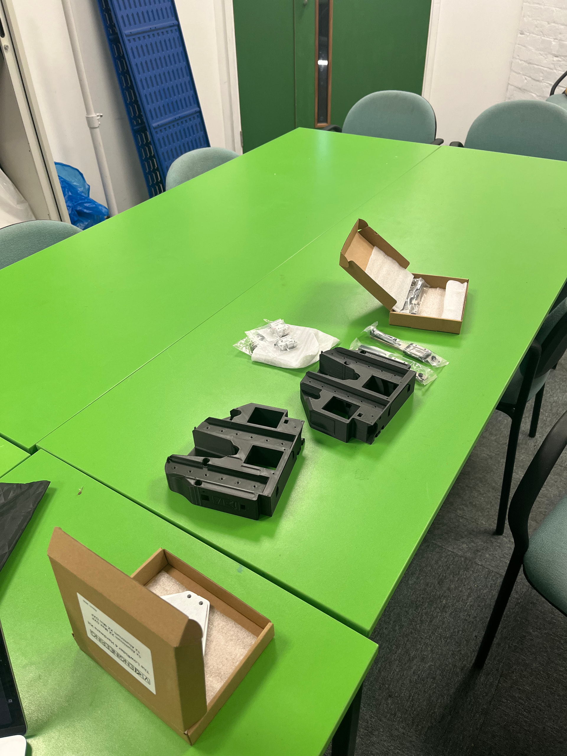

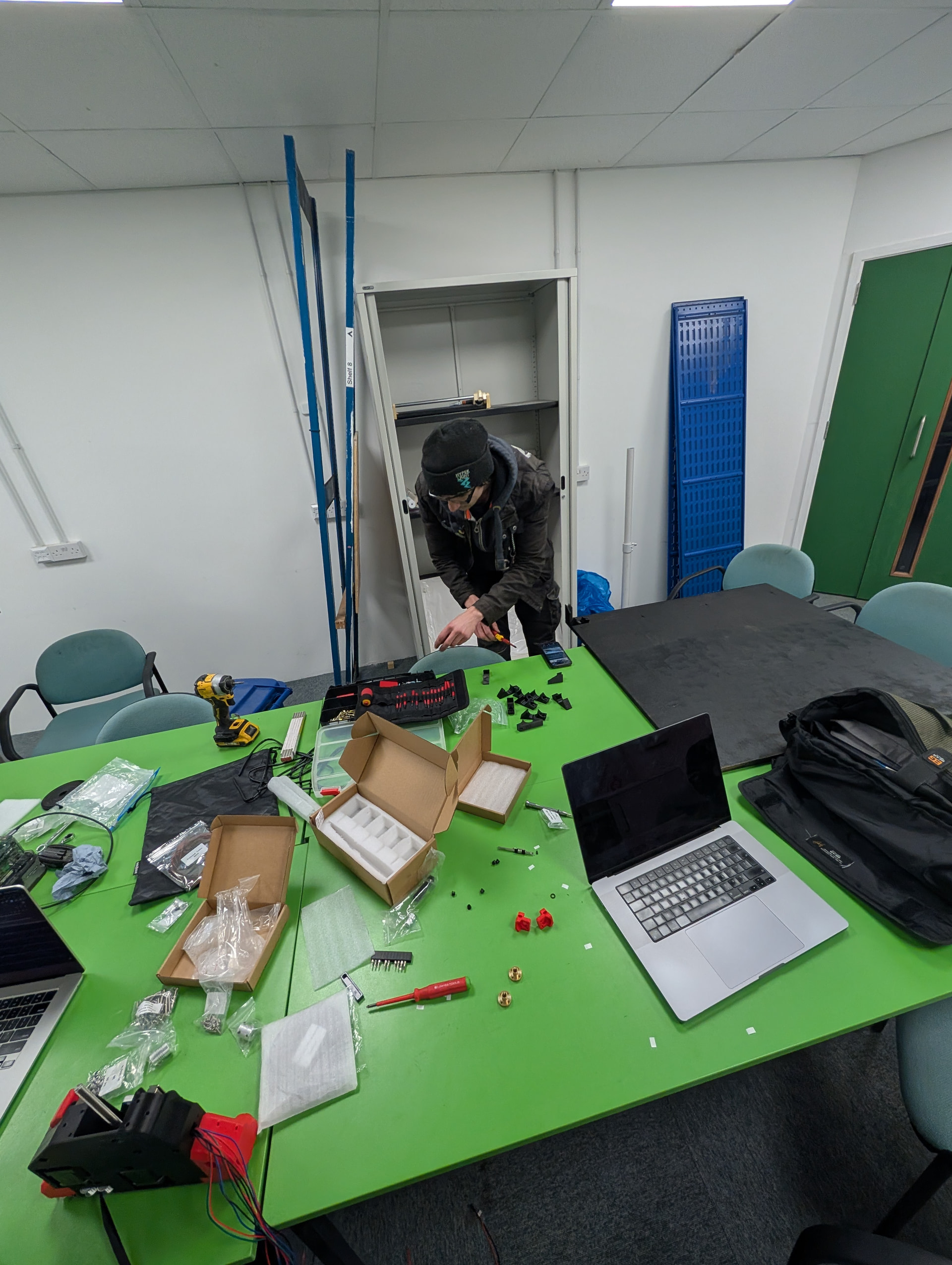

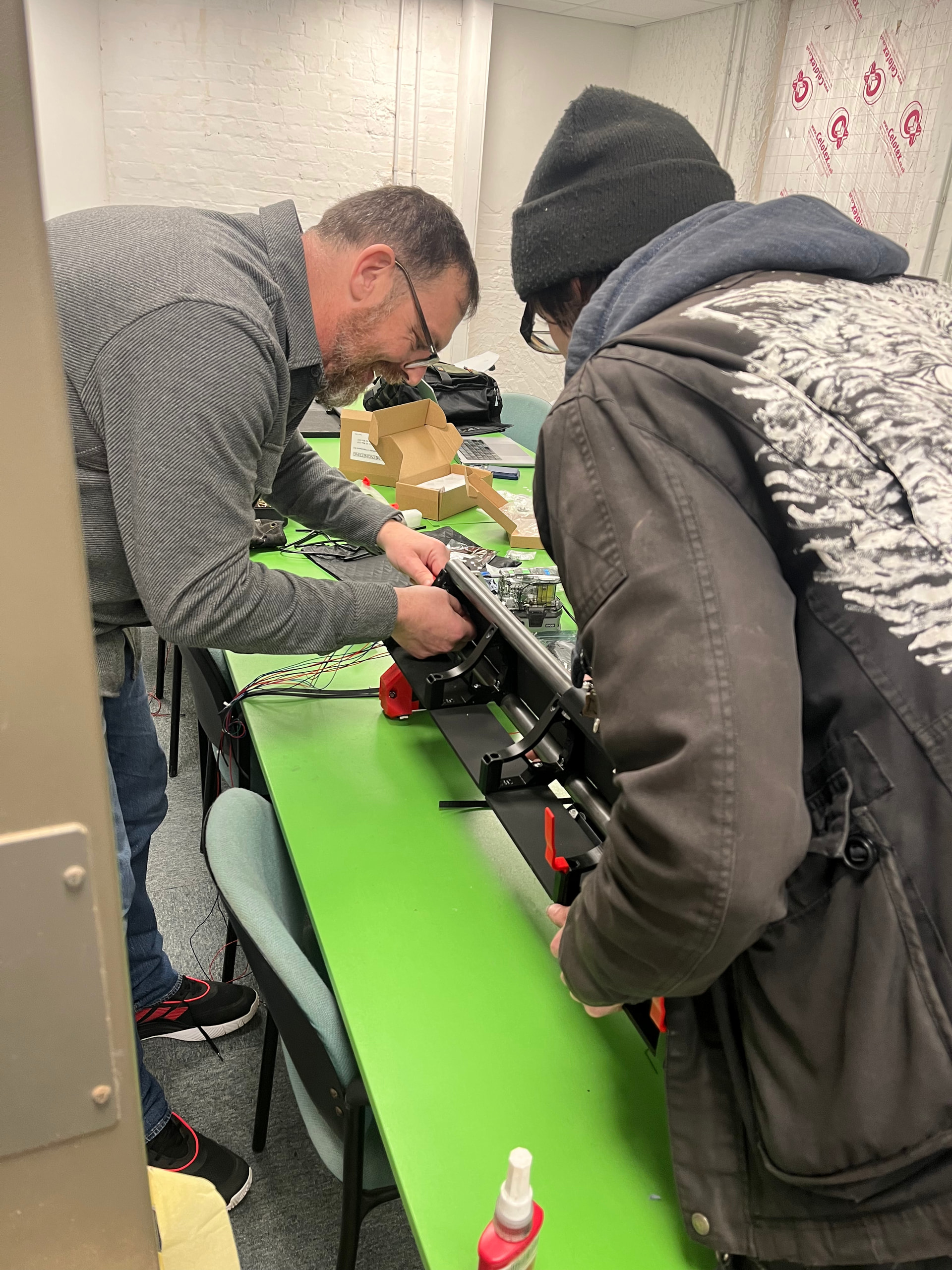

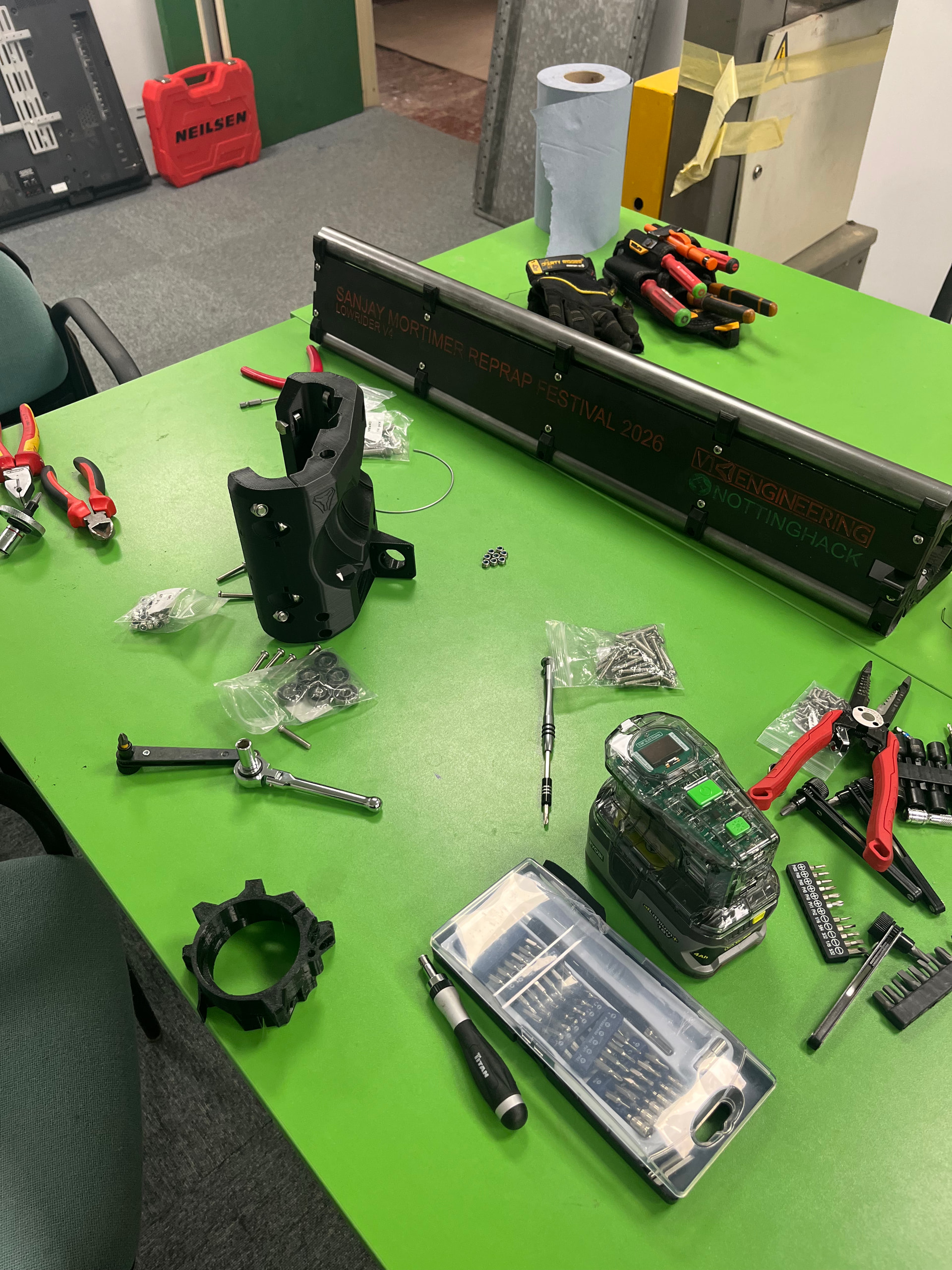

This morning at 09:00, we had a table full of parts.

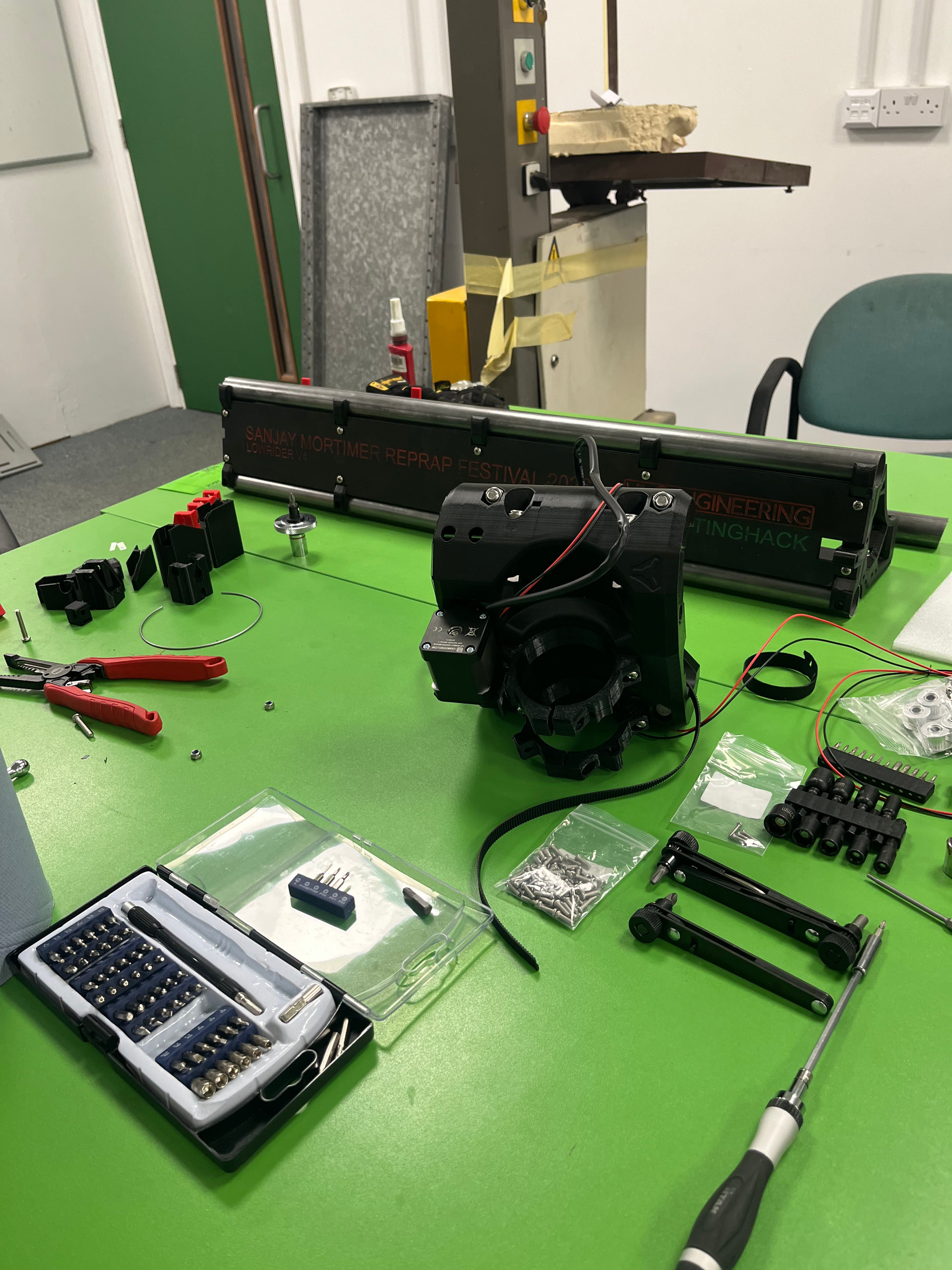

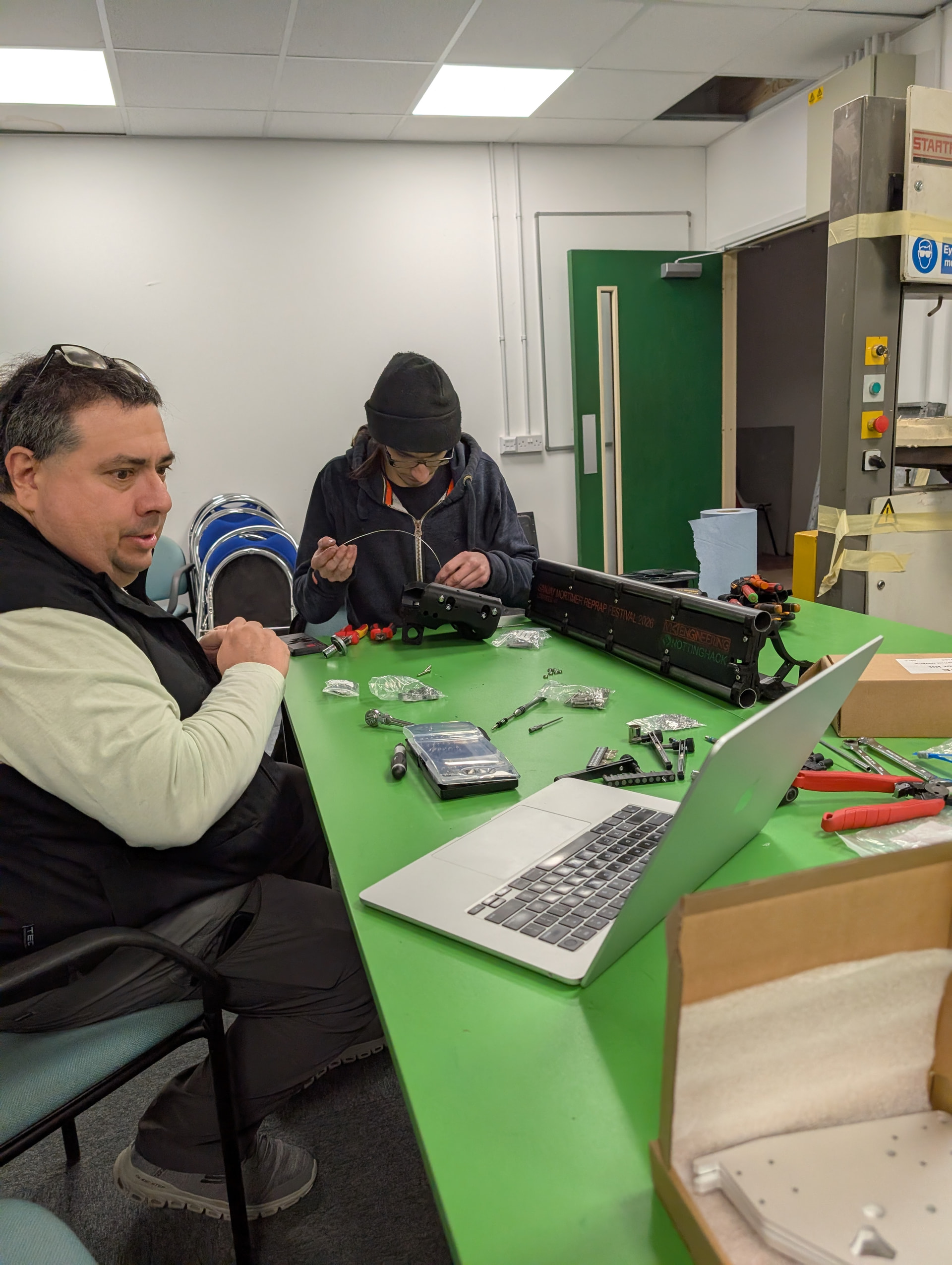

AJ and I started in, and Chris joined us.

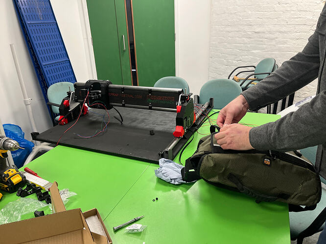

Chris and AJ cooperating on final assembly…

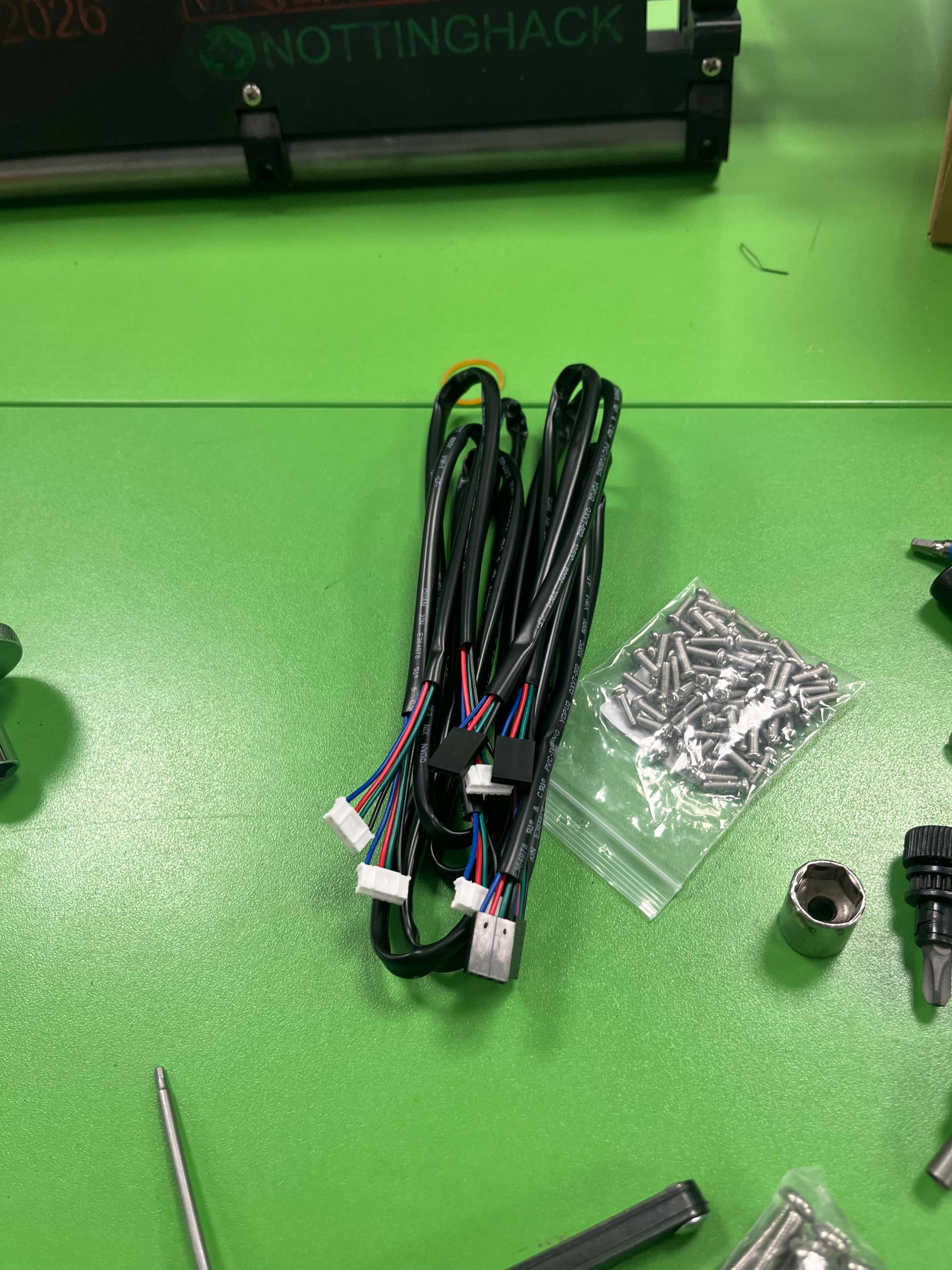

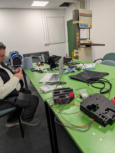

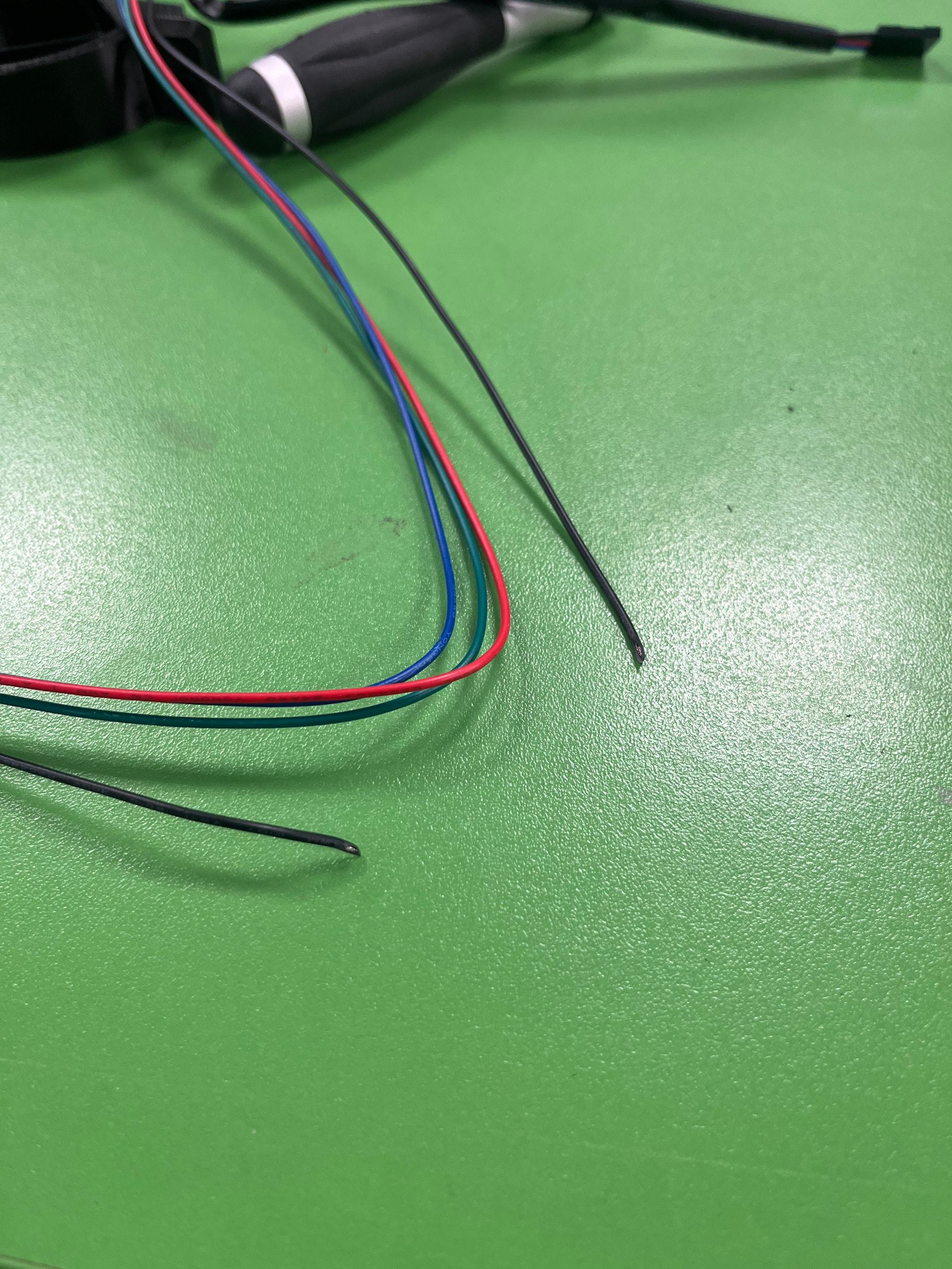

Looks like the LDO motor kits continue to come with sleves on the motor harness.
I snipped a wire cutting it off… and AJ soldered it up.

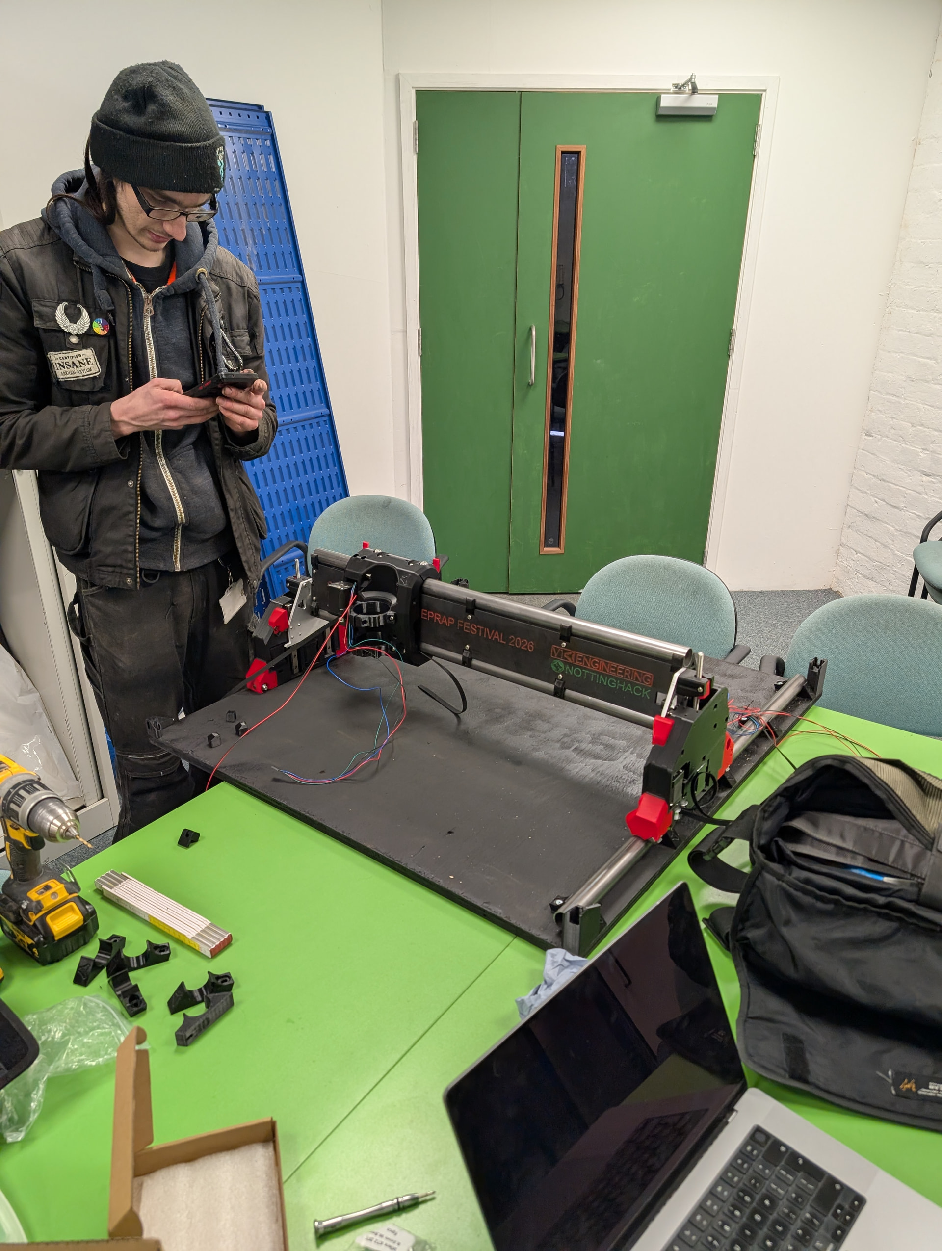

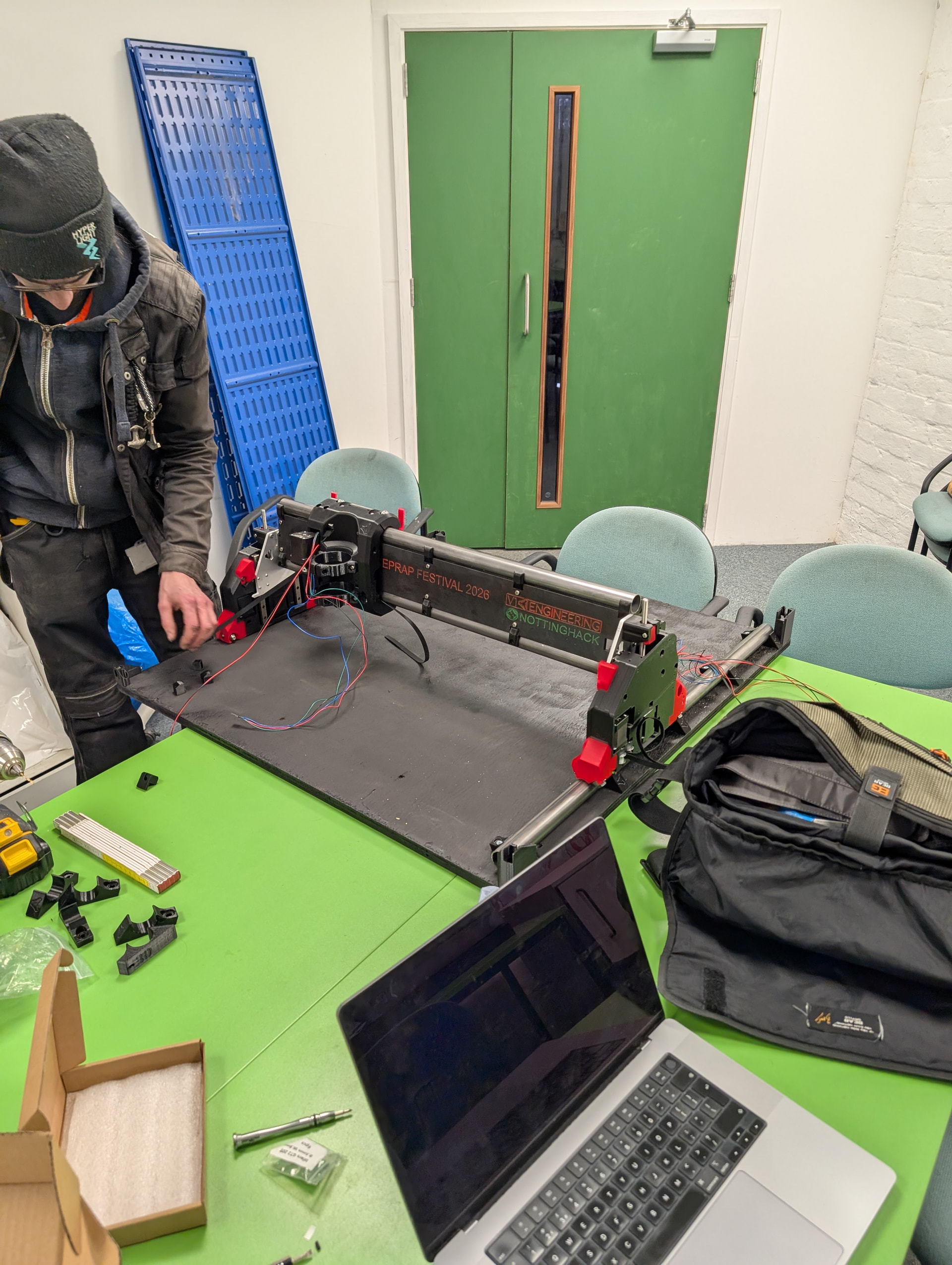

And at days end (16:00)
Tomorrow we drop the Jackpot in and wire up the battery box and off to Manchester we head.
Yes, you can build an LR4 in a short day, so totally doable in a long day or with one more body.

More pics from todays buildathon!

We set out to fully follow the instructions, but that lasted all of about 3 minutes, 29 seconds. :slight_smile:
I did take a some notes for things that are in the documentation but we still stumble on.
Some suggestions:
  • We should put a note that if you kit came with the poly sleeve on the motor cables, it should be removed. (Note: I managed to cut a wire trying to snip carefully through the sleeve.). Chris proposed a better method which is to snip a little into the sleeve, then use the wire itself to “Unzip” the sleeve, which doesn’t damage the wire.
  • The note about running the bolts/screws into the nylocs before using them is in there, but it isn’t prominent.
  • The kit we received had idlers which are toothed. That’s fine, but we should add a note to the documentation clarifying that it’s fine to use those.
  • AJ and I had a back and forth around “how do we lay out the table again?”. It’s in there but the documentation could be better about how best to lay out the rail and belt holders on the table. As you can see in the pictures, it turned out fine.
  • We used the trick of using an 8mm drill bit to clear out the holes for all the M8 bolts. I think this is in there, but a note about that being OK could be more prominent.
  • We did put the horizontal screw into the stubs, but only started it and left it loose. That leaves the nut holder free to move horizontally with the lead screw to prevent binding but doesn’t allow the nut holder to separate out of the z stub. AJ noted he’d had one jump out, and in fact so have I. They key points are in the documentation but somehow it seems less obvious in just reading through what the best practice is.
  • We had AJ’s laser cut strut plates, so didn’t have to remove the core. That said, in the docs there is a text description of @Tokoloshe 's trick of sliding to top rail over. This would be much better told with photos showing it rather than just words.
  • We haven’t yet done squaring or leveling, but note that the documentation has a bias towards Marlin and little about using FluidNC. We should probably revise that to have FluidNC pictures and screenshots and maybe an early link to a sub page for Marlin.

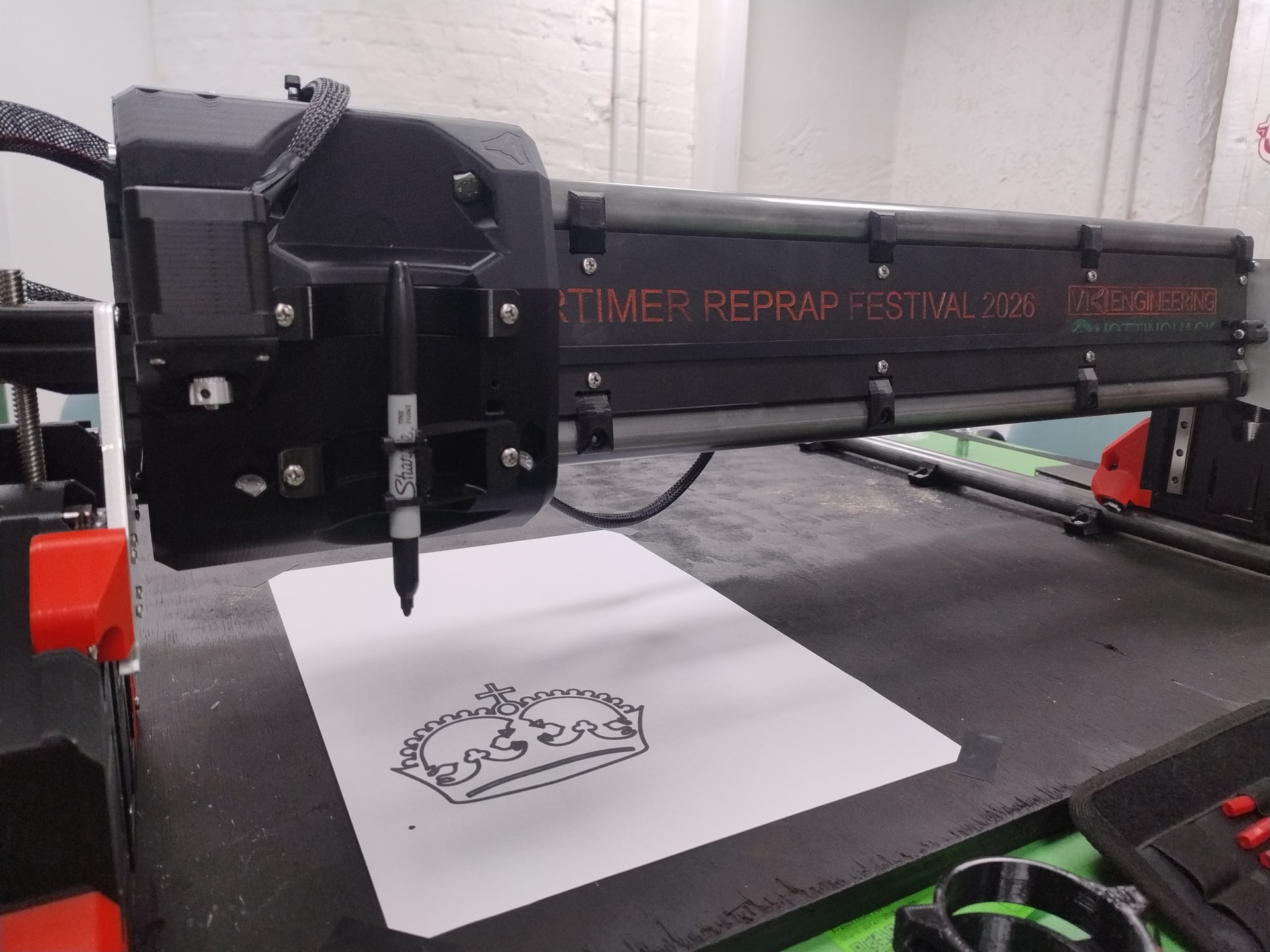

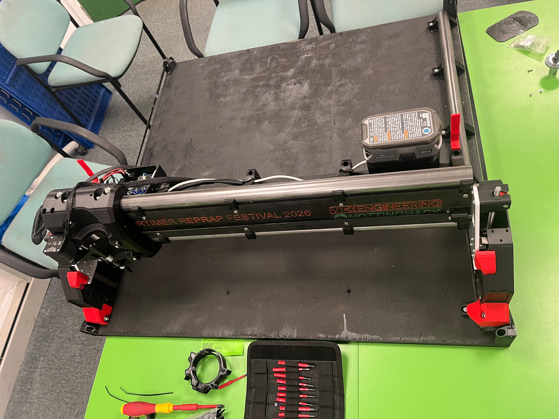

Battery powered LR4 is alive! Ready to draw a crown…

We’ve made it to Manchester, the LR4 goes onto the show floor early tomorrow morning.
Is anyone able to take that DXF Chris posted and export a plot?
Machine works beautifully.
How big do you want it?
