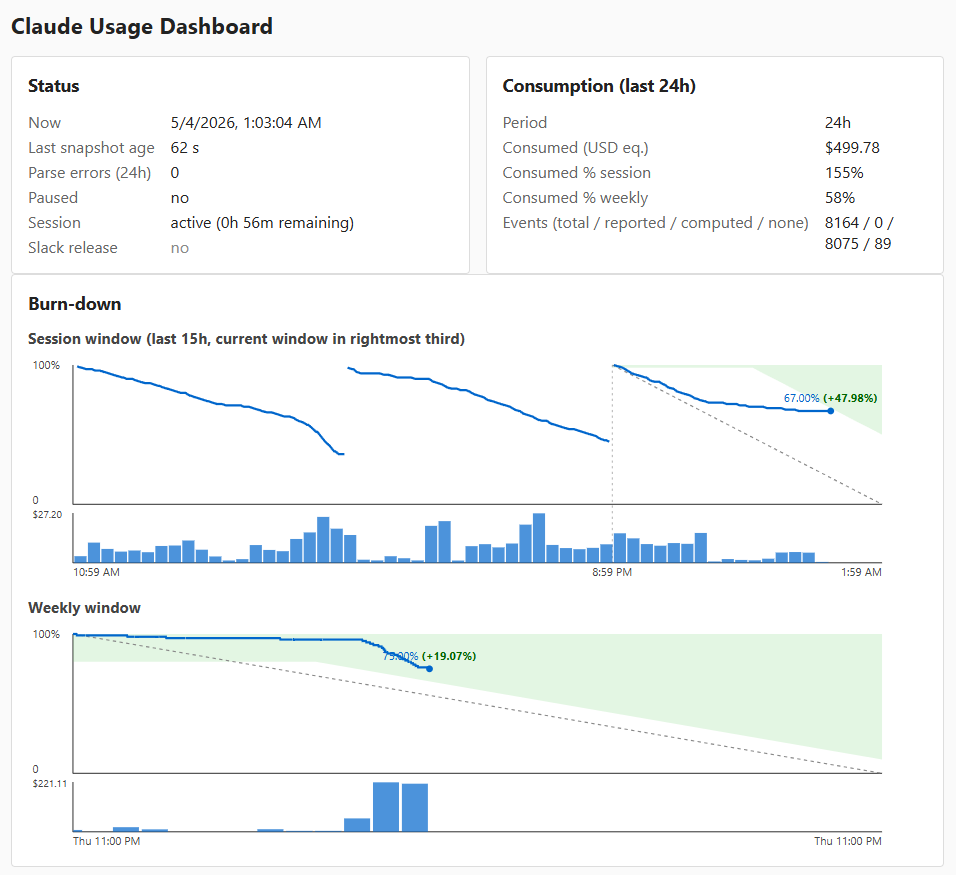

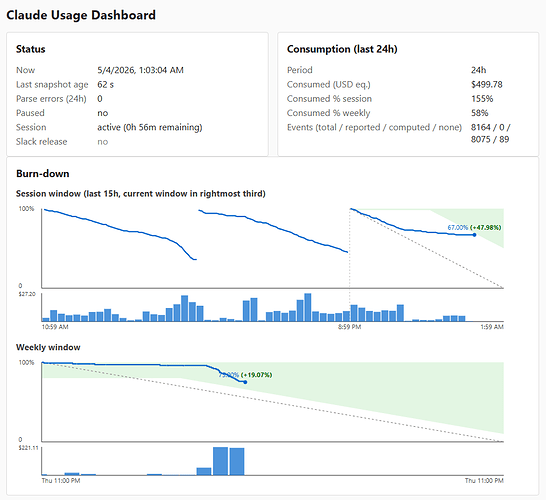

About a week ago I built a dashboard (https://github.com/vector76/cc_usage_dashboard) to track my Claude Max (20x) usage against my allowance, and according to that, I burned about $500 in VC money (most, but not all of that was spent on the sand simulator). The $200 per month subscription gets you what would be approximately $2000 in credits if you were paying retail API rates.
I have a hard time using all my allowance so I use Opus 4.7 1M context for everything.
And yes I’m using raymond to keep the machine fed. Bit by bit, building on it. Trying to get to the point where it can stand alone instead of needing other supporting tools to be convenient. Raymond is a nice engine but it’s not a nice car at the moment.
By the way the green zones on the charts trigger a ā€œslackā€ mode so if I am under-spending my quota, it could trigger low-priority or low-value tasks to use up the extra allowance before it expires. It works but I haven’t used it yet.

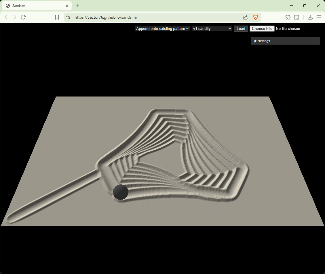

For people that just want to play with it:
I can say this is the coolest, most accurate sand simulator I’ve seen.
It seems to be running in real time. I wonder how fast it can run if it just tries to show the final result?
I haven’t played with it too much. I want to try it with some of the rmrrf patterns we had and compare to the real thing. But it certainly looks a lot more accurate than the lines in sandify.

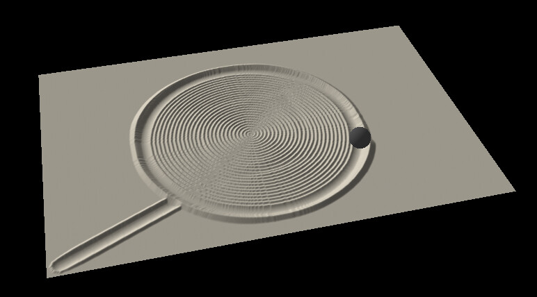

I haven’t tried but a few patterns but one thing I did notice is the ā€˜square’ pattern followed by the spiral pattern basically erases the square, but there is a subtle shadow of where the square had been, similar to how wipes leave a barely perceptible shadow of the previous image. This blew me away when I first saw it.
Yeah. That’s great. I haven’t read the code. Do you know what it is drawing and what it is basically doing to simulate that? Is it doing actual particle physics or some approximation?
It is not simulating individual grains. What I asked for was a radial displacement model with repose relaxation afterward. The ball is segmented into 32 pie slices and for each slice, at each timestep, it computes the displaced volume which is the sand surface above the lower surface of the ball. It then distributes that sand radially outward, filling closer cells first and continuing outward until all the displaced sand is allocated. Then it does repose relaxation which can distribute the sand further out. The total volume is conserved.
At least, that’s the idea. A relatively simple kernel that leads to surprisingly accurate result. I haven’t read the code either. :grimacing:
The AI wanted to start with a simpler displace-sideways model first, then add ā€œbow-waveā€ calculation afterward. But the specific behaviors seemed dumb and I figured they would already emerge from a radial-displacement model, which shouldn’t be any more difficult than a displace-sideways hack. So I just went with radial displacement from the outset and it worked out ok.

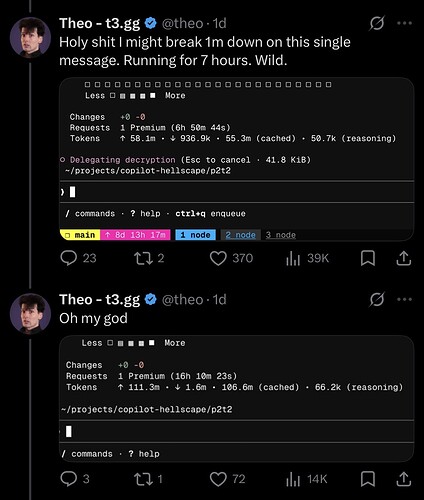

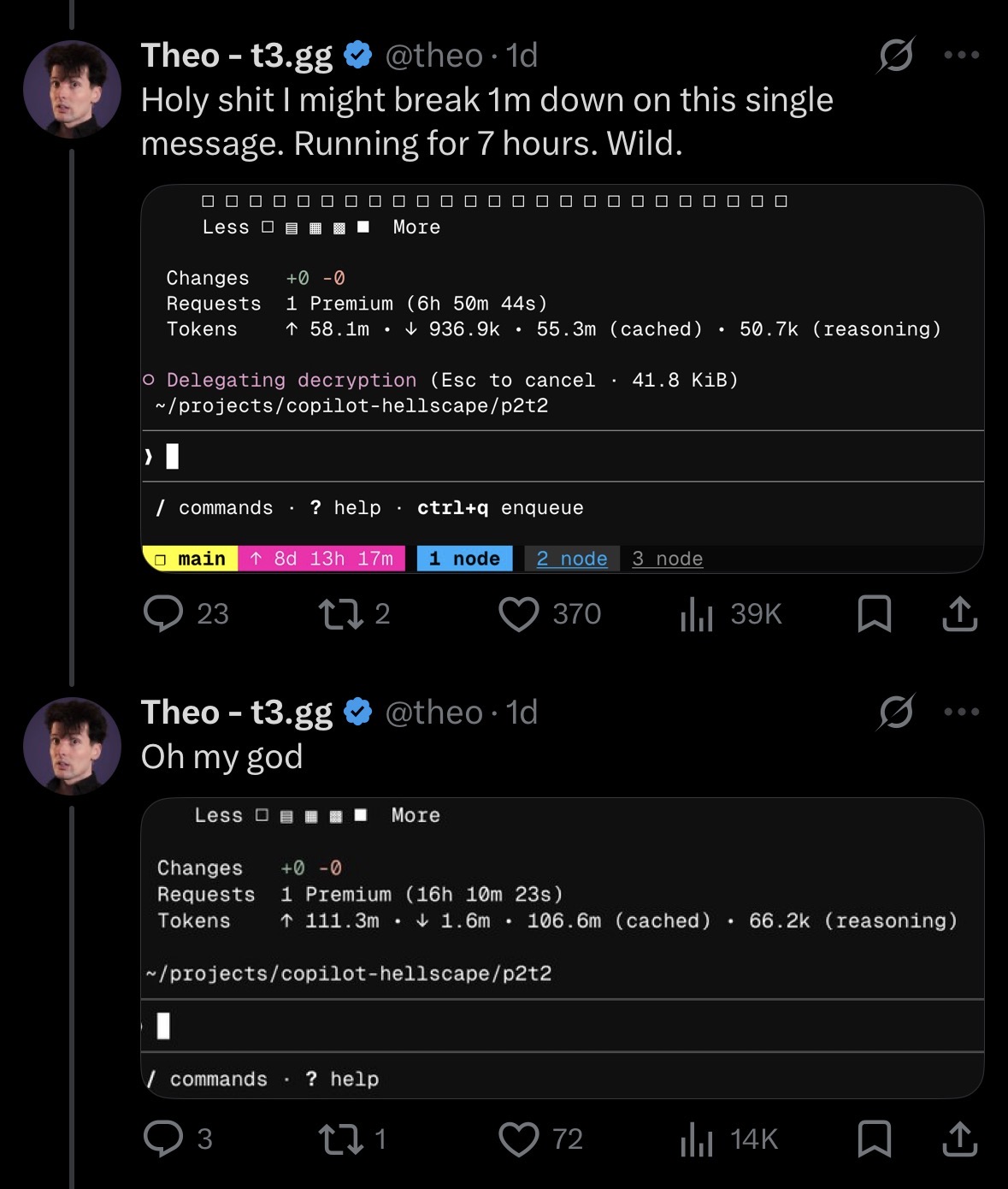

This guy is killing it on the tokens per request ratio lol
https://x.com/theo/status/2051218167780041147?s=46&t=r2unVE94tGok0mrgjeoXLw
That loud mouth is ruining it for the rest of us that were quietly Request maxxing…
