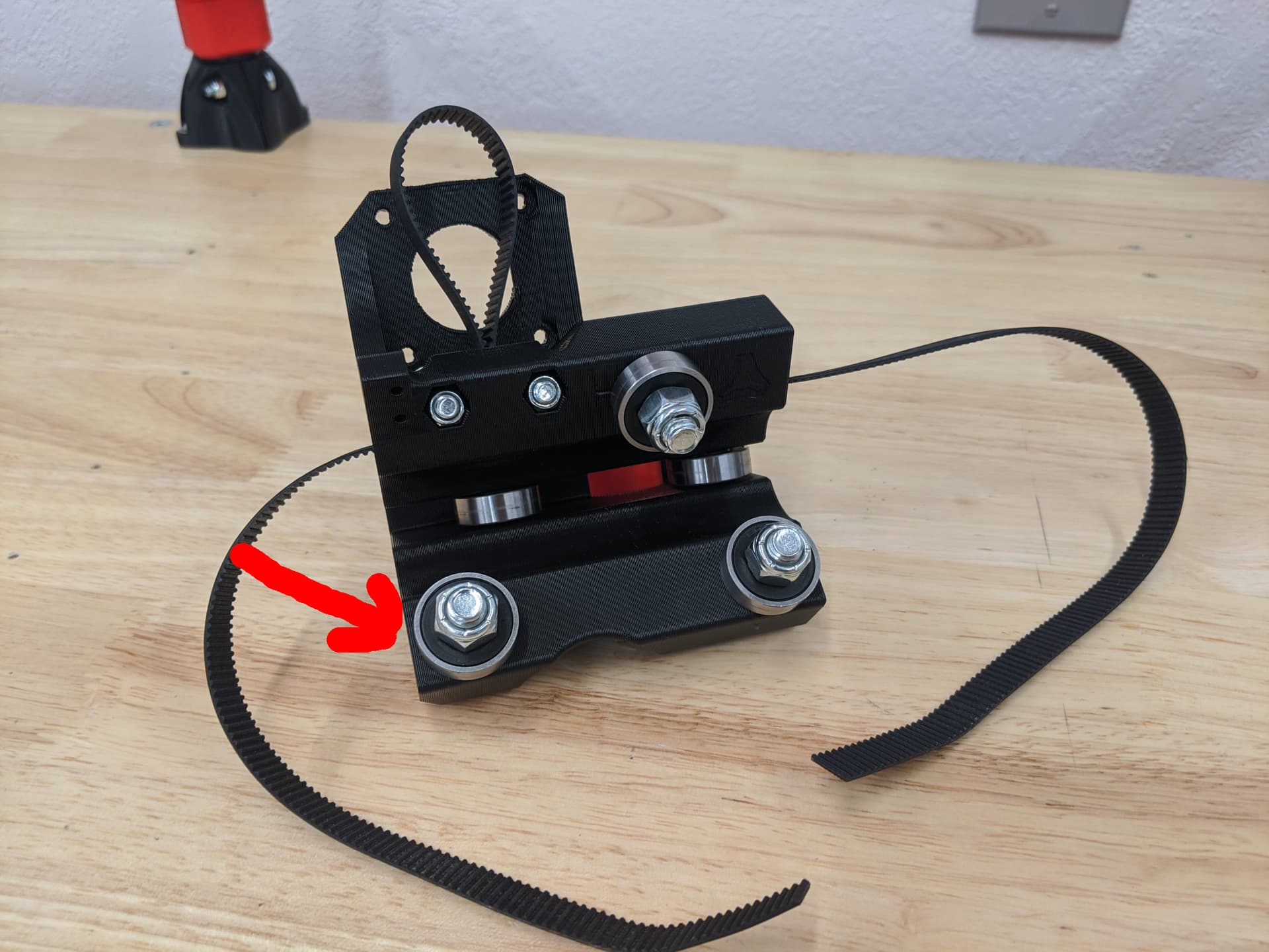

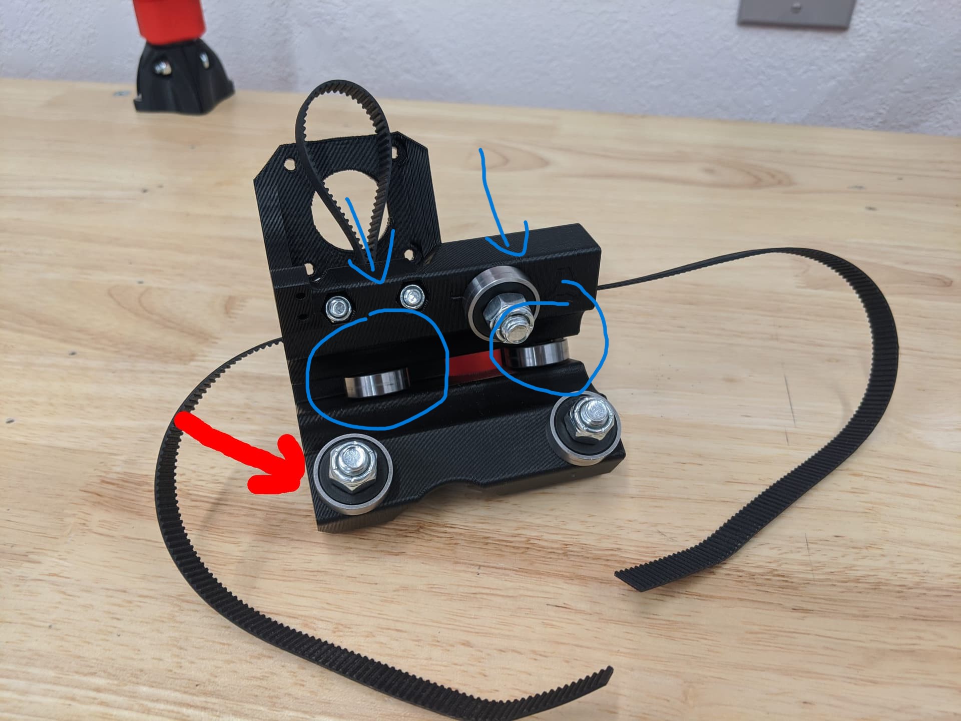

Same Bearing in Trucks not Touching Rails
Both trucks have the same bearing not touching the rails. I point to the bearing in the picture. Tightening their hex nuts did not help.
You have to tighten the nuts with the bearings in the slot. Those pull the sides together. :slight_smile:
carefully
Thank you!!
