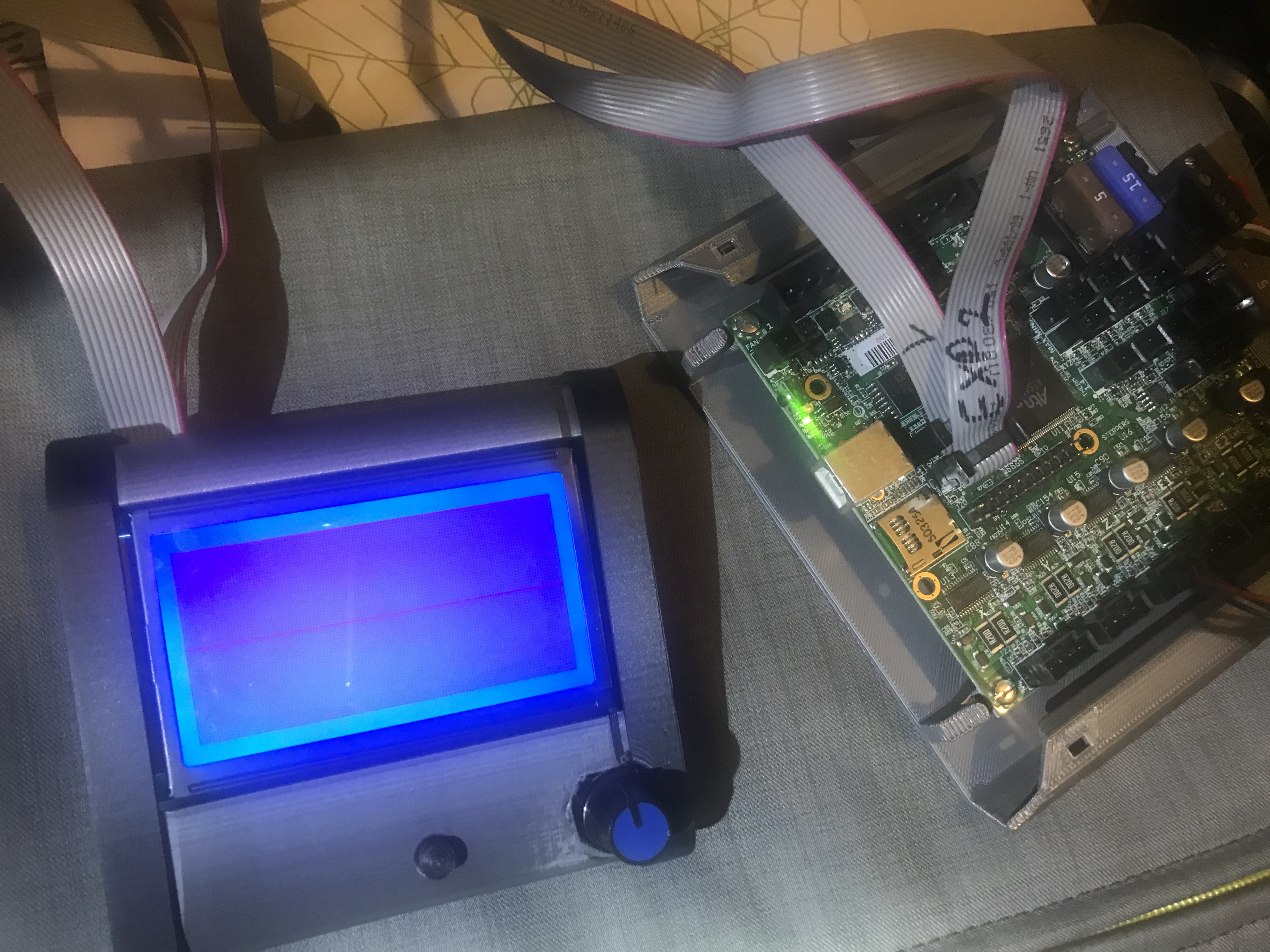

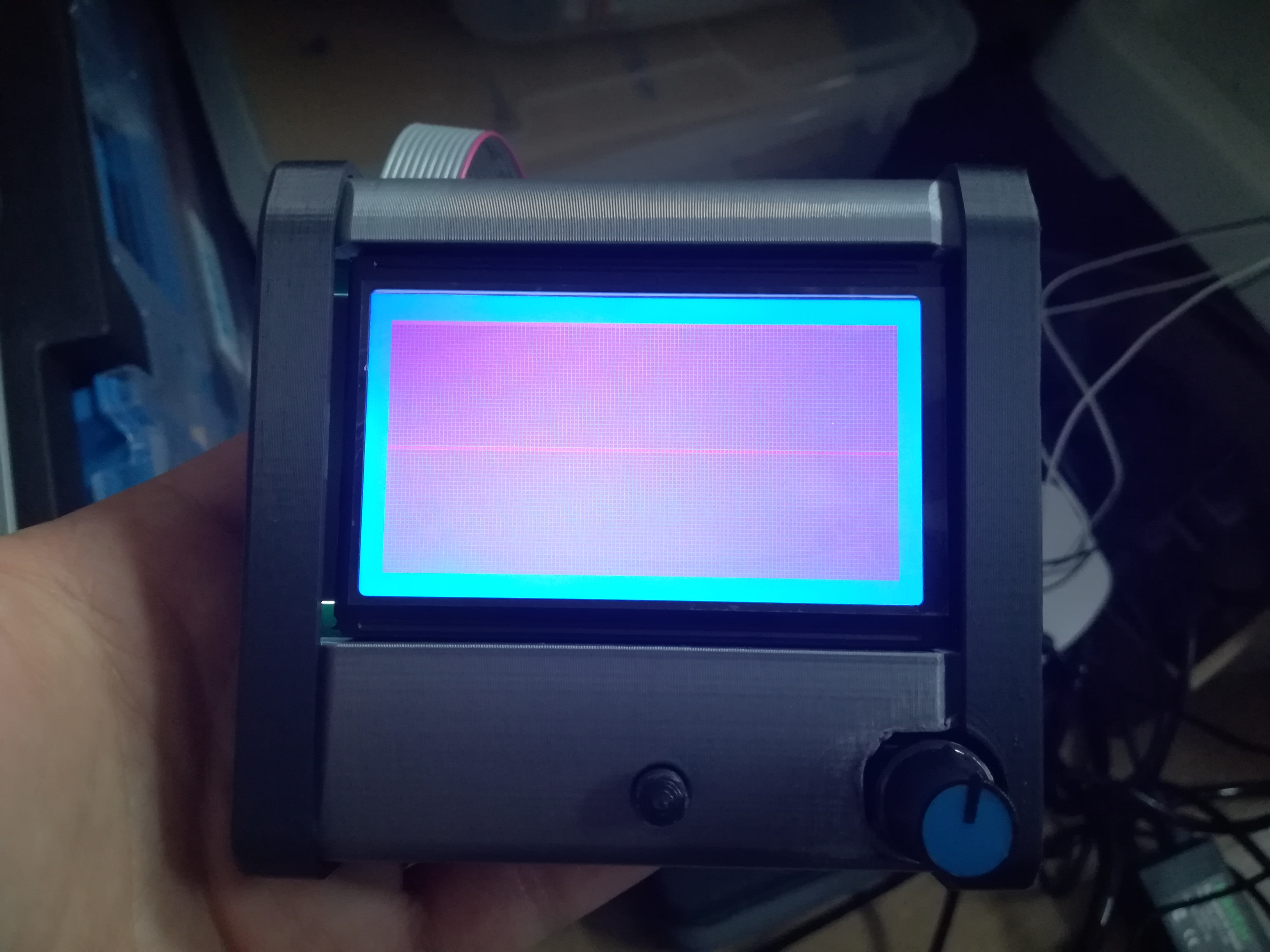

So, as I continue my transition from the Rambo 1.3 to the Archim, I have another issue… at that is with the LCD. It is plugged in, it lights up, but nothig is displayed…
I tried looking around if other people had such issues, and I did not find an answer.
Any suggestions?
Thanks a lot!
You should be able to face the LCD plugs on the archim the other direction, same port.
Sorry, what do you mean by “to face”?
When I flip the plugs 180 degrees, the screen does not turn on, if that is what you mean?
Thanks
Yeah, if the ports are correct there should only be two options, and both should face the same way.

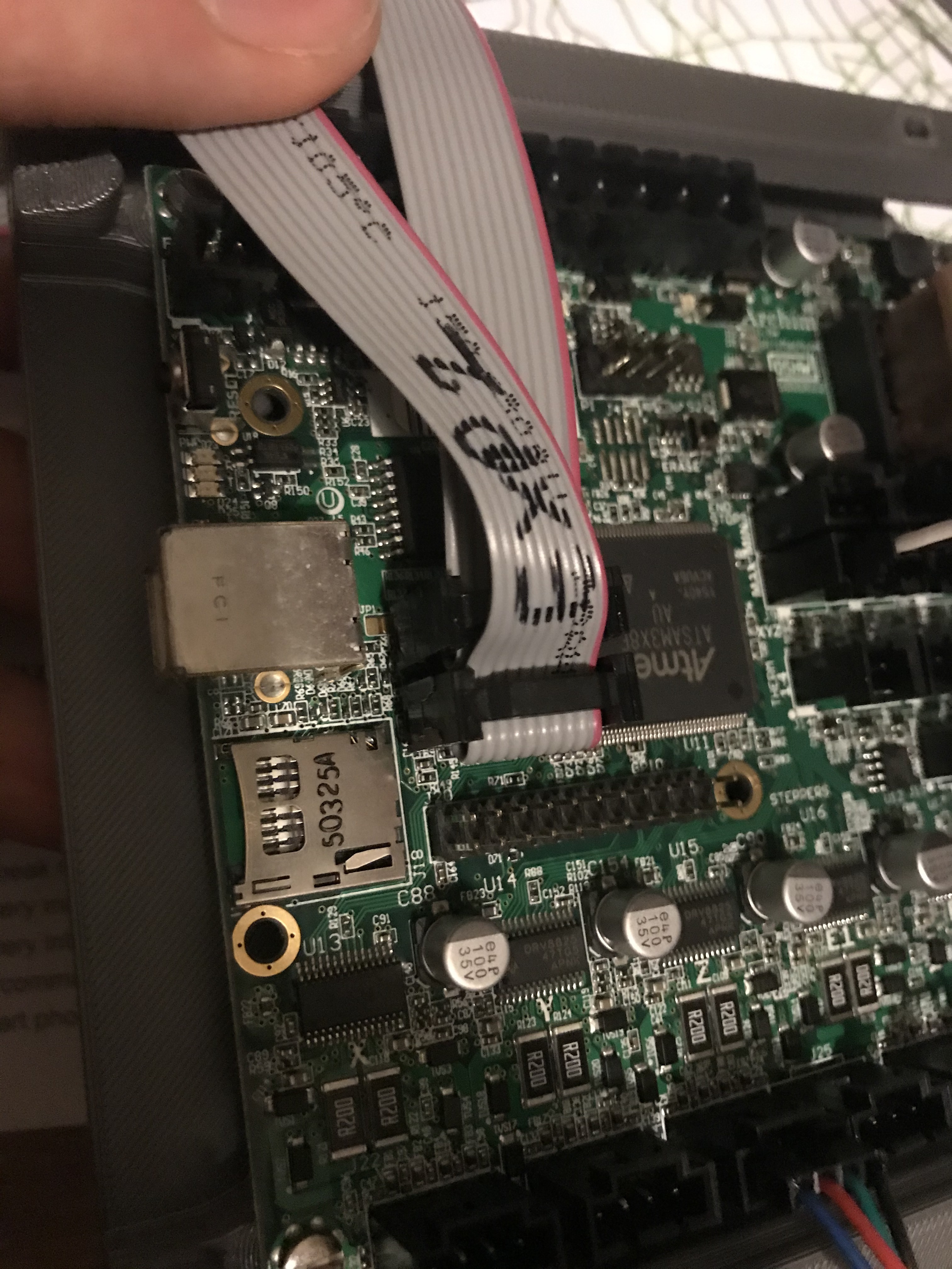

Yes, so this is how they are plugged. And this is the situation that corresponds to the picture from my previous post, when the LCD lights up, but I only see the pixels. When I flip both plugs 180 degrees, the LCD does not power up.

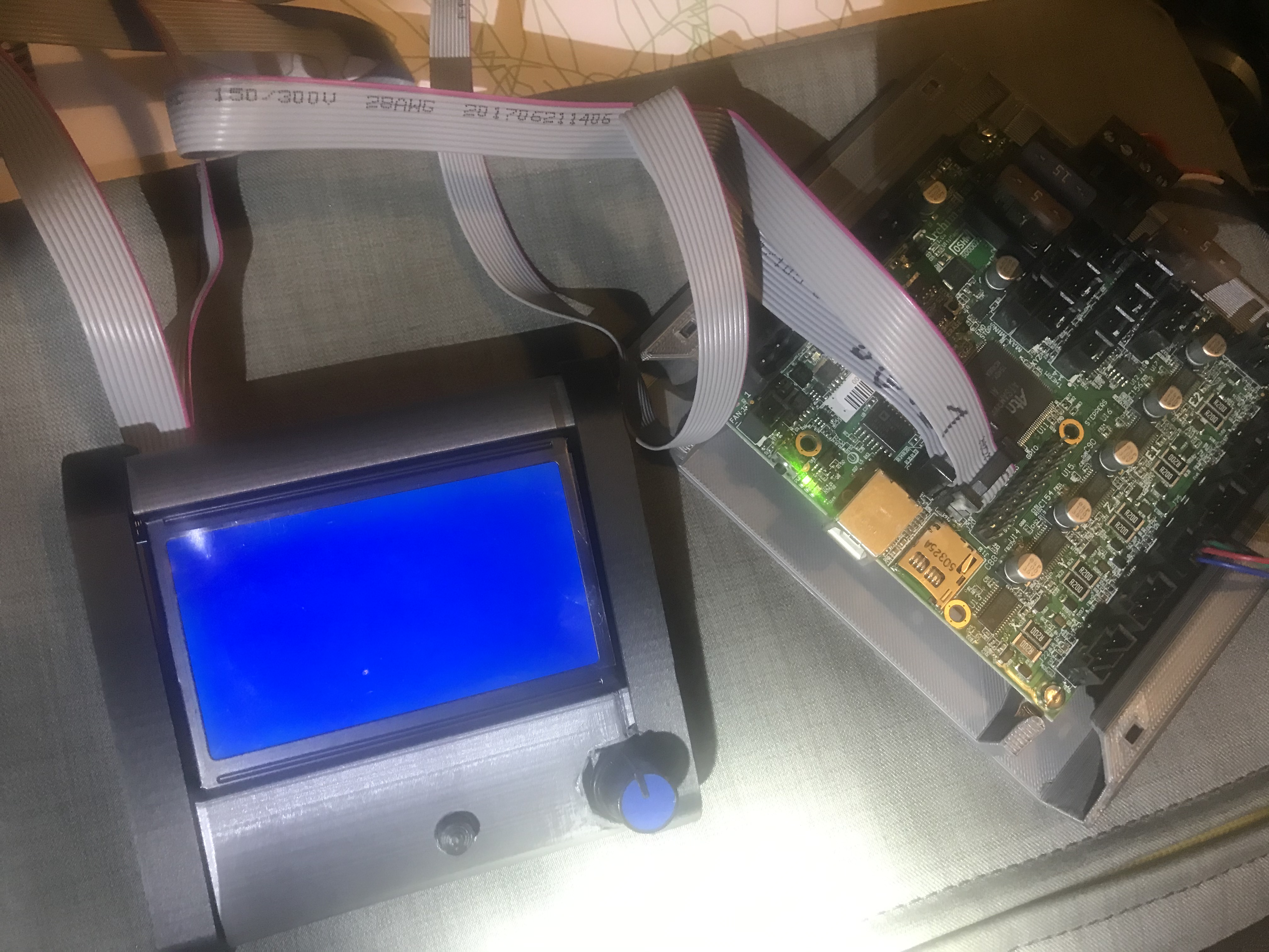

Another thing I tried is flipping screen one and two plugs, while keeping them facing the same way as on this picture. Then the screen lights up as well, but I do not see the pixels, only the back light.

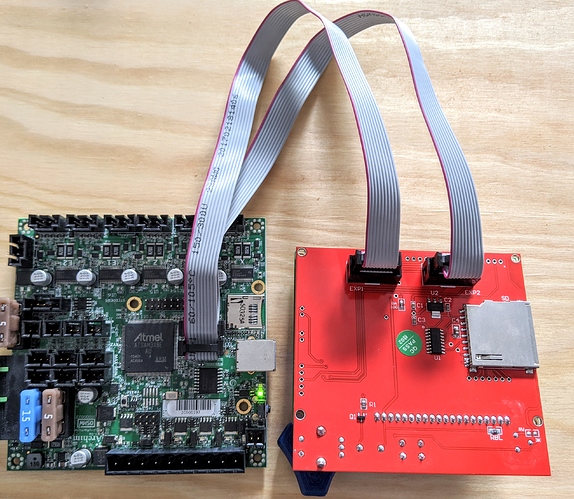

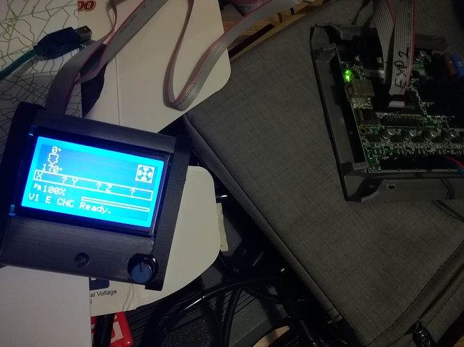

Can you show a picture of both at the same time. I will plug in and flash one and compare pictures, and update the instructions.
So, here are the two situations.
The first picture is how it should be, I believe. You can see the pixels.
The second picture I inverted the connectors. You can see that only the blue back light is on.
On my Archim setup, I have the connectors on the LCD panel with the red closer to the edge, not pointing to the middle of the board. The control board ribbon on yours is as I have mine, with red toward the center of the board. It was a bit of a muddle figuring it out because the diagrams and schematics aren’t evident to me. I also have the plug that goes into EXP2 on the LCD plugged into the slot closer to the stepper drivers on the control board. It was not as the schematic would dictate or that I could read.

I found the issue. Line 1870 of the dual archim version need to get un-commented.
Fixed it, you can re-download and flash it now. Tested and verified.
You rock Ryan!! Thanks a lot!
