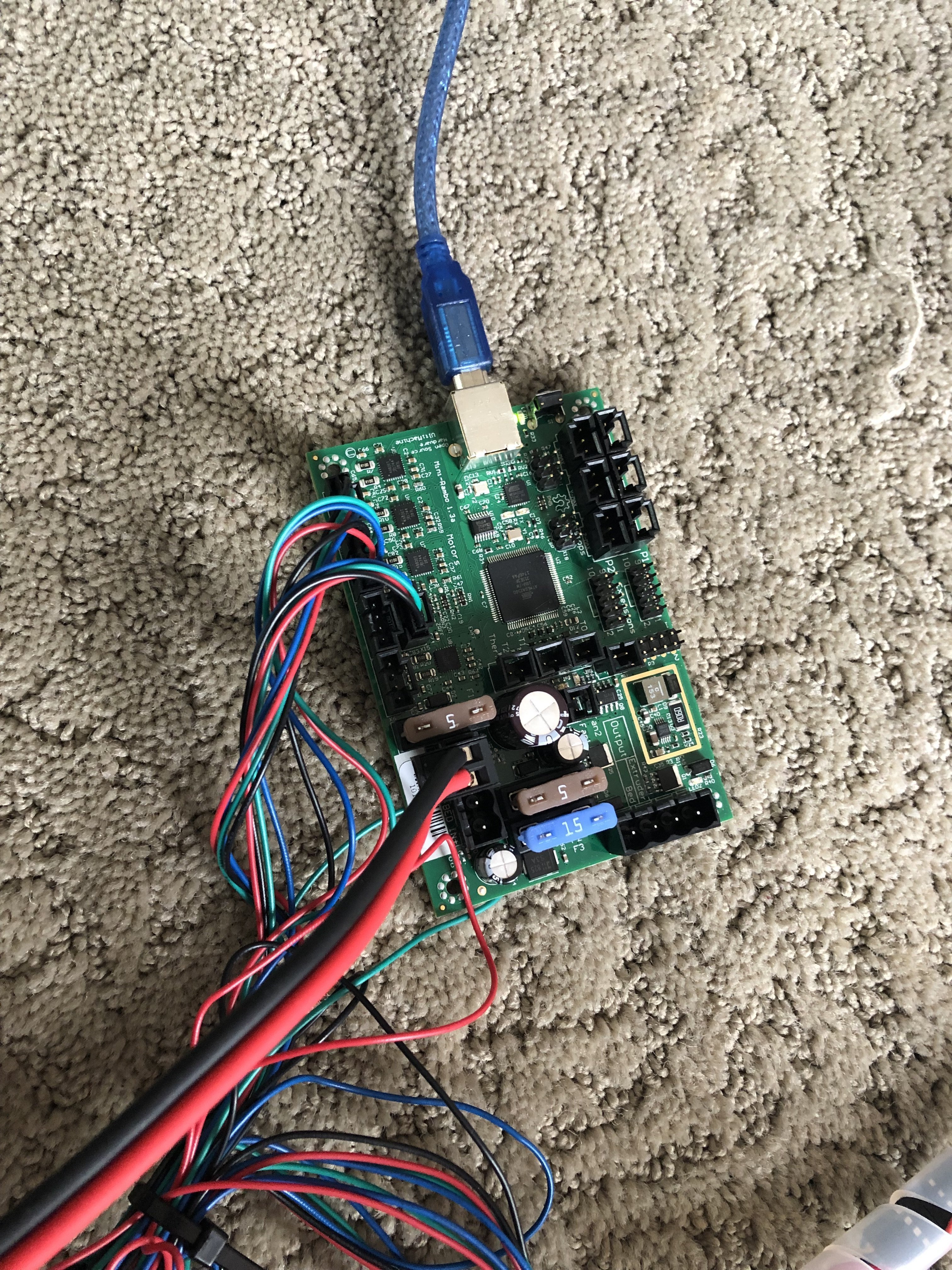

Ok rebuild z axis everything correct now but now will not run in manual either tried different motors in z port nothing do you think we shorted port or something is there a way to reset the board?
Did you ever unplug the stepper while it was energized?
yes once when I took the z axis apart. I guess that is a no no.
Yes, it is. Nothing should be plugged or unplugged from a live board. Typically the board can handle it, but I don’t know of any other way you could have killed it. You have a second Z port or the firmware can be manipulated to swap to an open port as well.
Try re-flashing the board first. if that doesn’t work we can try the other options that take more work.
I flashed the board same issue. You mentioned other z ports do I have to change the firmware to get that to work?
Just swap the pins number for Z and E0 in SRC/PINS/Pins_MiniRambo.h

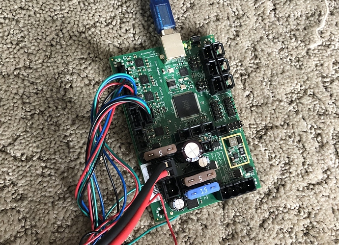

Swapped the Z and EO! Z now works in Manual but when we hit x both x and y move and when we hit y both x and y move?
Any chance of static from your carpet killing the board?

I had a old hictop board laying around so used it everything works in manual and still does same thing as before moves z up goes to starting point and starts to move z back down stops and motor hums but does not move In manual moves completely free up and down. Think it is a setting in rep. host or something?
