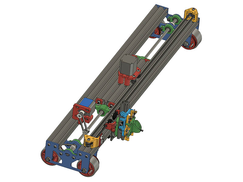

I put this design away for a while & am considering going further down this rabbit hole using one motor for both sets of wheels with a connecting M8 smooth rod between them. I had been thinking about doing something like this for a while & after seeing this belted Z-axis design I could see how to do it. GitHub - kevinakasam/BeltDrivenEnder3: All parts including Voron files for the Belt Driven Ender 3 V3
My biggest problem was being able to adjust the belt for the motor to M8 rod & also be able to adjust the belt between the M8 rod & wheels. Looks like this should work. I won’t have to reprint the wheels at least. I might have to adjust the offsets a little bit more. I am also going back to the O-ring wheels as those worked the best for me & since the wheels are supported on both sides now, I added as many as would fit (6 on each wheel). Here is what I have so far. The parts in green can slide 3mm each way & have skate bearing in each of them.
Think I have it adjusted for all the parts to fit. I had to order another closed loop timing belt. Shortest I have is 188 & it needed to be in 148-152mm range. 148 is what I calculated, but when I drew all the teeth in the belt, comes out closer to 152. I ordered 146, 148, 150 & 152mm lengths. One of those should fit. I had to change the wheel spacing from 110mm to 115mm for the wheel belt to fit. I changed the 2060 brackets to 2 parts on each side with a T-nut connecting to the 2040s underneath. Maybe I will have the new parts printed by the time the new belt comes in.
I finally have all the new parts printed & the hardware from China. Sometime soon, I should be able to put this new design together. The main thing I changed since the last assembly image shown was to cut out the outside bottom T-Nut connections on the 2 main plates. Looks like it should have enough support with the wheel bolt & the back plate that screws into the ends of the 2040. That should give me an extra 25mm width of travel which looks like 24" width with 800mm 2040s. I also changed the 2 top yellow idler pulley mounts to mount to the ends of the V-slots. I spent a few days last week tuning my printer to get more accurate prints & switched back to klipper firmware to mostly be able to use input shaper. That did make a difference. I am now mostly printing at 80mm/sec up from my 50-60mms. I see the latest version of Marlin is starting to use input shaping but will wait on that for a while. I did the manual input shaping & didn’t use the ADXL345 board. I am starting to think about playing with tire treads as an option replacement for the o-rings. I have done a coupld of those designs but looking for some other ideas. Anyone have some links to something like tire tread design?

I am starting to assemble today. I am going to change wheel plates a little more to have bigger inner slot for bearing. It does not bind when tightened but seems like the slot should be a little bigger to keep it from possibly binding. I am connecting the back plate on the sides rather than using tapped hole which cuts down on the number of tapped holes. I did tap one of the 2040s on both sides to attach the idler mounts to the ends.

I got this new version mostly assembled yesterday. Since I had to get a 1-meter long M8 smooth rod, I decided to go ahead and make the plotter 1-meter in width. The 1-meter rod is a little shy of 1-meter, so am making some 7mm width spacers to add between the back plate & outside bearing plates. That seemed to be the simplest way to do it. I thought getting that long m8 rod would be a problem getting lined up properly, but using a simple 3d printed shim 26mm wide while tightening each bearing position made it quite easy. I did have a little bit of forethought & put the wheel locknuts to the outside to make it easier to change the O-ring tires to TPU or replace the O-rings down the road. I also changing the F625 bearings to these bearings. https://www.aliexpress.us/item/2251832664674464.html They seem to be a better quality than the original ones I was using.
