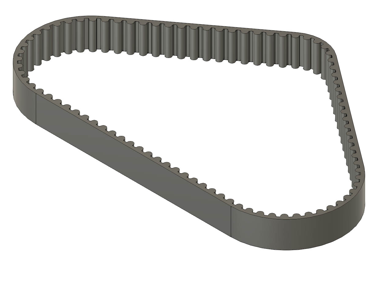

Not sure I calculated this belt length correctly but can fix it if I am in error by shortening the wheel spacing from 120mm to 110mm. I was using the inside dimension of the belt for the length & looks like it should be the pitch diameter. The length comes out to about 453 using the pitch diameter & my current spacing. I discovered this problem after modeling the 440mm belt length as it fit on this machine.
I initially drew each tooth in a sketch copying them along the straight lines & pulling the arced ones from the other 2 models I had already drawn. The ends did not come out quite right. On my 2nd approach, which was a lot easier, I realized my problem was not using the Pitch diameter. I found the fusion 360 command to copy a body along a path.
The length of the belt along the Pitch length is 439.9897mm. Close as I could get it to 440 by just a little trial and error of adjusting the top idler location.
Here are screen shots showing my method for drawing the belt.
Draw one tooth at the start of the bottom straight line.
Extrude it up 15mm which is the width of my belt.
Create a Pattern along a path (pitch sketch line). I had to play with this command some. Initially setting Distance type to extent & typing in 440. Then change it back to Spacing. The Quantity option did not show up until I did it this way. I used 5mm for distance and 88 for quantity since this has 88 teeth (88 * 5mm =440mm).
I extruded the outer ring of the belt to fill in the gaps of the 88 teeth. I added wider than needed initially because it had some artifacts along the curves otherwise
I then cut the outside of the belt to correct width.
Here is the finished belt
Here is my belt drawn along the pitch line with the dimensions I used. With only a little more trial and error, I changed the idler offset to 56.989 mm which gave me 440.0004mm length.

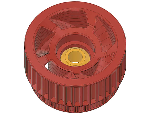

I initially had these wheels cut with a profile revolved 54 degrees & then repeated 5 times around the wheel which works pretty well, but I wanted them to have a little more character. Having the cutout spiral down seemed like a good choice to work with. I am using Fusion 360 for this & first tried lofting the bottom to the top with a 72-degree (360 /5) difference between them but could not get a rail guide to work along that curved angle. I then came up with the idea to use my original cut profile & slice it every 3mm high (10 layers total) & copy that cut to another sketch & rotate each level in 7.2 degrees increments. I was then able to loft each 2 sketches that were 3mm Z difference & 7.2-degree rotational difference. It was not too much trouble & think it came out pretty good. Seems like it should give it better structure as well.
I had to increase the GT2 drive tooth count on the wheels from 80T to 84T. I am also trying 85T since the motor is close to far end of center tightened. I am not sure why the calculations did not work for that, but easy enough to adjust for at this point (I did use the pitch diameters for the calcs). This makes me wonder if the HTD5 track belt is calculated correctly. I will not print anymore until I test fit that belt when it comes in.
