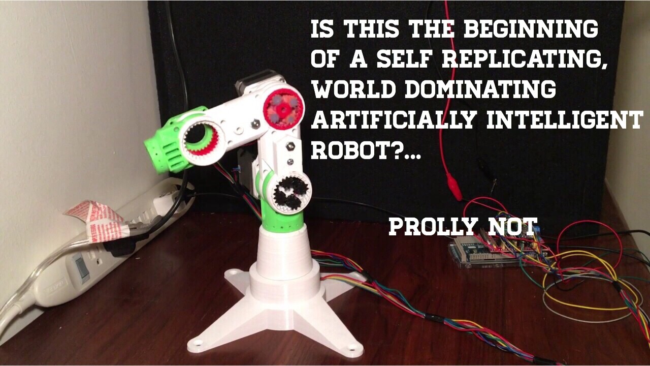

This is one of those things to build to learn how the robotic control system works. If it really could be built for $400… assuming you buy the $300 hardware kit, the $50 print files, enough PLA or PETG to print it, a controller would still be required… though it looks like they use the mega 2560 and some add-on drivers for steppers.
one thing from their FAQ site with the drawings:

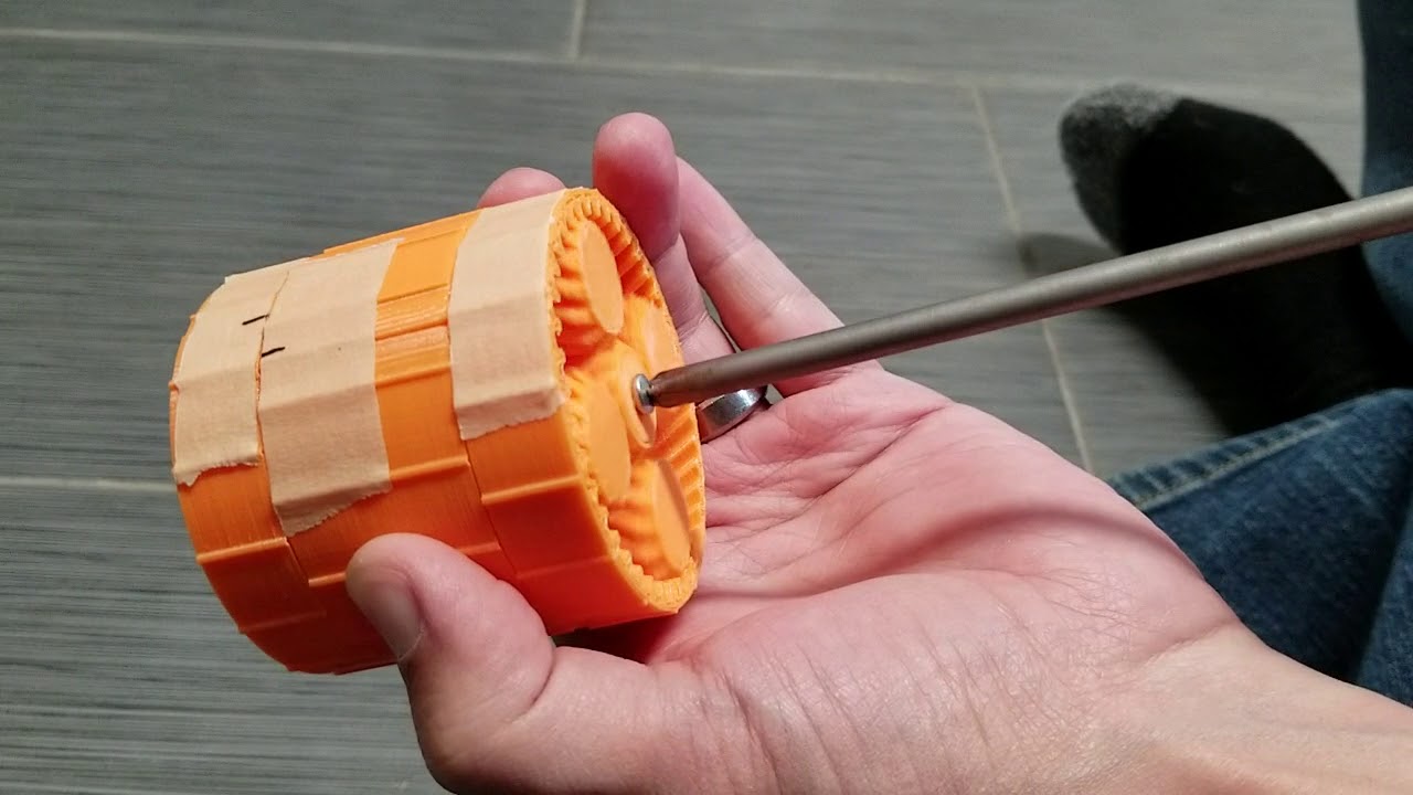

This is my current interest: Open Source Cycloidal Actuator with NEMA17 | Details | Hackaday.io. At 25:1 even a lowly Nema 17 becomes a beast I wonder how much weight the PLA could take before deforming?
ok, now that is pretty amazing! After seeing how that was built, I think I get it. The mechanics on that are very cool.

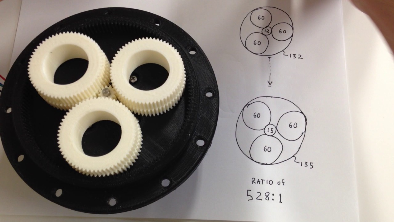

Still playing with gear ideas. Stumbled across this guy, the Split Ring Compound Planet Epicyclic Gear
His design isn’t refined for use but 528:1 reduction in a 2 inch tall package is impressive. The second stage uses the alternate output on the planetary gearset (outside ring) as the output.

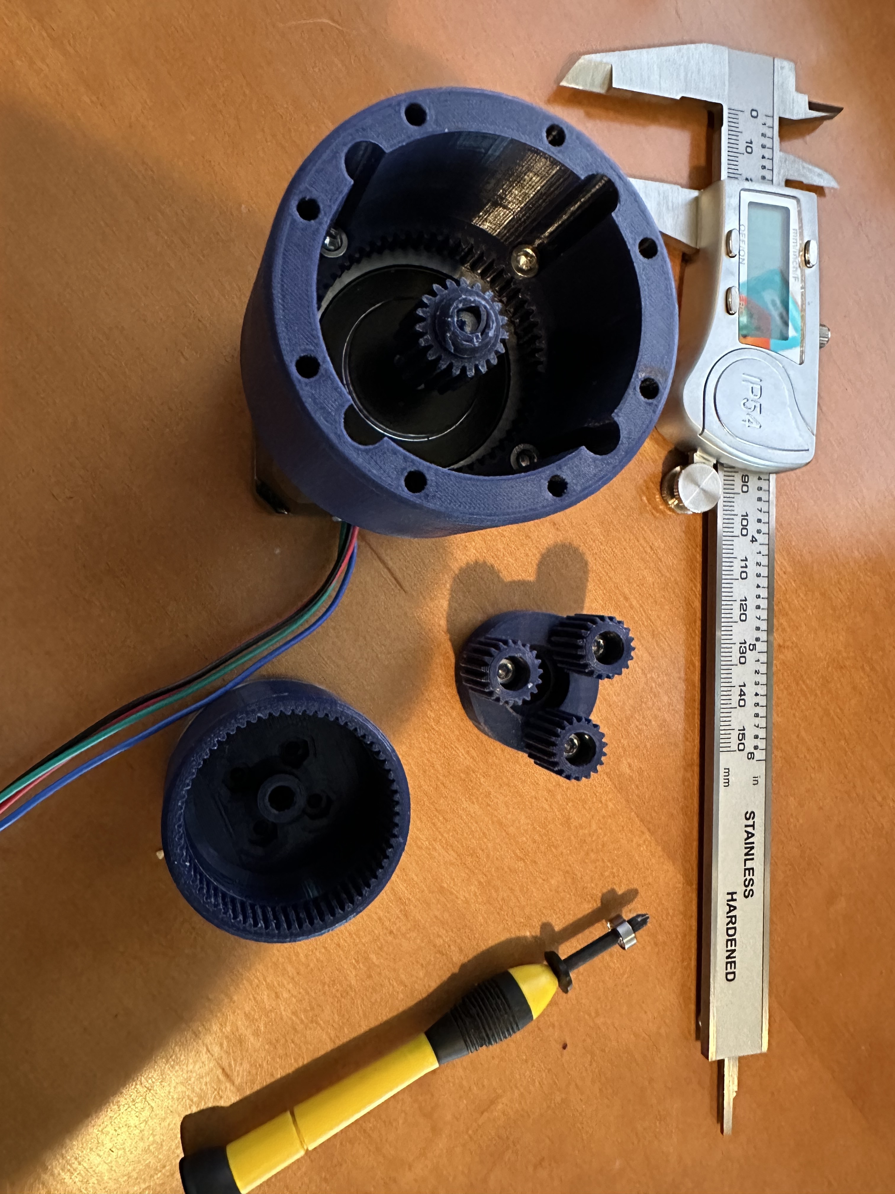

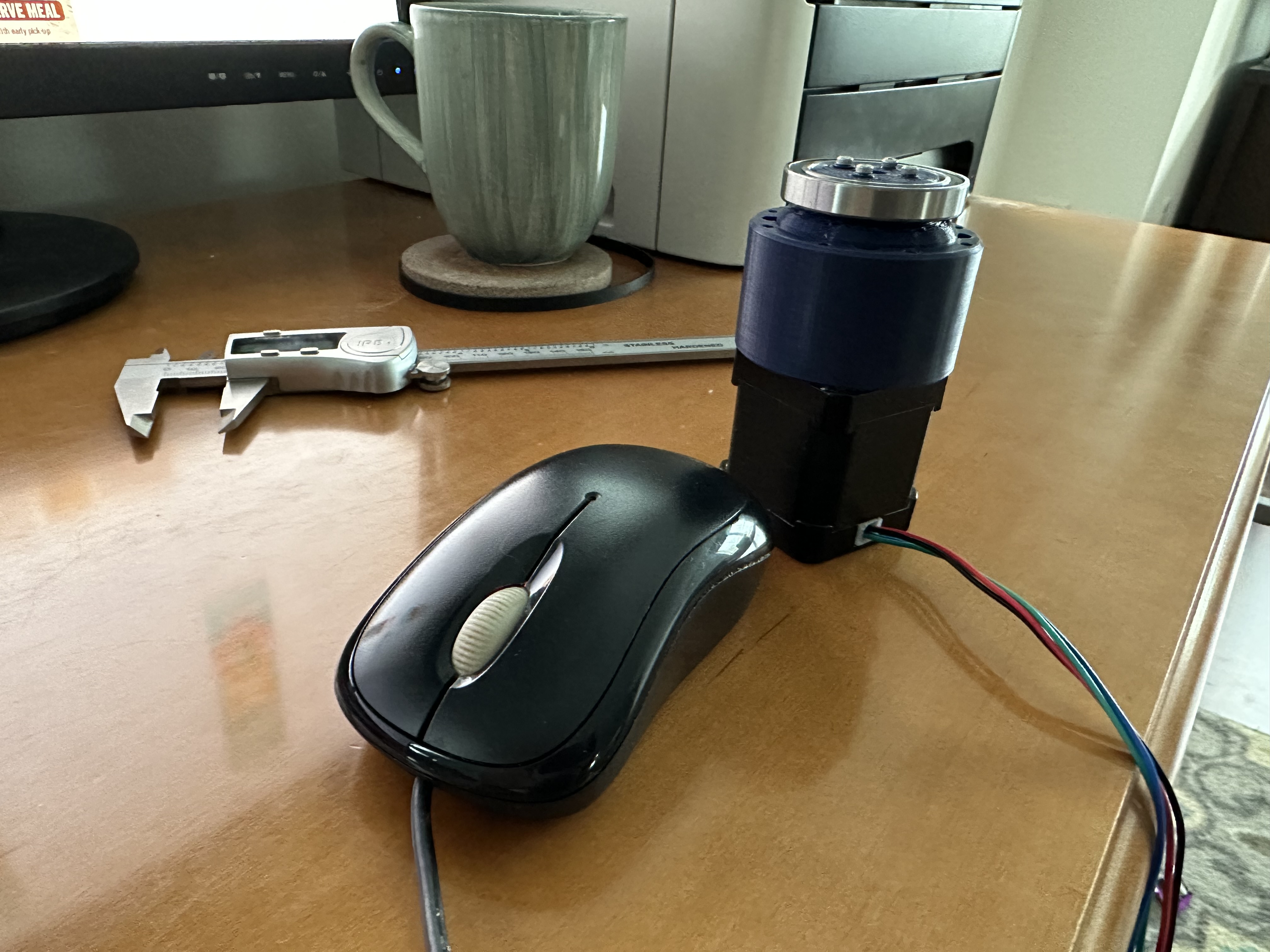

I ended up printing a compound planetary gearbox just to test… the gears were a bit finicky and had to tweak print sizes but it’s suprisingly solid with zero backlash so far.
Gearset gives me 80:1 with around 18rpm from a nema 17 with 12v 1amp power supply. Not to shabby for spare parts and some plastic. Waiting on an odd sized bearing to arrive before I can test load.
