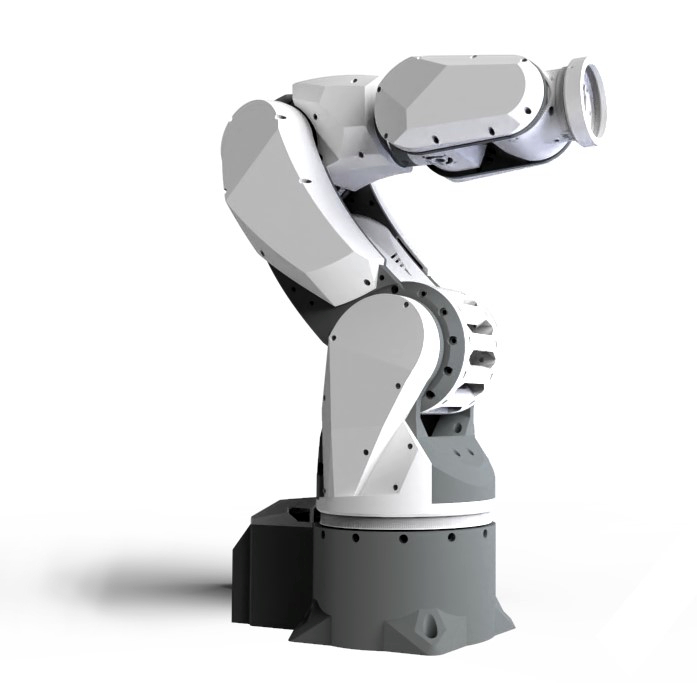

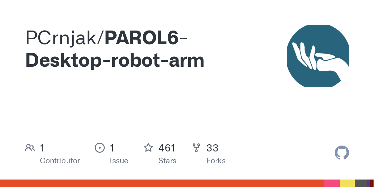

So I just saw this and it looks amazing. Thought of this post right away!
https://www.printables.com/model/584932-parol6-3d-printed-desktop-robotic-arm
It is printed, but it looks like they have everything, inluding software on their github.
The PAROL6 looks great, no makes yet though?
EDIT: Do you have any good use-cases for a robotic arm?
