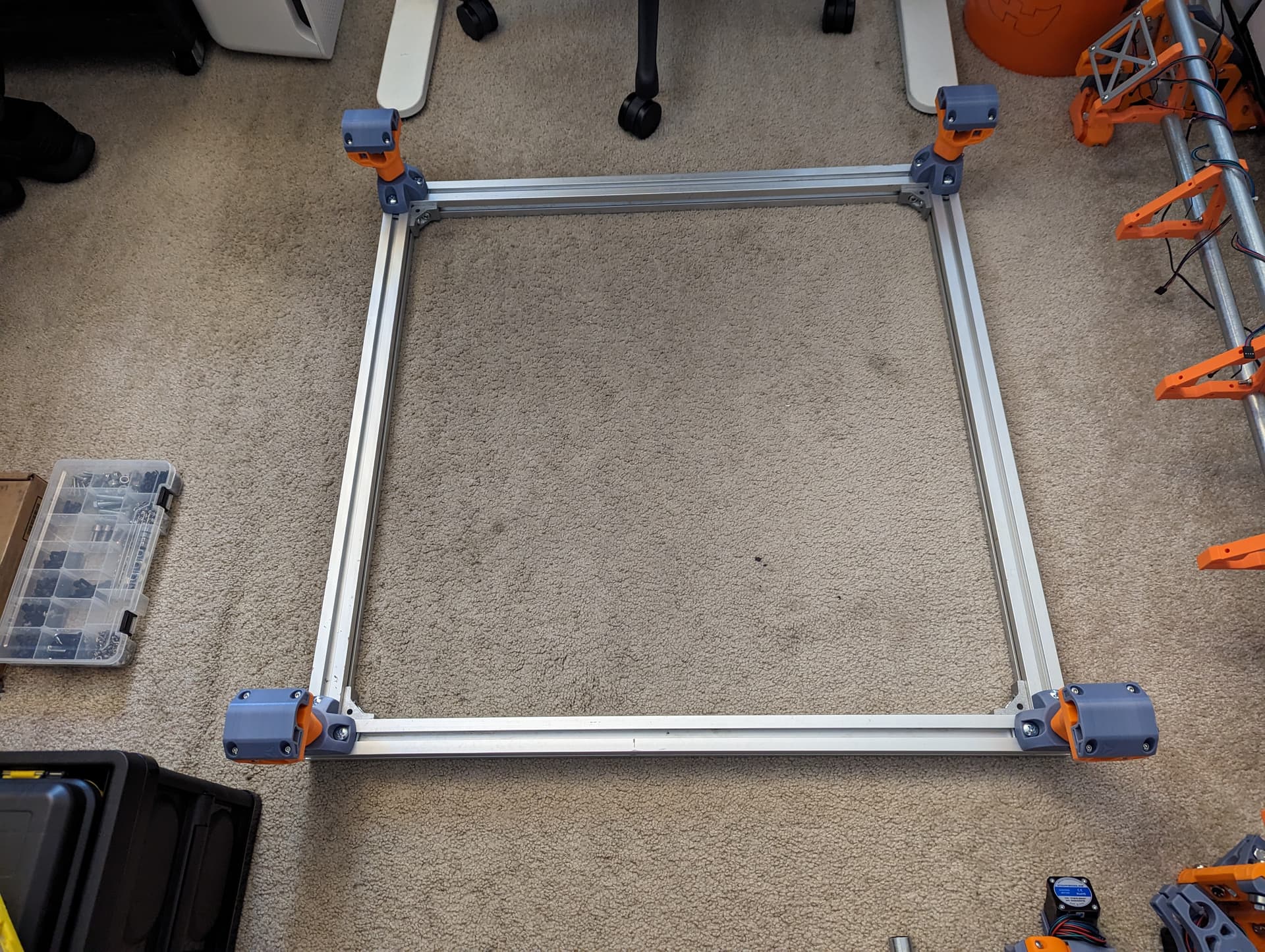

I love it when the math just works out. I had already cut the feet rails from a leftover length from my side project. The remaining parts fit cleanly in 2 x 10-ft lengths.
So far so good. Just need to drill the Z rails and I can button this bad boy up.
Well, that was a bit of a pain. My holes are not centered because I’m bad at these things so I opted for enlarged holes to compensate. I learned 2 things. 1, I need a drill press. 2, I need a small warehouse for my new drill press, Primo, and Lowrider.

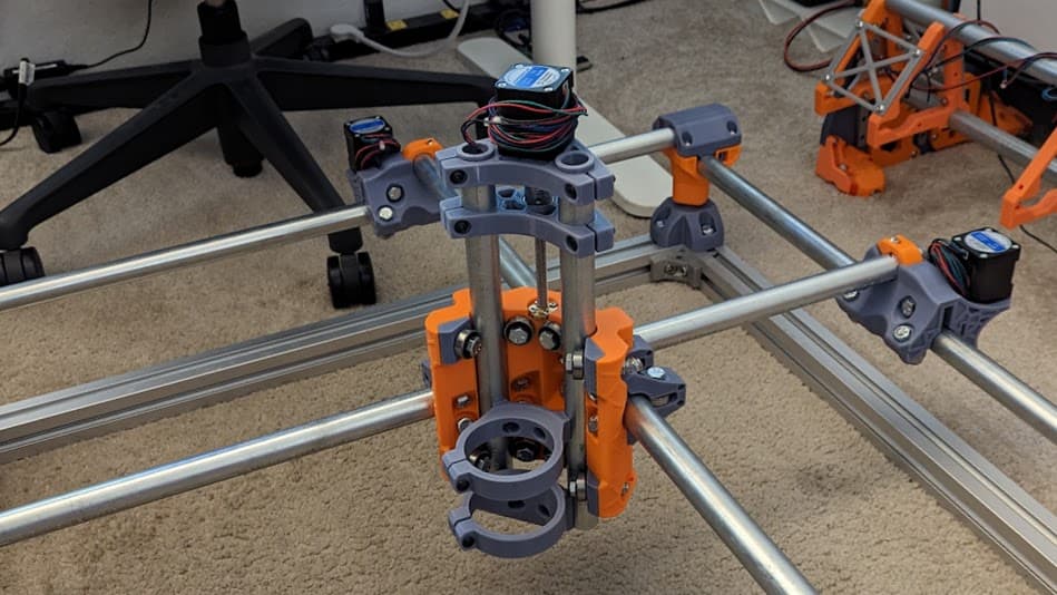

I installed the belts this morning before work. It’s feeling much more solid now. Next up, wiring. I like the portability of the 4040 base. I think I’ll build a control box that is easily removable or maybe install it in the back corner where the tool head can not reach.

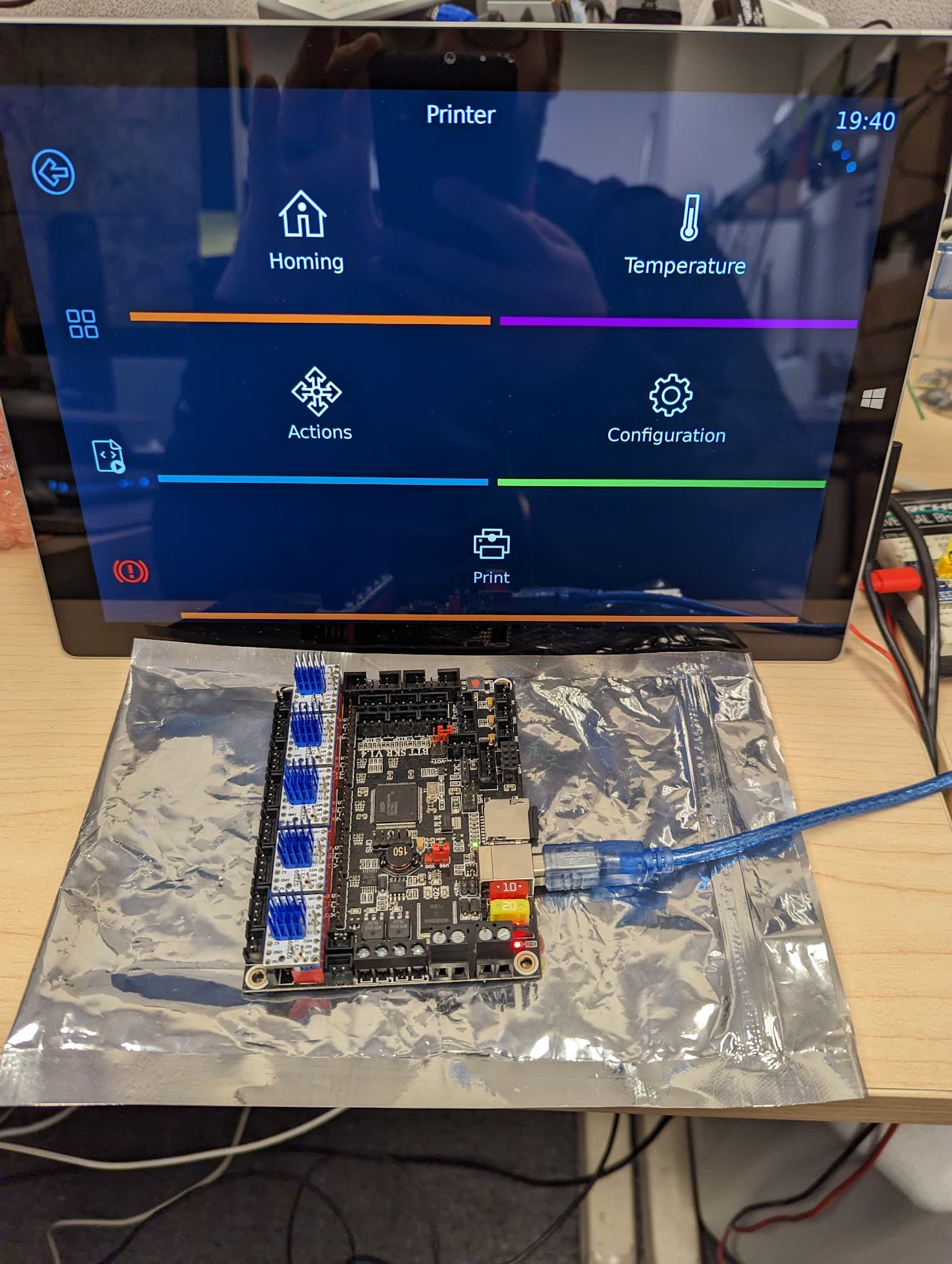

This may be overkill, but I just found an old Microsoft Surface 3 Pro in my “junk” pile (slight hoarder tendencies). Instead of running the BTT Manta M5P, I was thinking of running Linux/Klipper on the Surface and using an old SKR 1.4 I have in the parts bin. I could run all kinds of control interfaces and still have more than enough horsepower to run klipper. Either way, it’s good to have options. :slight_smile:

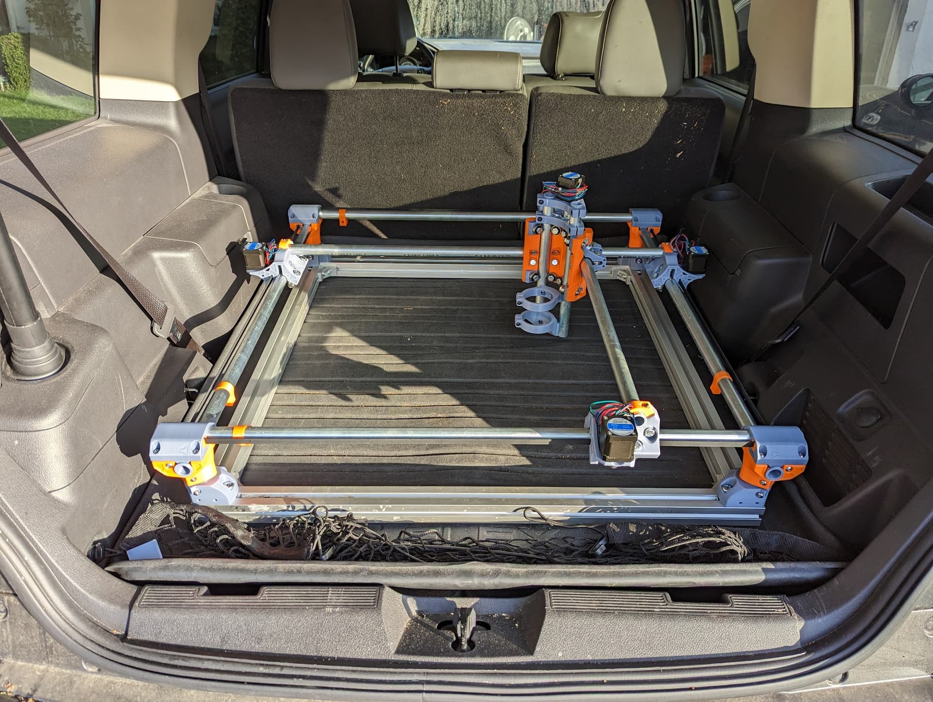

If it fits in the vehicle without disassembly, it’s officially portable. :smiley:
Well, now the obvious thing would be to run it while driving…
There is not a ton of room for the shop vac and the kids. :joy:
