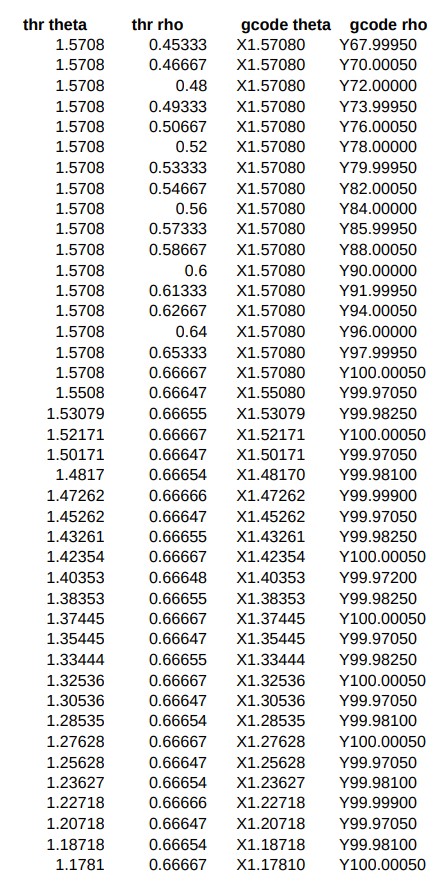

The following spreadsheet shows about 40 lines of a 200 mm diameter circle in a space with a 150 mm max radius. The first 18 lines it’s moving rho to the radius and the remaining it’s sweeping the theta. Notice that when its rotating, the rho values vary in places 4 and 5, going below and above a central value. I wouldn’t think the stepper controller would even show this deviation, but the stutter is there.
The theta values are either monotonically increasing or decreasing, which is what they should do, but I still get a stutter. It almost seems like the motion planner is bringing the stepper to a complete stop, and then doing the next motion.
The other issue is the wide variation is speeds of theta and rho. I think I know why that is happening, but it would mean updating max travel speed on one of them each time certain conditions are met. I would love to know how Sisyphus handles this.
What steps per unit do you have set on X and Y in Marlin? Ideally, those are not too low or too high. Our usual machines are in the 50-200 range and we use 3-4 decimal places. You can play games with marlin because you aren’t exactly using mm. You can change the steps per mm and the precision of your output.
Can you also paste the actual gcode you are sending to the skr?
What microstepping are you using? I would use 16 and the TMC setup has an interpolated microsteps, which I usually leave at the default of 256

I would set a max X and max Y speed and then just use a very high F speed on every move. But you also need to have a reasonable acceleration for the units you use. The steps per unit will be a big clue. I think you are close. You just need some tuning.

The issue I have with varying speed is with it changing significantly within the outer areas. This happens with an ellipse where theta is changing rapidly and rho is almost constant, and the reverse. I have been using a high, constant F, and setting the max X and Y. It seems like I will have to do more post-processing and insert new max values when theta and rho are changing at very different rates. I have messed with the acceleration a little and will continue to do so.
You don’t have to use mm or radians for your machine. You can choose whatever units you want (even make up new ones).
That seems quite high, but a radian is a big number.
I would change that to something easy to understand and in a more sensible range. Degrees would make a lot of sense, actually. That would put your usteps/unit to 46.67 (although redo your math from the rotation, you’ll probably get a better precision number). Then make your script output degrees. That should fix the rounding errors.
Then I would make up a unit for your rho that was about 360 from center to the end. That way, if you put in F3600, it will move 10x rotations in one minute, or 10x extensions in one minute, or any combination in between.
You can decide what unit to use. It can be 1/4mms if you want. You just have to match the unit in your gcode output and the markin usteps/unit.
I had assumed that the choice of units was somewhat arbitrary, since no matter what the units and corresponding conversion factors, the end result of a given value (whether in degrees, radians or furloughs) has to be the same number of steps to the motor.
However, since this wasn’t working, I took your advice and used degrees and 1/10mm as the units. This worked much better. This leads me to believe that the Merlin software (the motion planner?) does not like dealing with numbers less than 1.
However, it still suffers from noticeable speed changes when theta and rho are changing by very different amounts (as in the aforementioned flattened ellipse). Are you using a Sisyphus? I assume the movement of the ball is very steady, even when it slows down near the center. I keep thinking I am missing something obvious. I’m running out of ideas.
