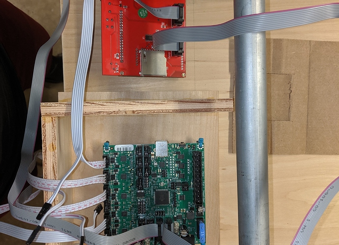

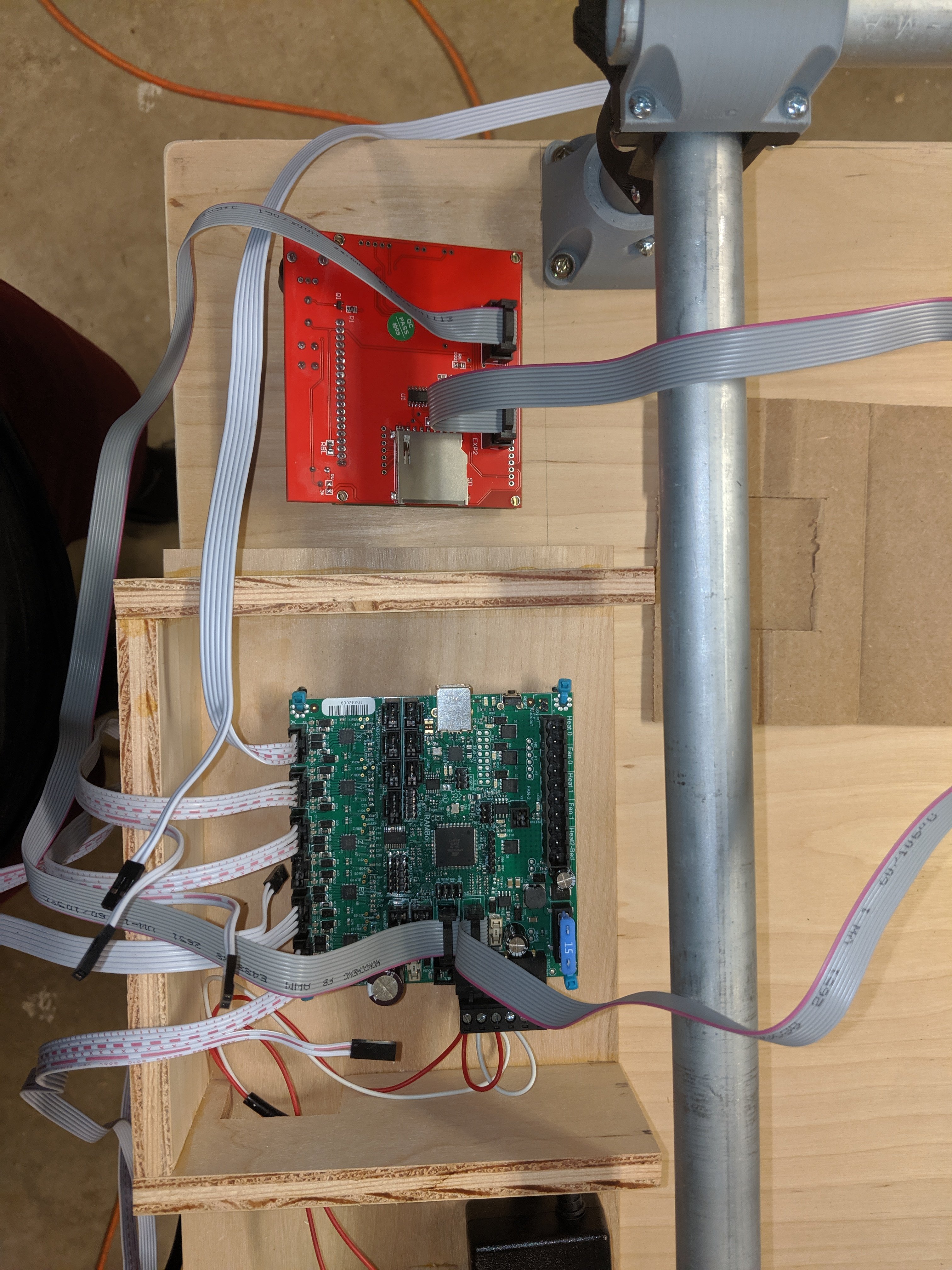

I have the same issue on power up. LCD Screen sits there chirping and flashing. Using the Rambo 1.4 board and the LCD Screen. Both purchased from V1 Engineering, so they should be flashed correctly. Connected them using this wiring picture…https://www.v1engineering.com/wp-content/uploads/2018/06/RAMBo-LCD-Connection.jpg. The connectors go only one way on the back of the LCD screen. Any suggestions?
Link to photo of my wiring is here…https://photos.app.goo.gl/9Sw8vN1KP4DYMbRZ7 or attachment below.
Turn the plugs around on the rambo, face them the other way, same port.
Success! Very cool to see things move for the first time. Screen seems very intuitive so far. Thanks!
This fixed the problem for me as well, ie reversing the orientation of the plugs but keeping each to the same port. I’ve got to think that this is a pretty common problem, maybe include this “fix” more prominently in the instructions/assembly write-up rather than having folks search and dig in the forums? Just my opinion. Thnx for a great product! :slight_smile:
