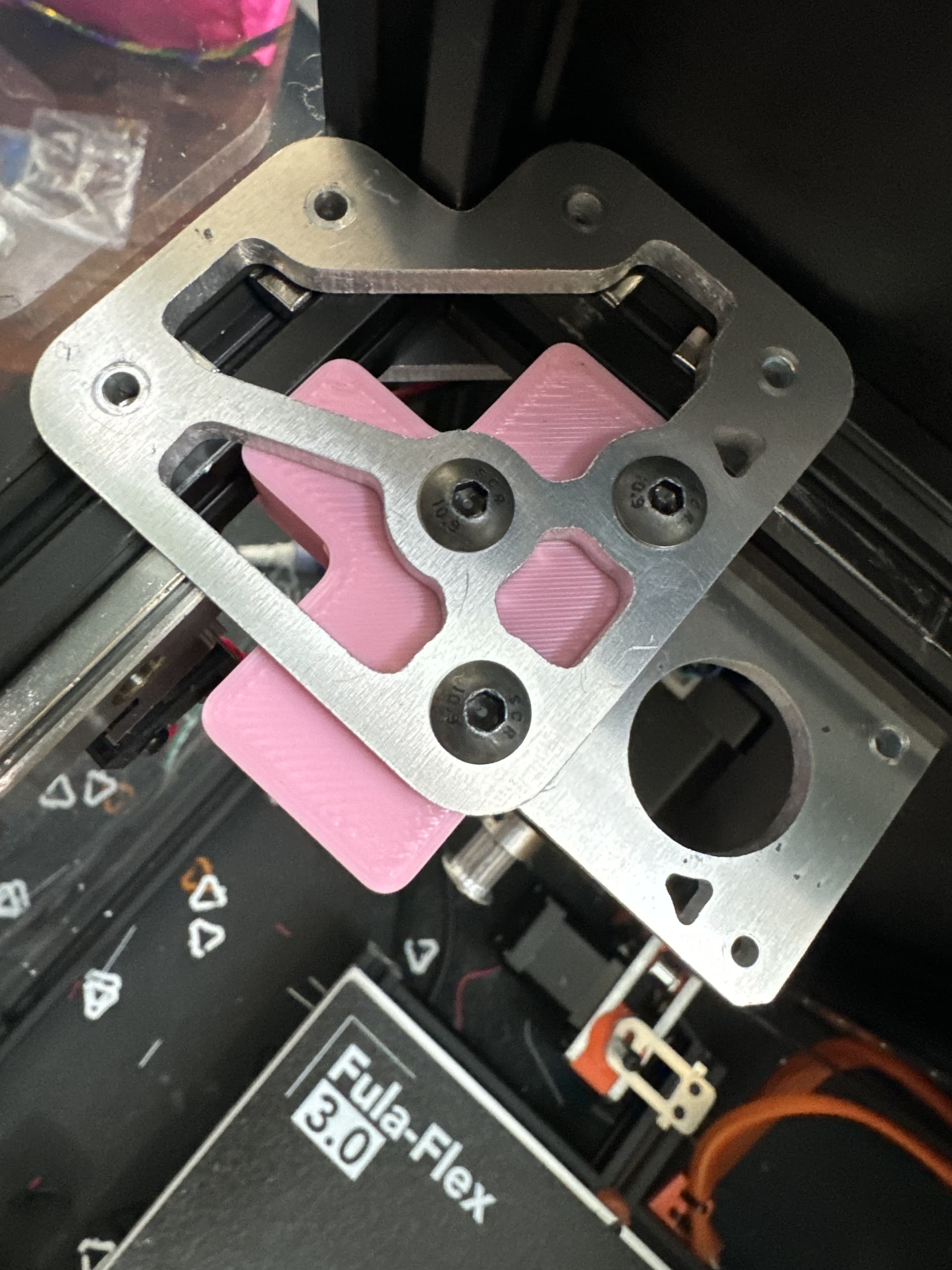

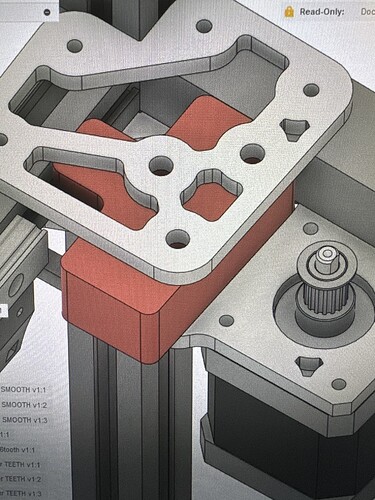

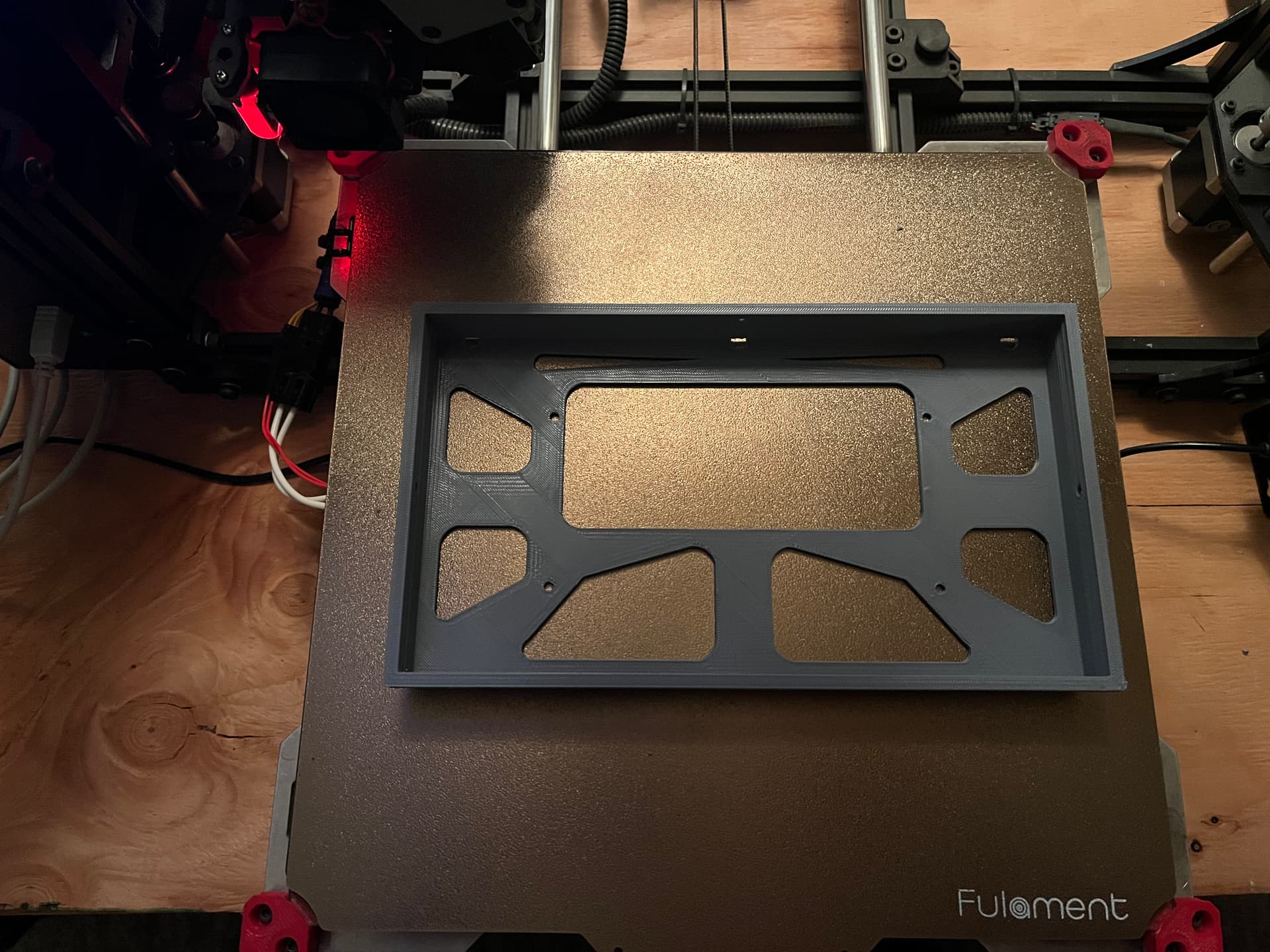

I don’t know if I’m too late for this, but as part of the troubleshooting process for my printer, I went back to make sure that I had the top and bottoms plates aligned correctly as the CAD wanted.
I drew up a quick alignment block to keep the holes aligned, as well as the spacing from the rails exact as the CAD was drawn.
@Jonathjon and @vicious1 did not do this for their printers and did not have any problems, but it might be some cheap insurance for you if you aren’t already past that step
I’m ready to start assembly, except I need to finish my LR3 to cut the panels for the frame.
That’s awesome, I was about to do the same thing, thinking also that it might be helpful.
When you started troubleshooting your machine’s potential alignment/pulley/belt issue causing some kind of artifacting- I started thinking even more about assembly/alignment jigs for mine.
So this is potentially very timely and interesting to me.
Thank you, this is great input.

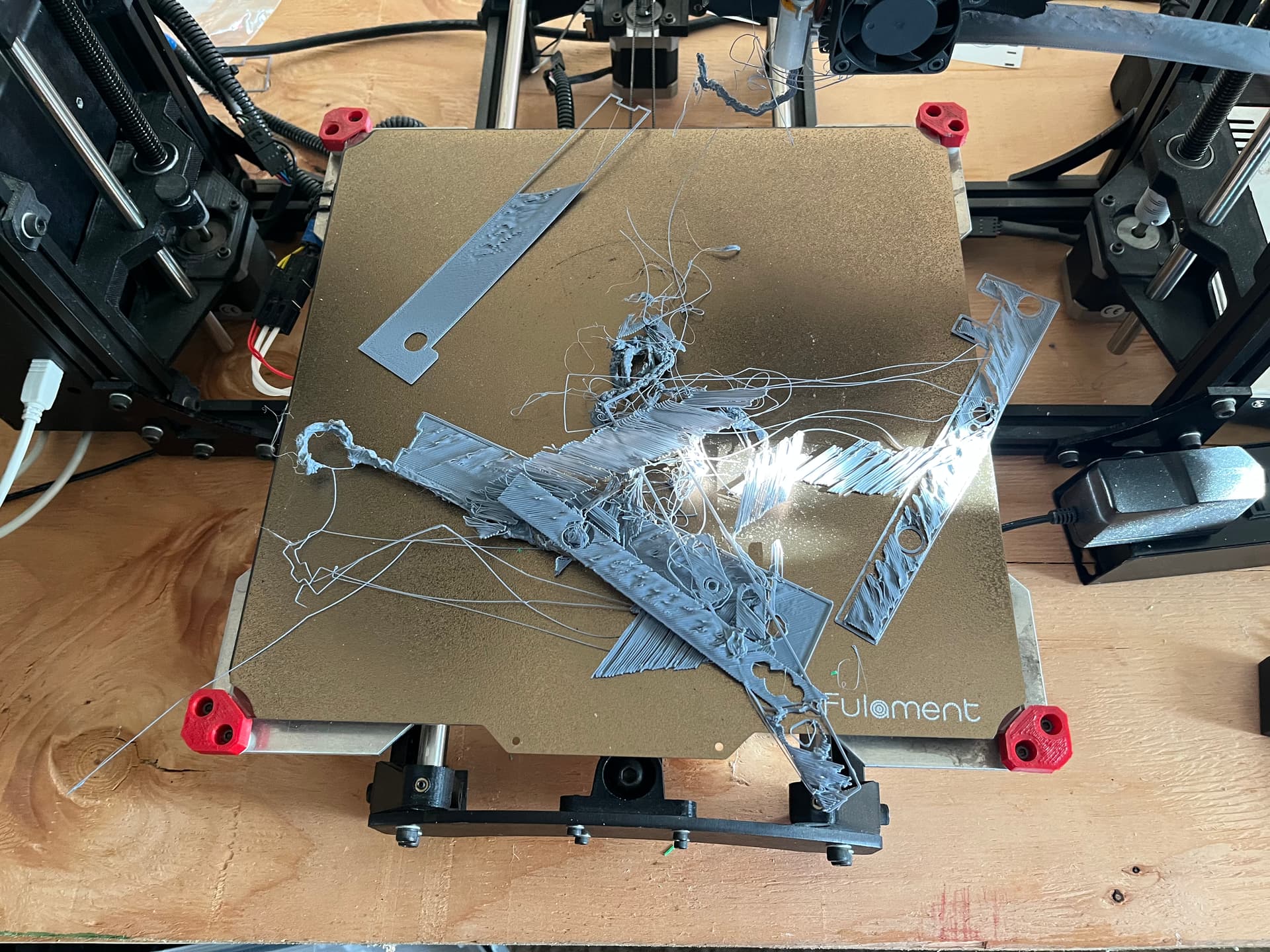

Next print up, I fired up a set of FlashForge A5M plates (Doug Joseph’s design), for a friend’s new (used) A5M. Disaster:
Not really shown as I’d already removed it was the ball-O-PLA that surrounded the nozzle and hot end, and must have broken a wire on the thermistor. The printer had stalled with a Maxtemp error in Marlin.

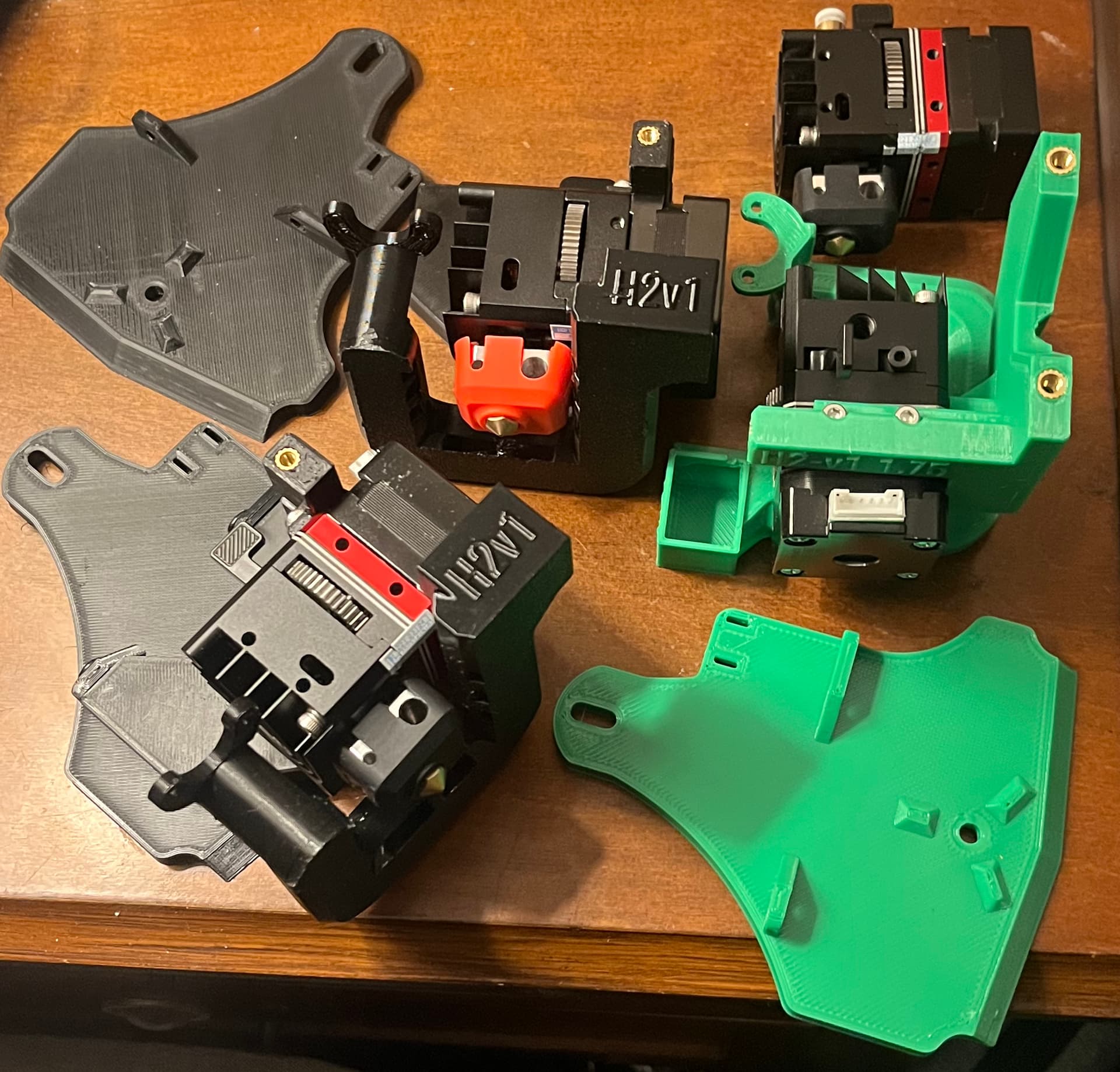

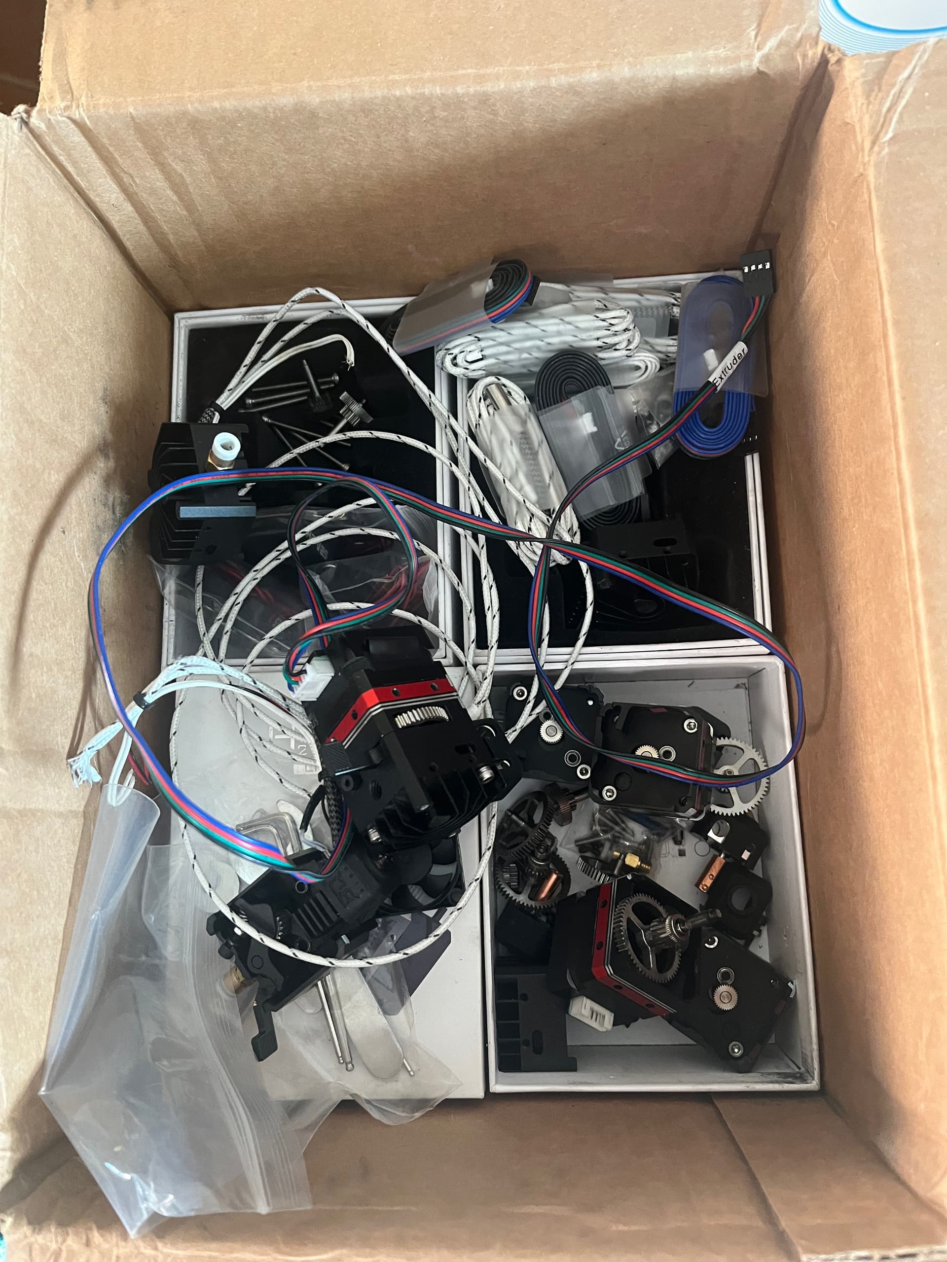

Meanwhile, I do have a big box of cast off H2V2 extruders due to some wheeling and dealing, plus a new in box original H2V2 that I bought for the Repeat but haven’t yet used.
On a whim, I tore into the H2V2s and from the pile of dead parts, reassembled one with seemingly good parts from multiple donors. I also grabbed the new old stock one out of its box.
I’m setting about building up some new tool heads for the TAZ that will remain after I get going with Repeat builds.
I’ll finish building these up, and swap to a pair of TAZ, then debate which of the remaining donor machines gets torn down to frame up the Repeat. More on that in the next post…

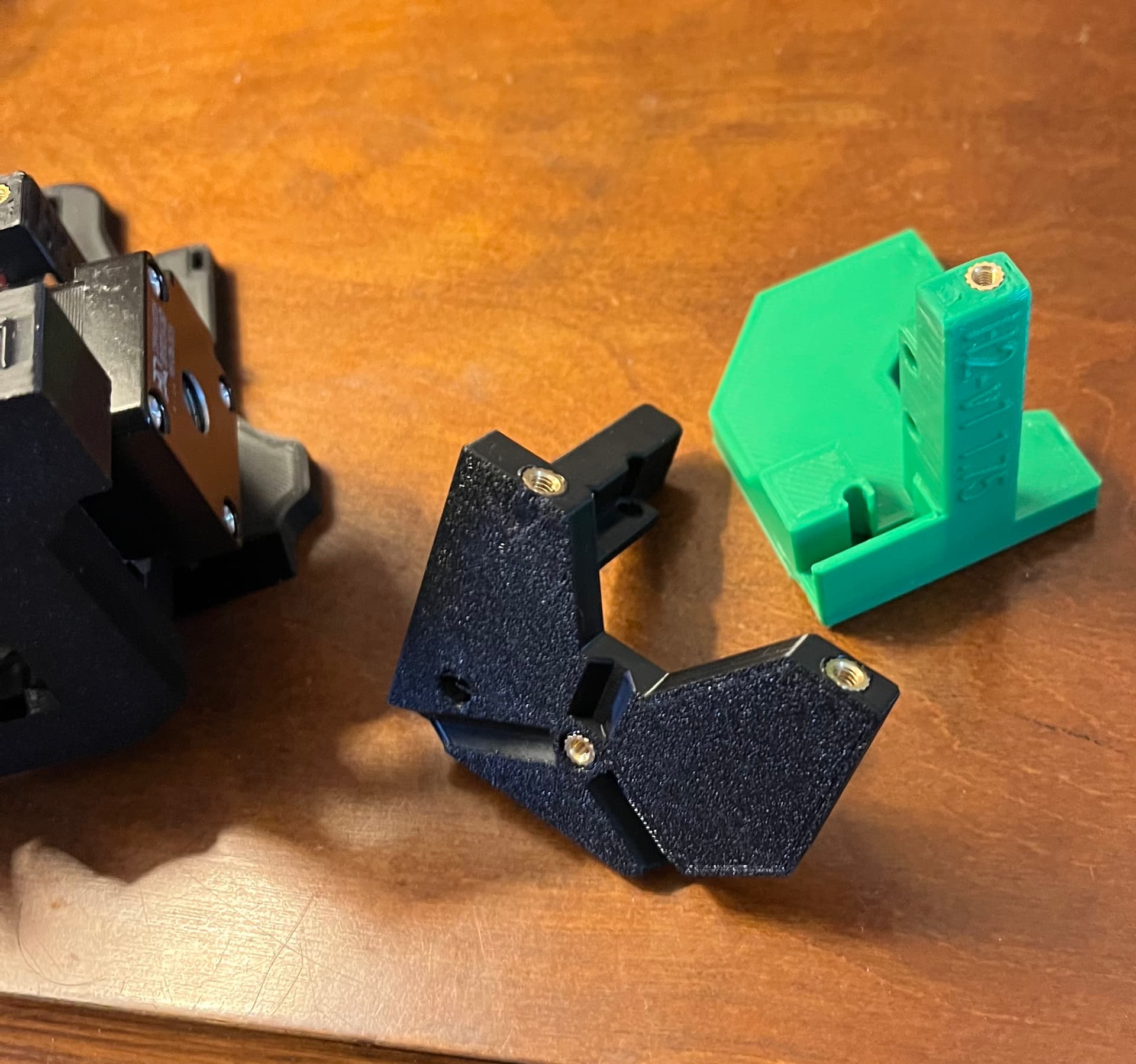

Funny, on 2nd look… I have that same exact heat set insert machine :slight_smile:
I used that machine today, which I’ll mention in the next post below (long winded, coming up)

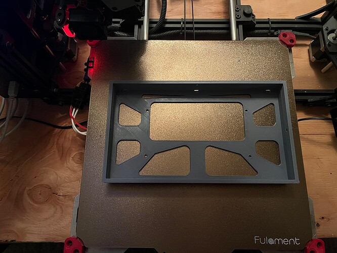

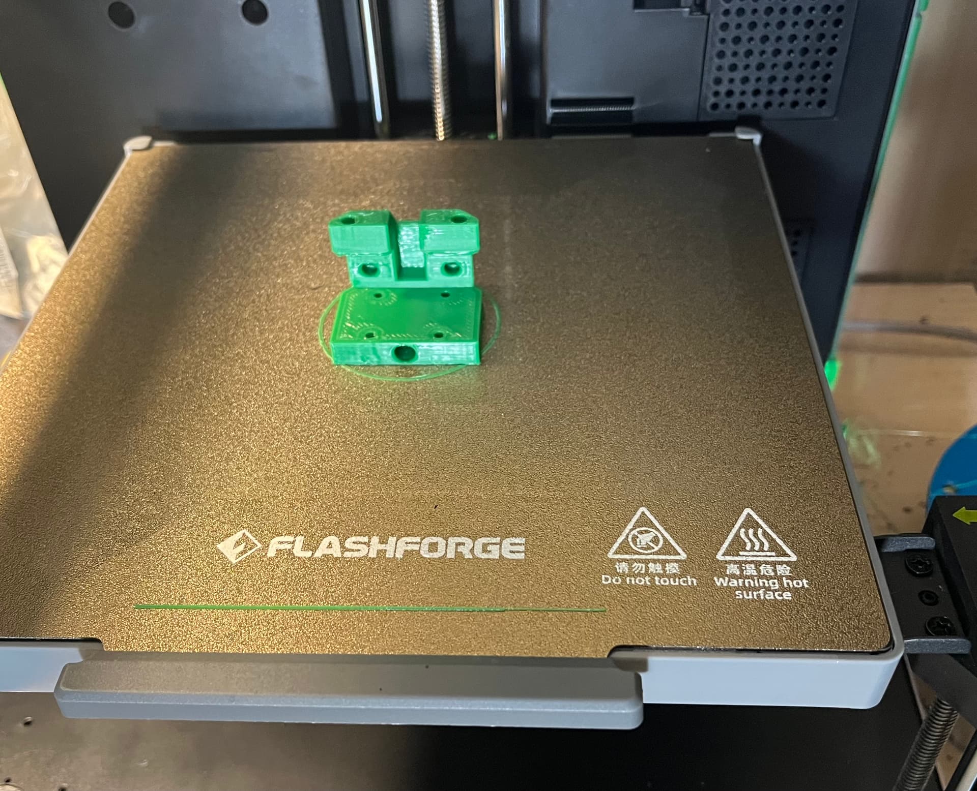

The shny new Core One L is busy today with critical grandkid assignments (!!), so it’s over to the A5M to start printing Repeat parts. Look familiar?
Now off to write the next post.

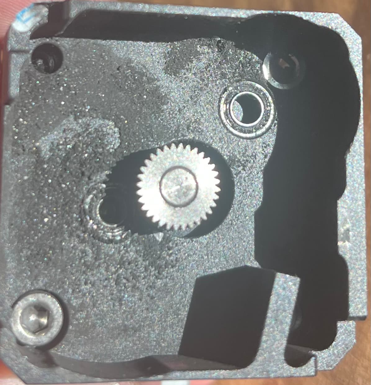

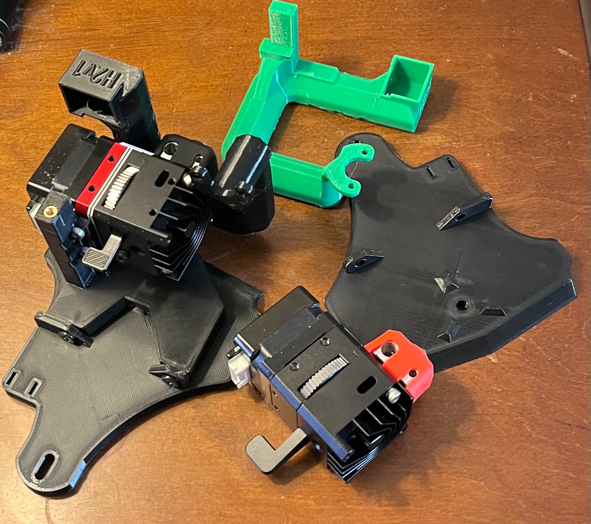

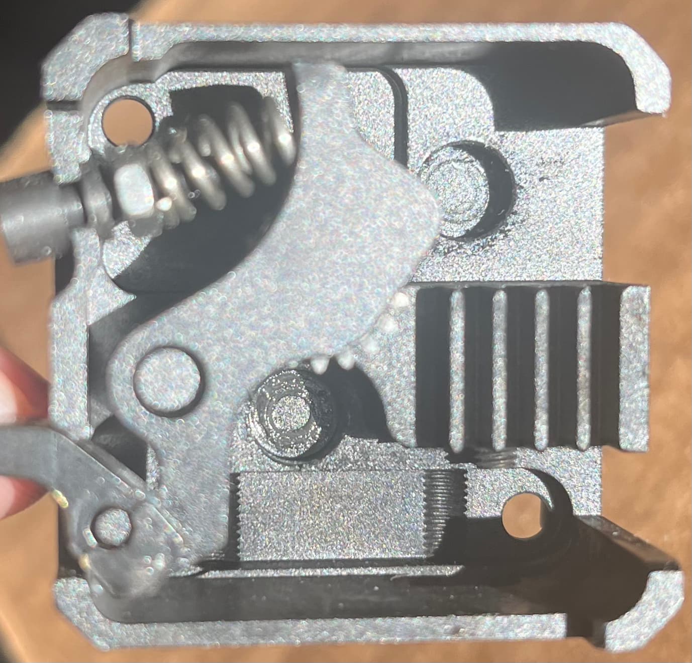

All righty, then. After determining to make up some new toolheads for the Lulzbots, and having a HUGE box of dead H2V2s (and a new in box V1)… I set about doing extruder rebuilds.

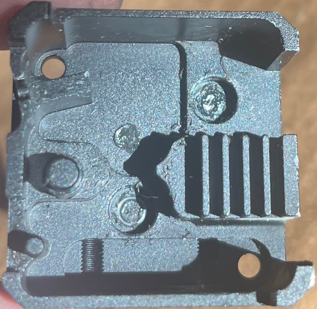

The issues with these extruders amaze me.
Someone at BTT needs a good swift kick in the backside. So close to great, so close to garbage.
These will be familiar sights to anyone who’s ever fought with one of these:
Slowly worked through the box. I have a pack of replacement bearings, and I thought I had some thin stainless washers I was going to use as shims for the ratted out recesses. I still might, I have quite a pile of parts to work with.
Ruled out a bad thermistor here, a bad heater there, an ugly hot end block… slowly working my way through mixing and matching and replacing things.
It’s one way to spend a Sunday :zany_face:
Used that heat set insert machine I mentioned in the post above. Love that thing.
End result was four probably good extruders, and three TAZ toolhead printed parts sets.

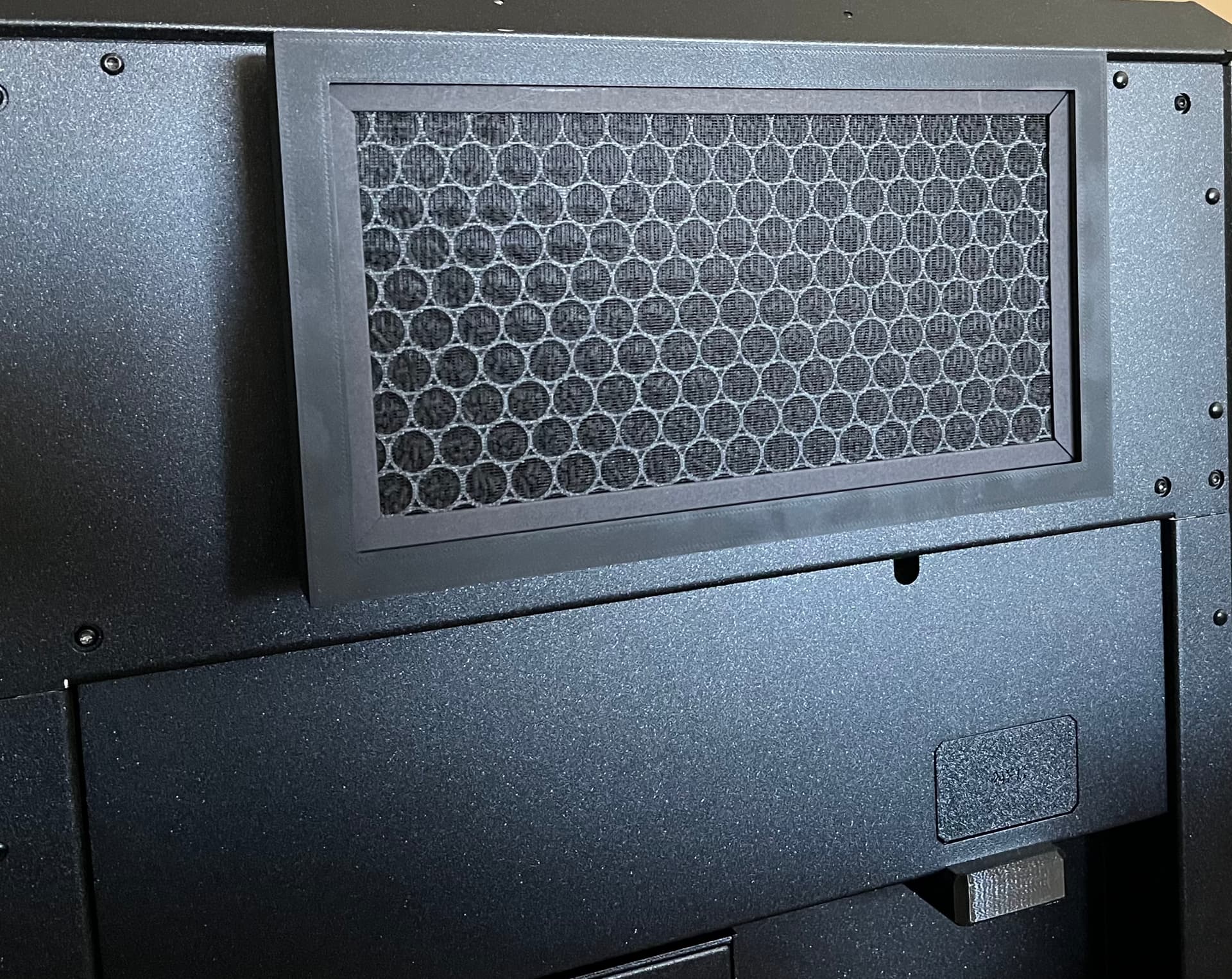

Oh, and since I mentioned it a few posts up above, the HEPA filter I made for the Core One L right before the TAZ 5 extruder got wrecked:
It uses a Tesla cabin filter as the media. Super cheap, $20 for a two pack at the online bookseller.
