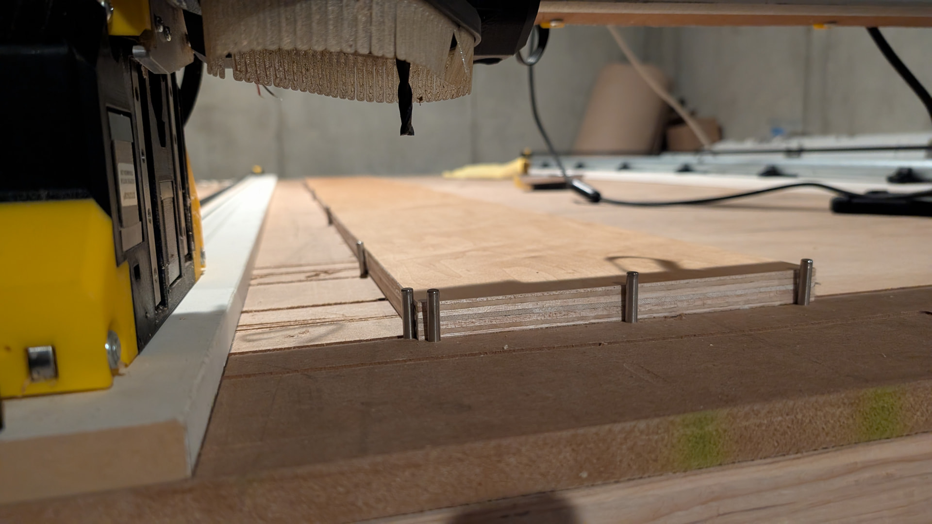

I made a pin grid using 6mm stainless pins for alignment. To make the grid, I used a 1/4in bit. After finding home, I then offset the machine by -2.825 mm. I then placed peg holes every 10 cm, running along the X and Y axes.
Cut about 30 parts last week, and the repeatability was insane. It’s easy now to align parts along the sides and corners. Amazing.
