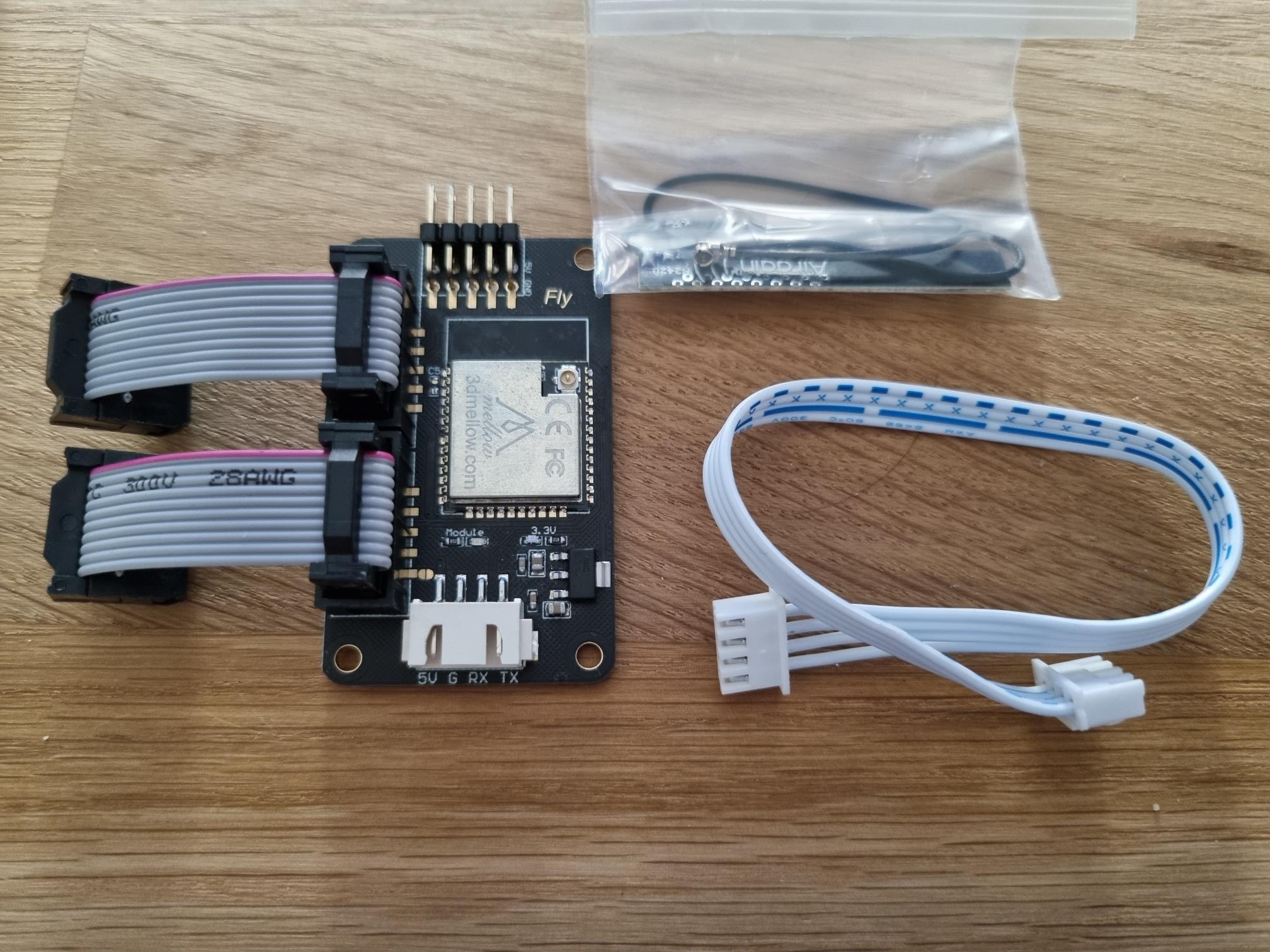

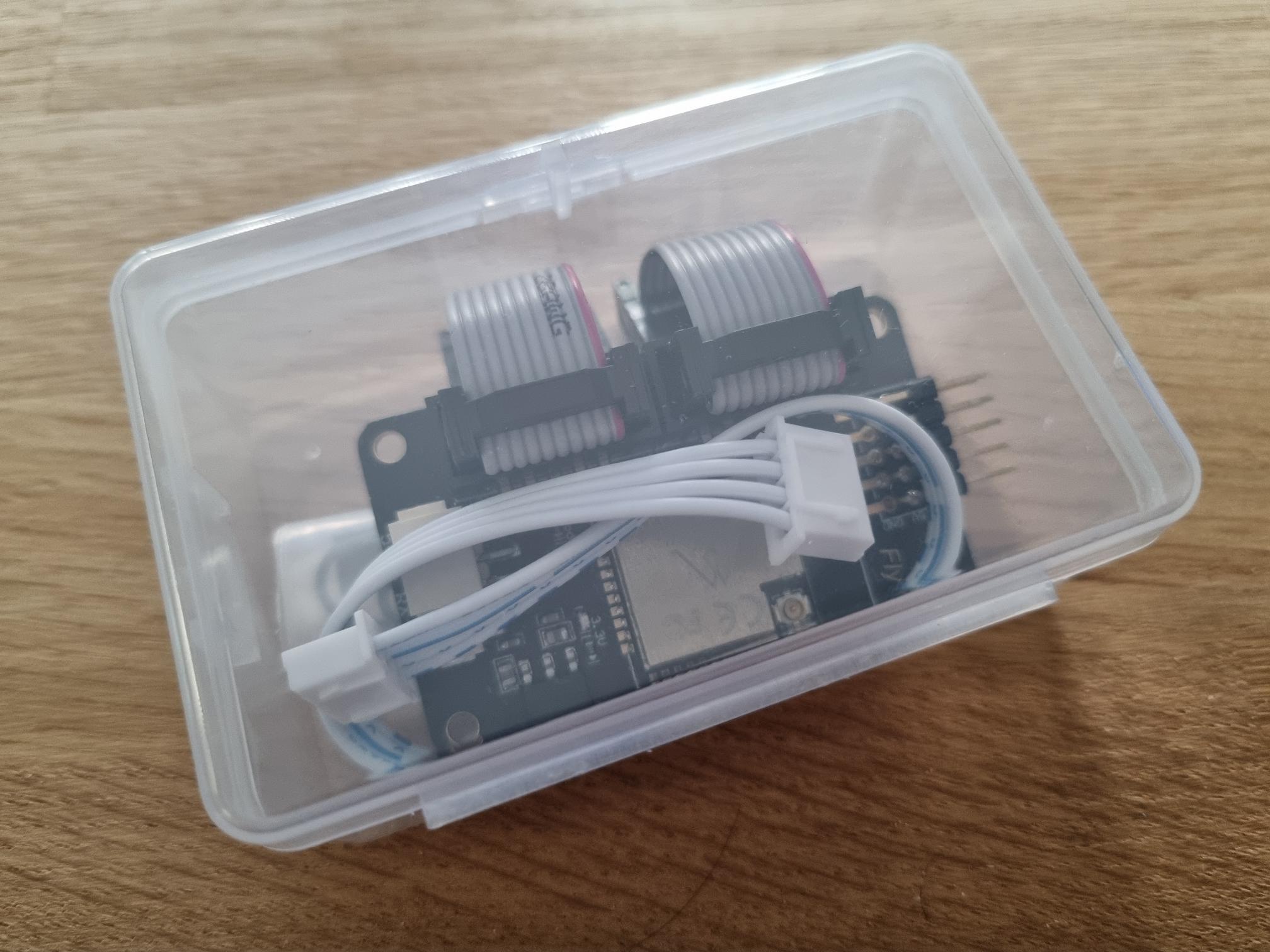

Look what landed on my desk, the wifi module :slight_smile:
It will take some time but I hope to configure it within some weeks when on holidays.
My complaint about that module is the JST connector for the board side when a duPont connector would be more appropriate.
yes, that´s an odd decision. But that´s the same for the BTT TFT35, there they used Dupont instead of the JST, rather annoying.
Do you hook up both EXP wires on yours?
On team Gloomy they only use one according the pictures. The serial seems to be optional for FW updates.
I saw that they showed one, but that was a different board. Having both seems to work the way I expect, so I’ve left ot that way
