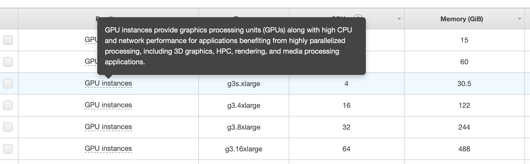

That’s not entirely true — AWS does have virtual machines with hi-perf GPU. I don’t know if it will meet your expectations or not… https://docs.aws.amazon.com/dlami/latest/devguide/gpu.html

Surprisingly, I’m working on AWS Workspaces right now. Some of their beefier stuff has a cost, but you pay by the hour. You can create a AWS login for free for 30 days. You would end up with a bill for any work you did inside the workspace. A workspace is basically a VM that you have RDP-like access to using an AWS client. We’re using it at work to provide development workstations to some of our WFH users during this crisis.
Thanks a lot for that info! If my brother is too slow or too hesitant, I know for sure what I’ll check out.
Aws workspaces with gpu is magnitude more expensive per month then without. 2 month will cost as pretty good notebook with discrete gpu.
Hourly pricing also not too cheap imho.
https://aws.amazon.com/workspaces/pricing/

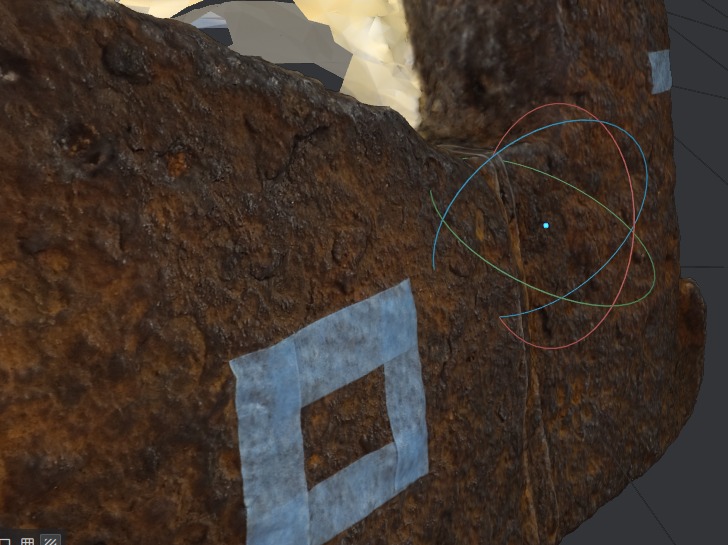

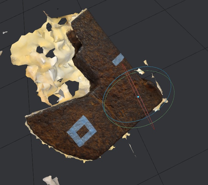

My brother took the bait. Now we’ve tried to generate the model several times. The last try took maybe 30 hours using a water cooled gtx 1080ti with 11gb vram! We’ve tried two different room/background setups and taken at least 300 photos. The last try turned out suuuper detailed, but only on one side. I think the problem is lighting and background - not the amount of processing. We’ll try again, outdoors on an overcast day. Here are a few of the outcomes so far
Hrmmm… sounds like you need a platform that has a rigid post through the middle, but then has a rotating collar on it that you could rig a camera mount to… Got an old bicycle? Take off the front wheel, affix it to something reasonably sturdy, fix a platform on top, then strap your camera to the tire. Take a photo, rotate, repeat. If you want to, do it again, but put your camera on something to put it a little higher, so it’s a set of slightly different angles. That way, the lighting is consistent, the camera angle is (hopefully) consistent, and the object scale in-frame is consistent. All assuming you placed the object in the center of the wheel, and pointed the camera at the center of the wheel as well…
My plan is to mount it on a pole yes. With snow everywhere, I think the lighting actually would be perfect. Glad that the snow can have a positive meaning, for a change!
Now - finding a sort of wheel like contraption is a challenge!! Thanks for great ideas, getting a even circular motion around the object seems crucial. I think it’ll be easier outdoors, with more space to move. Can move closer and increase aperture as well.
