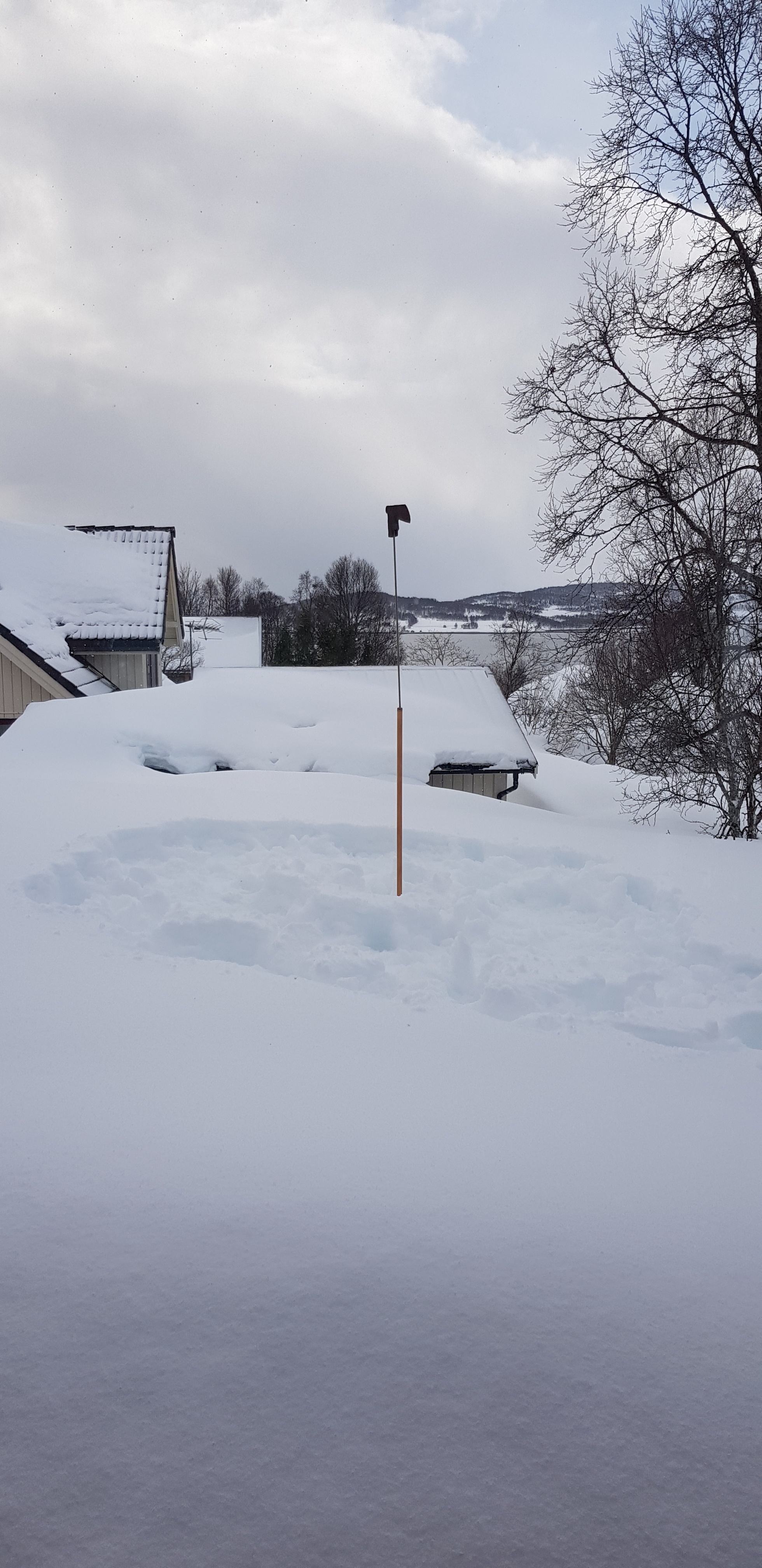

Easter quiz:
What is happening in this picture?
A) heathen Easter ritual for people close to the north pole?
B) warning totem to neighbors to stay away during lockdown?
C) super DIY Meshroom photo setup?
Four!
Northern Golf?
Always wondered if golfers up north used white balls when playing in the snow…
My thought is the ball needs to be neon pink…
Bright orange I think.

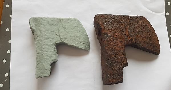

I’ve ended up with asking on reddit. We didn’t figure it out, having danced around the heathen totem many times, taking hundreds of hundreds of images. Meshroom is not as automatic as it claimed.

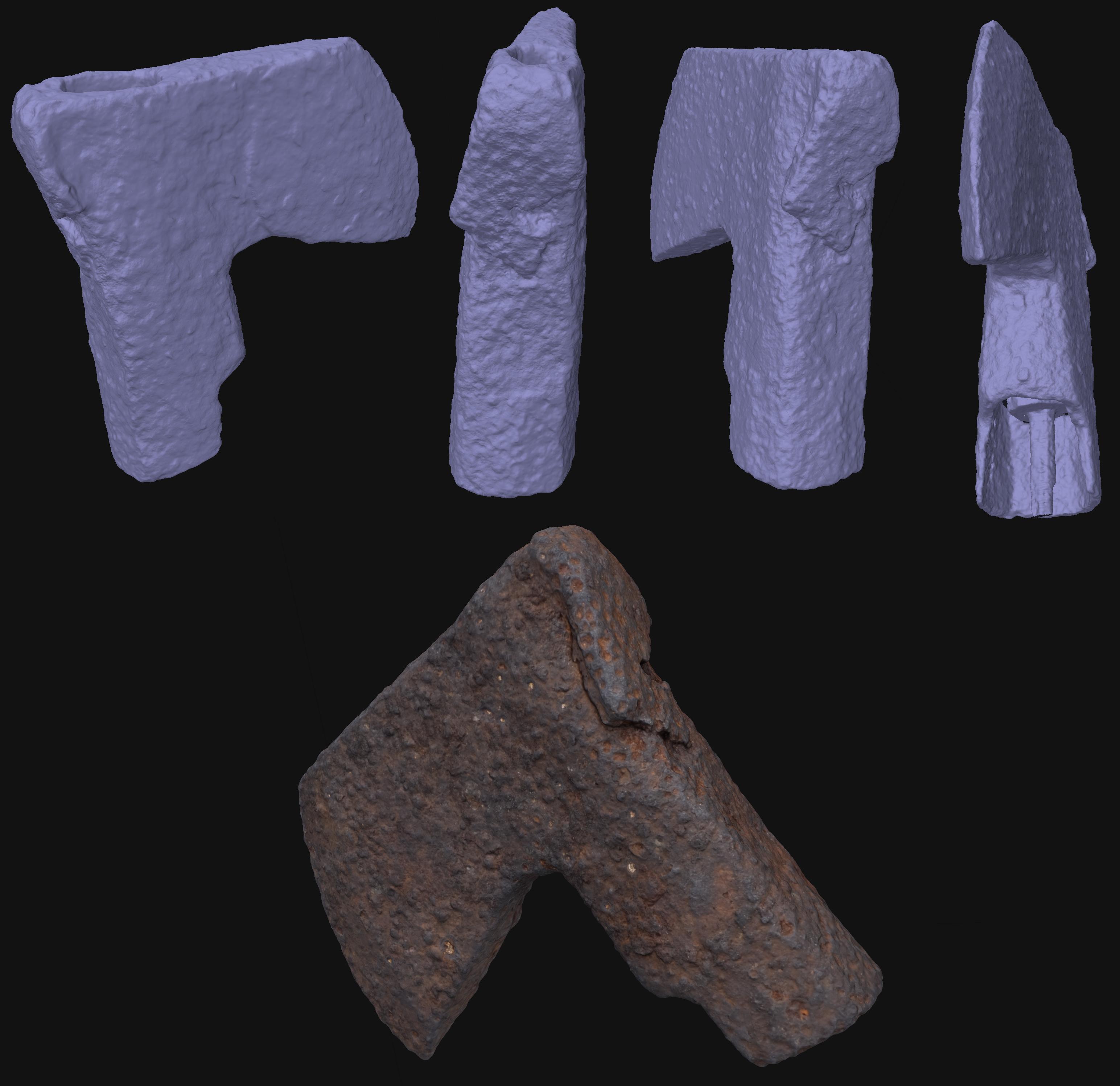

Some random person on reddit heard our cries for help. He/she took the time to mask all images, and make a model in Agisoft Metashape. Look at this, it’s amazing!

Well - the person that helped me has not been cocky at all - just pouring out tips and advices for photogrammetry, in addition to making the model. I’m happy to meet such nice people out there, randomly. There is hope for humanity. Anyways - here is the result! (didn’t care for precise size for first print try. Will try to scale it properly next print)
That is very cool.
Thanks! Next step is borrowing a viking axe from the 1300 hundreds, that my father in law very much wants to make a replica off. The museum curators doesn’t let him bring it to his forge. If I could capture it with photogrammetry in safe conditions, I could print copies that he can throw around in his smithy without any worries.
