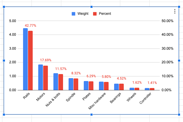

I just received my kit and so I’ve been going through a weight reduction exercise, thinking where materials could be reduced WITHOUT going into exotics, hard to find, or expensive stuff.
Here’s what I measured (with some decent estimations for the plates and the rails, since I don’t have those yet):
Weight (kg) Percent overall
Rails 4.47 42.77%
Motors 1.85 17.69%
Nuts & bolts 1.21 11.57%
Spindle 0.87 8.32%
Plates 0.66 6.29%
Misc hardware 0.61 5.80%
Bearings 0.47 4.52%
Wheels 0.17 1.62%
Controller 0.15 1.41%
Total 10.46 kg
Screen Shot 2020-03-18 at 15.46.50
Applying the 80/20 rule, which is that 80% of the gains come from 20% of the work, it suggest we should focus on the rails, the nuts & bolts, and the plates. (We can’t change anything on the motors and spindle.)

It looks like a 25% reduction is plausible, without increasing cost or decreasing performance. There’s no real-world testing to back this up, so it’s all purely hypothetical. Still, it points out some promising directions for enterprising souls to explore.
