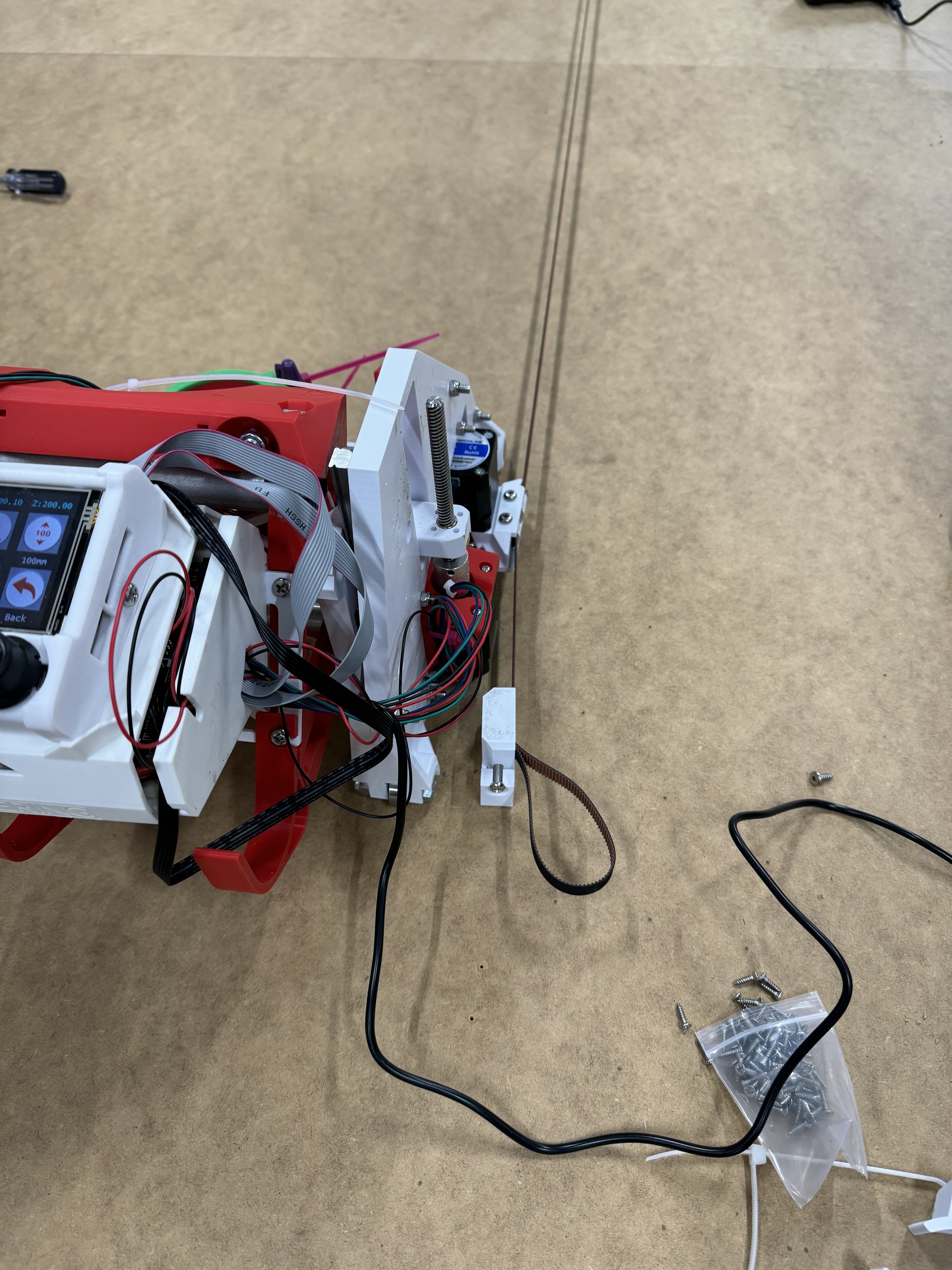

Do these rear blocks hit the z motors to stop or the y motors? Or am I way off?
The beltholders are supposed to contact the Y motor support at Y Min and the Z motor at Y Max. This prevents the unit from travelling too far.
Based on the deflection of the belts, yes, you are way off!!! The belts are supposed to be in a straight line all the way. You need to reposition the Y rail (or the corresponding belt holders) , as well as the opposite side belt holder.
Both belts should be perfectly straight at each end when you are done
That’s where I was confused the z motor contact! I’ve got it going now and belts are straight!
