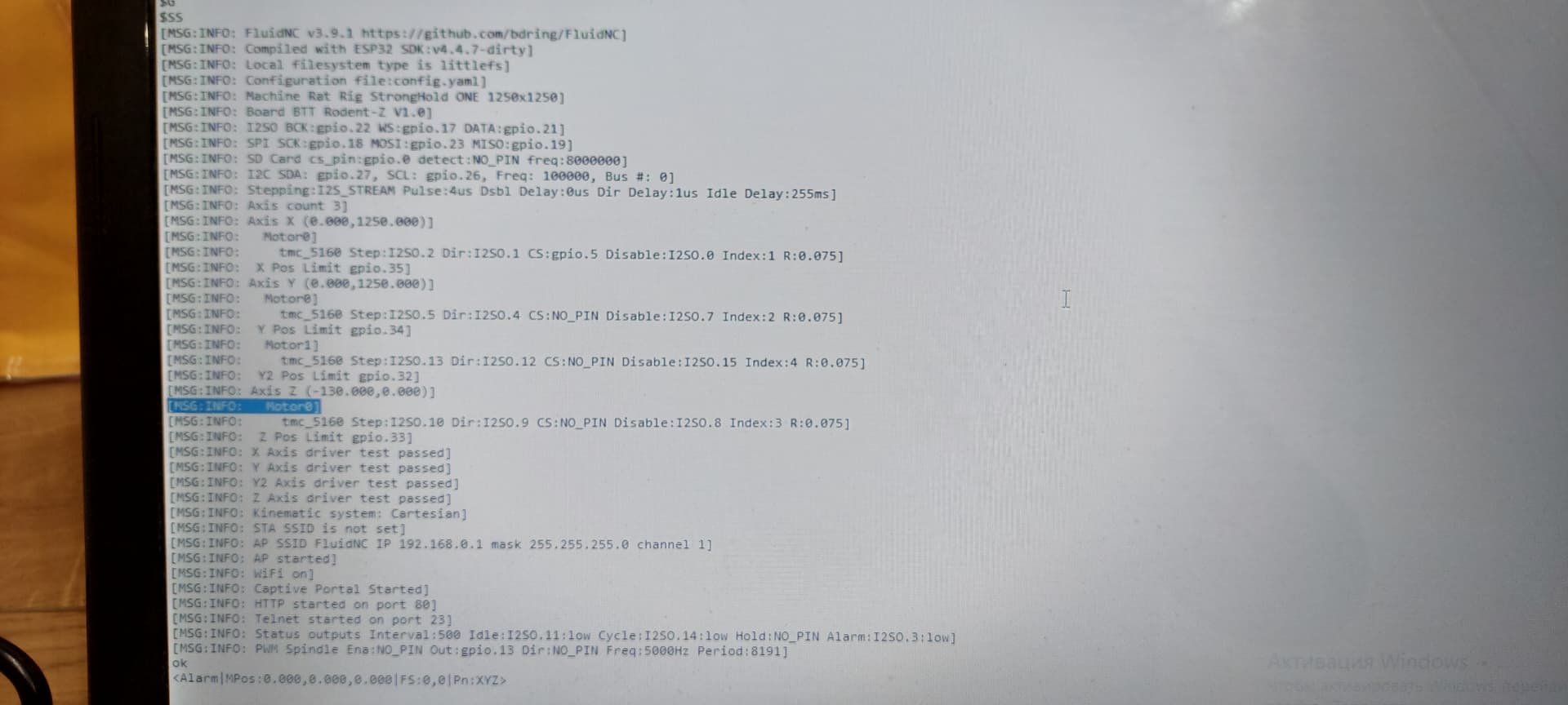

Hello, here are the alarm parameters
It’s a little hard to see in that screenshot but if I read it correctly, you have an alarm related to the spindle or the spindle config.
I’m not sure what’s going on there. I see that the X, Y, and Z limit switches are all triggered.
Yes, it would be good to see troubleshooting with $Limits, but I don’t think that’s the alarm cause.
if I were to wager a guess, I would say the spindle configuration is corrupt/bad or something isn’t working right with the spindle .
I don’t think it’s the spindle config, I think the machine just needs to be homed.

@ilazarimcmlxxxi are you able to home the machine by sending the $H command after you get this alarm?
