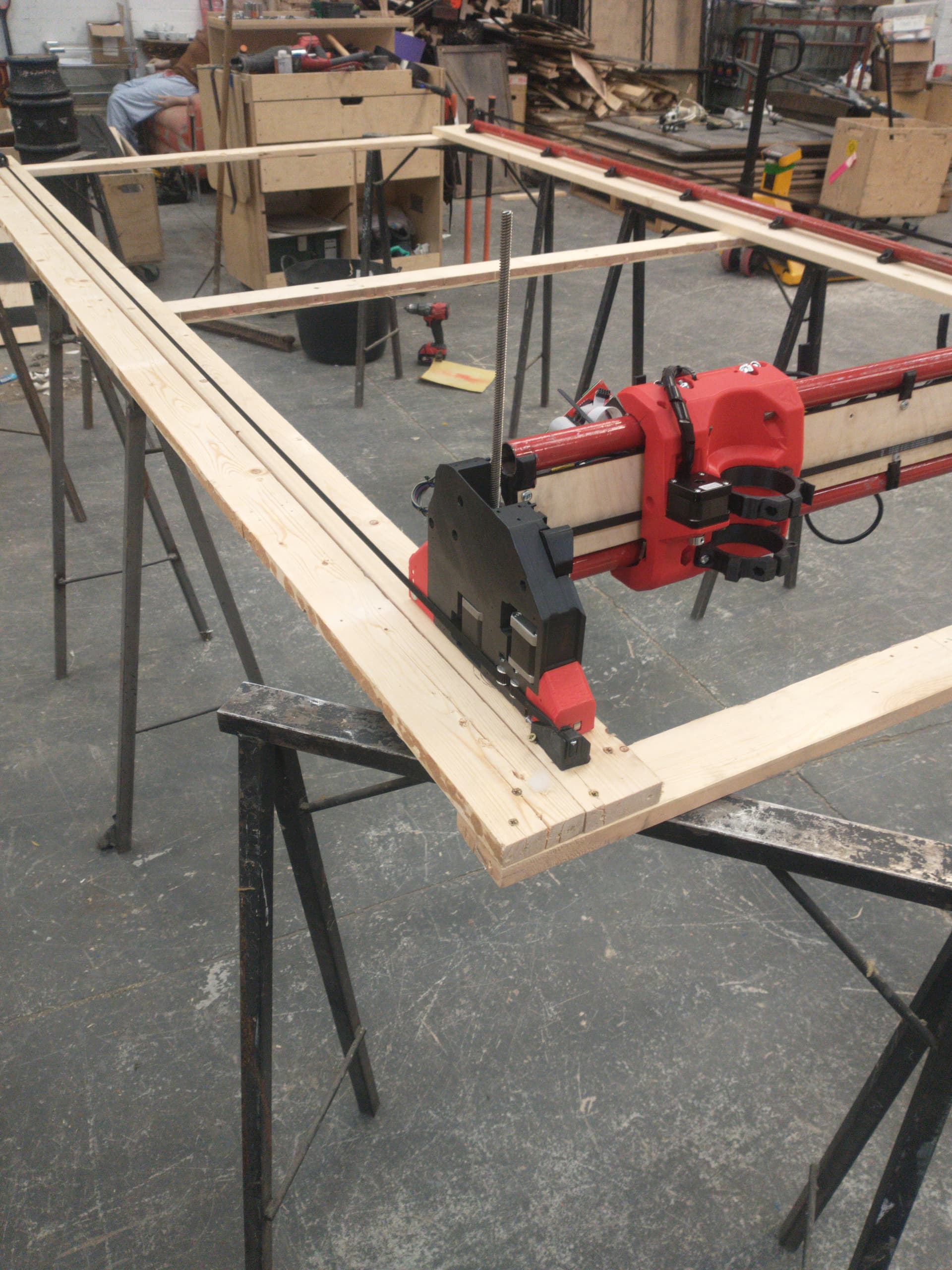

In two minds about sharing photos, because what I have right now is sloppy enough that I kind of feel it’s insulting to Ryan’s glorious design work :sweat_smile: Hoping that my being open with the pains of a path far from the yellow brick paving encourages others to take that route well travelled, at least. And I bet that when I add up everything I’ve spent “here and there” it won’t have worked out that much cheaper than a kit, and will definetely have eaten more time.
Please share the photos. The “yellow brick road” issues are more associated with giving advice to people that ask. Ryan loves seeing his designs in any form manifest somewhere and combine with the mad scientists around the world. I do too.
Mad scientist is certainly what I am… Heavy on the mad and light on the scientist :laughing:
I never take many pictures anyway but here’s an action shot from a predictably chaotic assembly process… Bloody awesome documentation, for the record.
I started off just using up odds and ends of PLA, but black and red actually turned out quite a cool colour scheme :smiley: Wish I’d done some engraving on the strut plates…

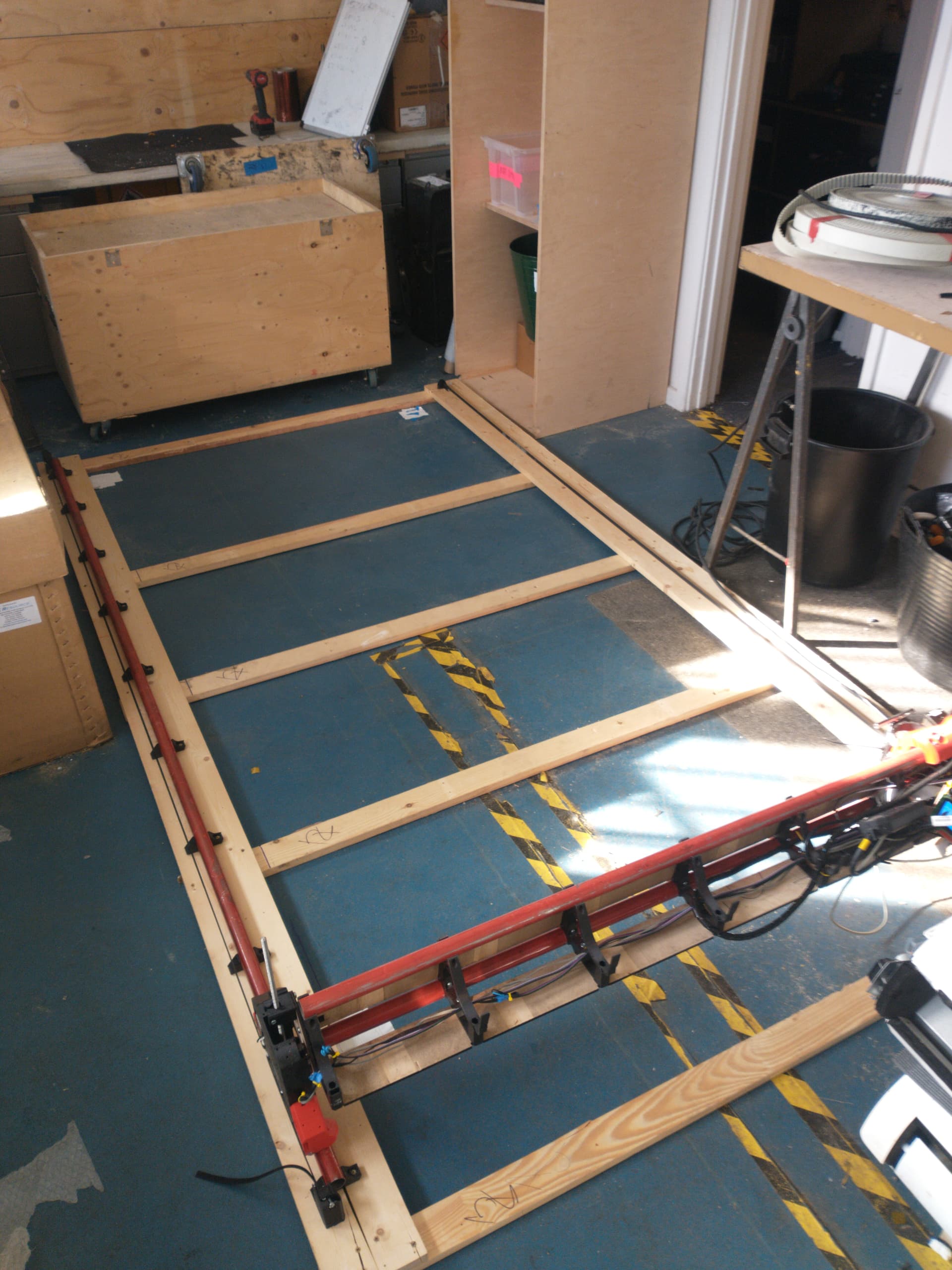

Then I didn’t take any more until it was time to build a “table” which is really just an open frame… I’ve built a minimum viable product (possibly even a bit less than that…) because I need to keep it light enough to be able to get on my roof rack. I should really have built the thing small enough to fit in the van, and in the shed, but for some reason I was set on the idea of being able to break down a 8x4… Might end up shortening the Y axis after all this, once I get some cuts under my belt an a better idea of the working area I need.
Completely unsurprisingly, having it on trestles it bounced around far too much with the flimsy frame but on the floor it seems viable.
I’ll build something a bit more serious once I have somewhere to put it at home - can’t keep it at work long term sadly. Can just about see my temporary wiring nest in that one. Again, something to be revisited when I upgrade to a Jackpot…
Been torn away from it this weekend to pretend to be a groundworker, but raring to get back to it…

This looks great! I love a little mad. Btw, there is a desk in the first room. :stuck_out_tongue:
Besides that: Your steppers look pretty small, your X stepper might have problems when you go faster later on. Just a heads up. :slight_smile:
No matter how big the desk, it’s never enough…
X stepper probably does want to be be beefier, yes. Not sure exactly how beefy my Y ones are…salvaged, and there’s zero information on the casing. Fortunately Ryan has made swapping them out super easy :grin: The design work has made me grin at several points…

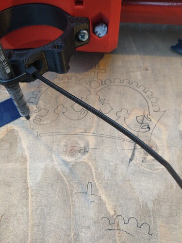

Y square is pretty close now, within a mm or two. Lots of error coming from the pen moving around and my (in)ability to measure. So I decided to stop agonising over calibration and run some gcode. Drew a test crown on a random bit of ply that turned out to be a lot less flat than I thought. My poor pen :laughing:

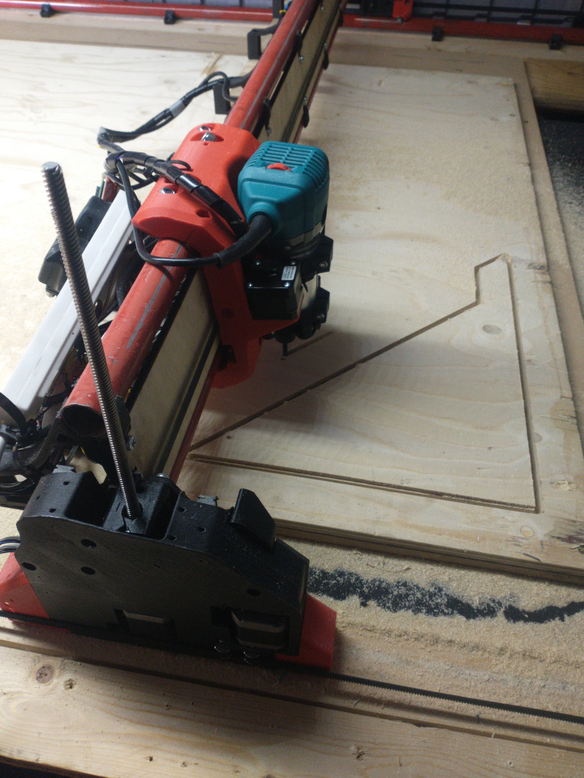

Nyooooom. Was bored to waiting for my 1/8" single flute upcut to arrive, tried some test cuts with the regular 1/4" router bit I bought with the router. It made the most ungodly noises, but gave me some usable results. Engraved the V1 logo using the settings from Milling Basics - felt like the only appropriate test. Rather unsurprisingly, the finish wasn’t great :laughing:
At that point I was still on the back deck (which is apparently tradition in these parts?). But I’m in the UK, not America, so my back deck is just that. No fancy roof. And again, I’m in the UK… so it started hailing out of a clear sky…! Fortunately, I’m much practised in covering electronics from sudden unscheduled water (small festival gigs that don’t spring for a covered stage…) and no harm was done.
Cue next day turfing everything out of my shed. And then remembering the shed is 8ft by 8ft. Once again, making the machine smaller would be the sane option. So, obviously, I built the shed a back deck of it’s own. US style, with a roof. :laughing:
So now the LR frame fits mostly in the shed, with the far 1ft of Y (which I may not ever use anyway after all this :rofl: ) sticking out into the shonky new “porch”. It’s not ideal - I’ll be bringing the gantry indoors proper when not in use (those quick release belt mounts are a work of bloody genius) and reckon I’ll be making the board box from a weatherproof project box! But it’ll keep the hail off, which is a damn good start!

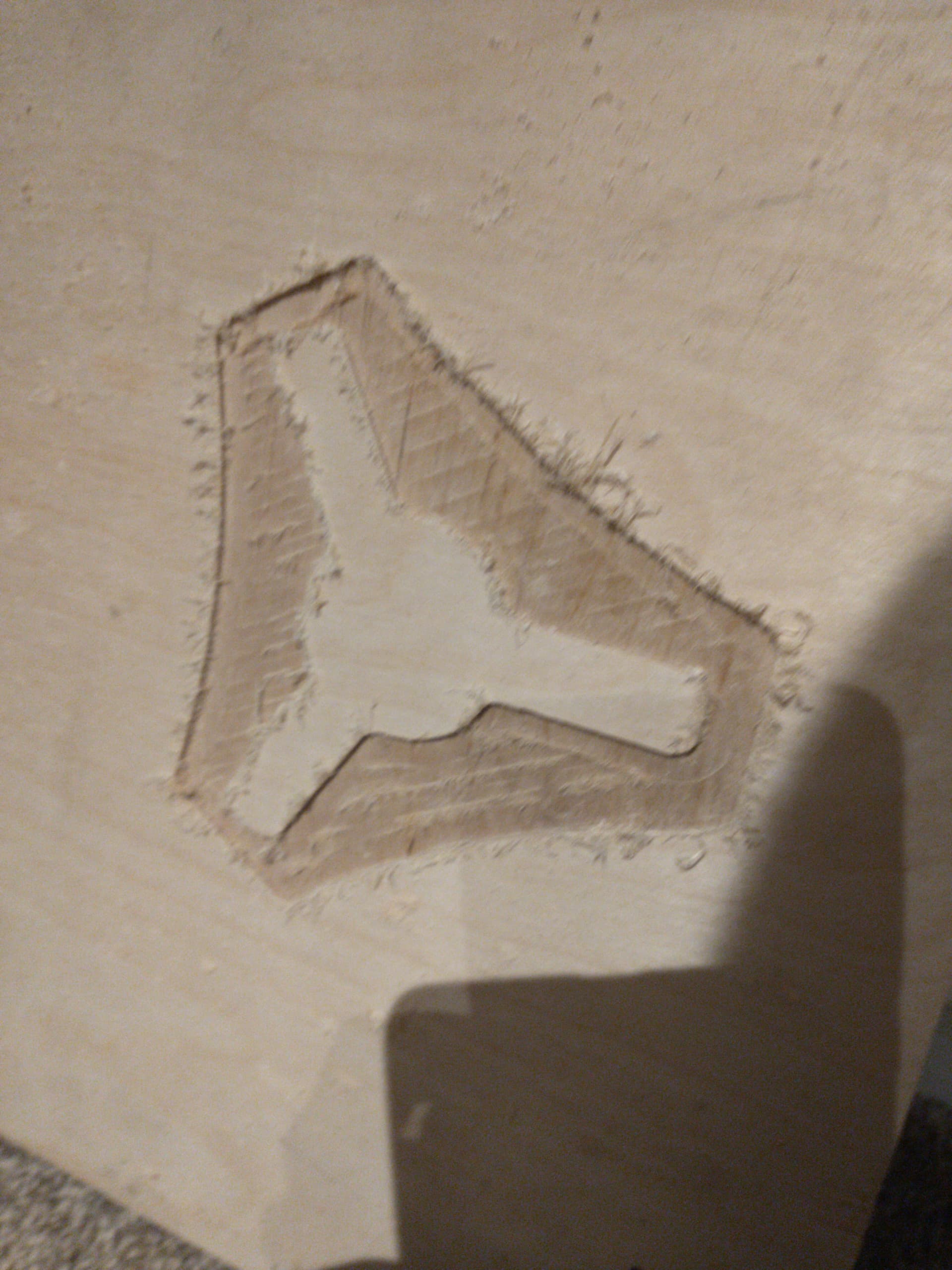

Still with the 1/4" standard router bit… Worked pretty good for the first cut. Then started throwing the gantry around on me. Done quite a bit of playing with feeds and speeds, all good learning and I’ve managed not to break anything :smiley: (I’ve since made the dodgy looking router wiring marginally less dodgy. Going to redo it properly and put a relay in when I do the proper box for the electronics. Cobbler’s children…plus having too much fun atm to want to take it apart!) Well, pretty sure I’ve killed the router bit but hey.
Also think I’ve cracked my Z uplift problem - my bootstrap 6mm ply end plates are, unsurprisingly, flexing inwards quite a lot when the gantry is all up, causing the printed part to pull away on the other side and the screw to be all kinds of wonky. Explains why it gets notably worse the higher up it is, and why swapping to flexible couplers helped some but didn’t cure it. Going to cut some Alu plates on the local makerspace’s Superbox I think, rather than trying to feed metal into this as is. But the machine is still totally usable in the meantime, it only starts to skip in the very upper region of Z travel.
Can’t remember if I said it already, going to say it (again?) anyway. This is the coolest godsdamn thing I ever built. Giant smile on my face the whole time I had it running, to rival/beat the first time I watched a 3d printer all those years ago!

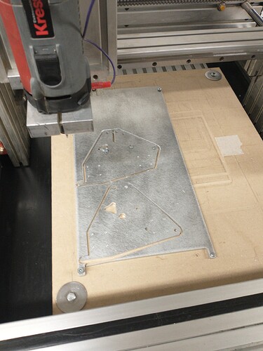

The machine started skipping Z low down as well as up top, feels like the ply plates are flexing worse and worse. So I did a thing:
5mm not 1/4" cause it’s what I had on hand, but should still be loads better than ply.
Need to make a less bendy table too and then I should be away to the races :smiley: Jackpot is on the way too…
So I’ve been busy. Put the “frame” pictured at the start of the thread on a 8x4ft pallet with 18mm OSB screwed to each side. Feels like it’s pretty close to a proper “torsion box” with nearly zero effort. Winning!

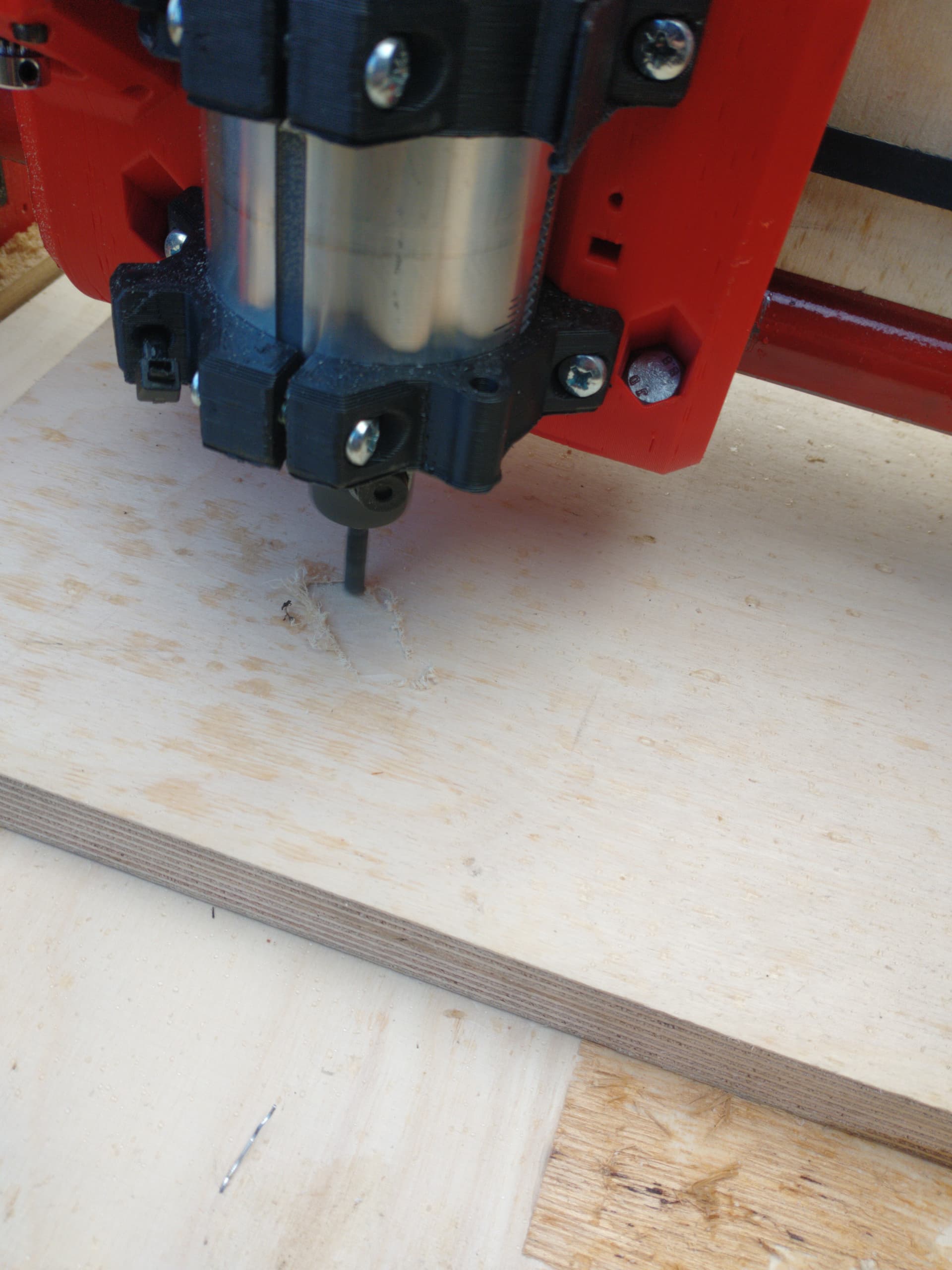

First iteration of dust collection was a total fail – printed a reducer to use my shopvac hose as is and it pretty much instantly gets clogged. Bigger hose should be here by the end of the week.
I also seem to be absolutely wrecking bits at the moment. :confused: Using cheap 1 flute 1/8"s at the moment with 2mm DOC, 21mm/s feed at with router dial at 2/3 (starting 2, seeming to need to move up to 3) which should be about 12k RPM (allegedly). Cutting fairly crappy and fairly hard ply. EstlCAM reckons that’s at the lower end of a good chipload but in meatspace it seems like I’m just making dust and dulling tools. However, I don’t seem to be able to increase feedrate or back off RPM without losing steps. Not sure if the Makita knockoff router (probably way off in RPM?), the cheap bits (feel pretty sharp to start with…), the nasty ply, or some combination that’s causing me the trouble here.
