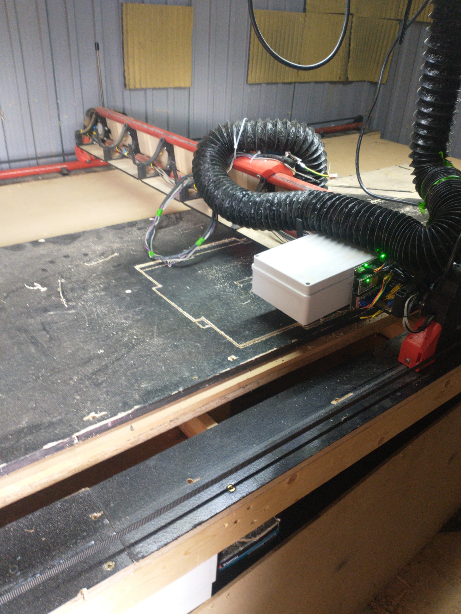

So I rebuilt my table again. The bearings on the non rail side were wearing a groove in the crappy pine. I expected that, but not quite so quickly! Moved the “struts” from the original MVP frame to within the pallet so the 12mm MDF I’m using as a spoilboard sits directly on the 18mm OSB tabletop rather than sagging slightly between the spans of lumber. Should have done that in the first place, really. And added strips of lacquered plywood to the rail sides, though there’s an annoying join because the piece was about 7ft.
In doing so I noticed my surface is positioned to far toward Ymax to actually be able to usefully reach a full 8ft. To do anything about that I’d need to strip the table down again, and I really don’t feel like it right now…
Speaking of which, is there a good guide for getting the rails and Y belts positioned relative to the board? I still feel like I’m essentially stabbing in the dark when doing so (as a result, my squaring is still pretty abysmal) - probably just missed something obvious!
Also still really struggling to find feeds that are quick enough not to cook bits, but slow enough to not skip steps on my mysteriously underpowered machine. On that particular cut in the picture it seems to consistently skip on what is the top left corner, so X moving towards the centre of the beam. Seems worse that way than coming back, but that could just as easily be positional. That then causes Y to struggle since it’s out of position and trying to cut way too deep. Considering throwing one of the 60mm overkill motors I have onto X, since it seems doable (unlike Y) and if it still skips then I know something really odd is going on, right? :thinking: Wondering about my belt tension being way off - they’re super slack. I did do a “test square” that came out nearly dead on dimensionally, though. So probably not that.
I’m also still struggling to ‘level’ such a large table – honestly I’d cut the machine down to a much smaller size in a heartbeat if it hadn’t already become clear I do actually use the 8x4 working area, it is not just for bragging rights. It’s nowhere close to “true level” (blame the idiot that laid the shed base :raised_back_of_hand: ) but the machine and spoil board appear relatively level in respect to one another. Yet running a cut it becomes obvious that they still aren’t, though. Strange, and enough of a pain that I’m wondering about making the machine smaller anyway and using fixtures for bigger parts, even though that’s most of them…

My current problem is lost steps at what should be very achievable feedrates.
  • 21mm/s feed
  • 1mm DOC (per pass)
  • 18mm overall DOC
  • Approx 12000 rpm (Makita 701 dial at 2)
  • 3.175mm single flute upcut endmill
  • Very very soft ply (“Weezer”)
This then causes more lost steps, then crashing. Smoke. Bad.
I can’t slow down more without going below a good chipload. Nor can I reasonably lower DOC any more.
I think it happens more often when cutting in X. Could equally be from effective DOC variance from my flatish table.
Current machine “variables”:
  • 30mm O/D 1.5mm thick rails
  • Jackpot with genuine TMC2209
  • 5mm ply strut plates (but with split in center…)
  • 5mm alu end plates
  • 17HS4401S steppers (1.7A same as V1E spec, less torque at 43Ncm vs V1E 59Ncm)
Bigger torque difference than I thought - figured I had ‘enough’ vs the ‘more than needed’ the V1E spec are said to be. I should order some Stepperonline 17HS19-2004S1 (matches V1E spec exactly?) shouldn’t I?
