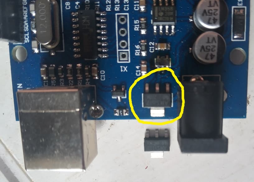

Hi everyone,
My Ramps 1.6 & Arduino Mega Combo is not working anmore.
If I power it via the Ramps’ input (12V), die Arduino’s LED is on but it does not boot and there’s nothing shown on the display but the display lights up.
If I power the bundle using the USB on the Arduino, the Arduino boots and the display works.
I did some measurements and I only get 3V on the display and also on the VCC-Pin.
I did some online research and apparently the Voltage regulator in those cheap Chinese RAMPs Boards burn easily and it is a common issue.
Some people solved this problem by feeding 5V through a buck converter, which I have lying around.
I just don’t really know where to feed the voltage to. Can I just use the VCC-Pin on the J5 connector?
I know, the board is old and maybe I should just upgrade but is has been working well and I would have to print new enclosures and stuff…
Thanks for your help!
So the voltage regulator on the Arduino went bad. Just dealt with this on mine. (Replaced Arduino)
Mine was because I moved the machine manually very fast the LCD went very bright and then nothing!
The ramps does not have a stop for the voltage from backfeed from the steppers.
It is highly likely that it is the voltage regulator on the Mega board that is dead. Your buck converter should feed power to the 5V pin on the Mega board:
The Vin pin on the Mega board will take voltage in the range of 7V to 12V and uses a voltage regulator on the Maga board to convert the input voltage to 5V. With the regulator dead, you can feed the 5V pin directly. That is why the (5V) USB connection works.

Just replace the voltage regulator. They costs a few cents. see the picture. a new regulator is shown beside the board. It is a LM1117 v5 (make sure you buy a 5V one)

I guess trhe easiest option is tzo replace the LM117, I ordered some on Aliexpress and once they’re here, I’ll just replace them.
