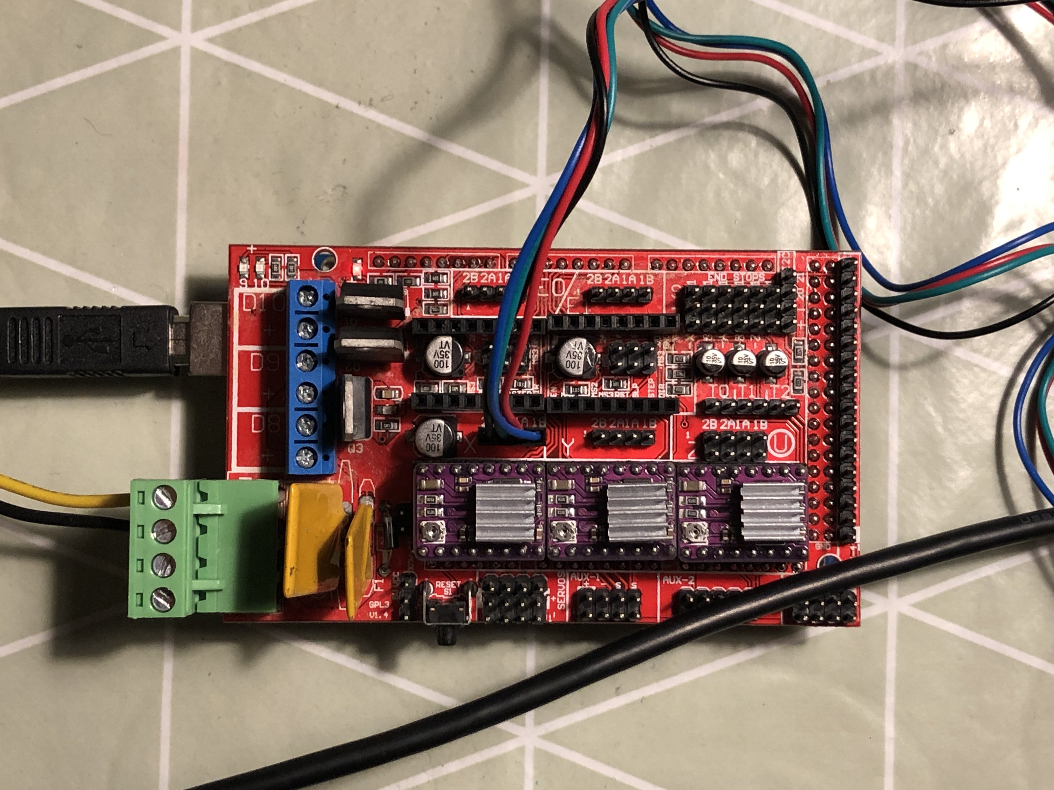

I want to perform the most basic possible check to test parts that I have bought: make the motor turn via manual control of the x axis in repetier. I don’t have a machine to connect to yet (building the MPCNC).
Symptoms:
  • Board is plugged in and recognised by repetier. I see messages from the board in the console. I can connect and disconnect using the green/red button at the top left. Red led comes on when board starts. There is no resistance in the motor, I can turn it as freely as when not plugged in to anything.
  • Nothing happens when I do manual control of the x axis. Motor does not turn.
  • I get the status “3 commands waiting” in the upper right area after trying to perform manual control, and this eventually resolves to the message “Idle” after 30s-1min.
Hardware/setup:
  • Arduino Mega 2560 (genuine board). Running Marlin firmware, I download the Marlin-MPCNC_Ramps_T8_16T_LCD_32step package that is directly linked here: https://github.com/Allted/Marlin. It is connected to the correct serial port, and I used the 115200 baud rate (for compatibility with mac, but I have tried a windows machine also) set in software and Configuration.h
  • Ramps 1.4 board, ebay, very low quality board (main reason for testing!) .It has shoddy soldering, some sort of residue all over the board, very poor part alignment etc. Nothing connected to the thermistor jack, I read that a dummy resistor was not needed.
    • Link: https://www.ebay.com/itm/223201408851
  • 3x DRV8825 driver boards, seem ok quality but I had to file them a little to remove a jagged pcb edge that prevented them being able to mount beside each other, no components or traces were damaged. 3x jumpers installed under each board. Have not adjusted trimpots yet, I understand this is a later step. These are installed on the lower locations on the board, i.e. the ones marked for x/y/z axes.
    • Link: https://www.ebay.com/itm/252715006826
  • ATX PSU (rated >10A on 12V rail). Connected via the green connector on the ramps board, not the arduino barrel jack. Polarity and voltage is checked with a multimeter.
  • A single stepper motor connected to X axis (I have tried all xyz ports and connector orientations).
    • Link: https://www.aliexpress.com/item/32704584112.html?spm=a2g0s.9042311.0.0.3b1b4c4dYyer6i
  • USB cable to pc running repetier host. Have also tried server with similar results.
So, any tips on next troubleshooting steps would be much appreciated. Thanks!
IIRC proper power connections are the other two terminals…
Oh man, you’re kidding me! Thanks! I will check with the correct wiring there and report back.

So now, the motor turns for about 0.1 seconds, before the power supply cuts out (fan stops spinning and no voltage, so I presume some sort of safety circuit kicking in). Progress of sorts, and a completely different problem to solve! Any ideas?

You probably need a “base load.” I currently just have a CD drive plugged into mine, because I’m lazy. See here for more information:
https://reprap.org/wiki/PC_Power_Supply#Base_Load
Adjusted the trimpot and it works like a charm. Many thanks!
Thanks, I had not heard of this. It seems to work ok now, but it definitely explains why the PSU cut out since the currents being pulled can’t have been that high. It will eventually have a raspberry pi on the 5V line, which should fill that role.
I’m kind of surprised it works at all without a base load. It’s been years while since I set up that power supply, and at the time it was a 3d printer, but I remember that it just didn’t work at all until I plugged in the drive. Maybe my PSU is more finicky, or maybe the hotend drew enough to trigger the shutdown back then.
I’d still consider putting something on there to be safe. You don’t want your machine to shut down halfway through a job.
