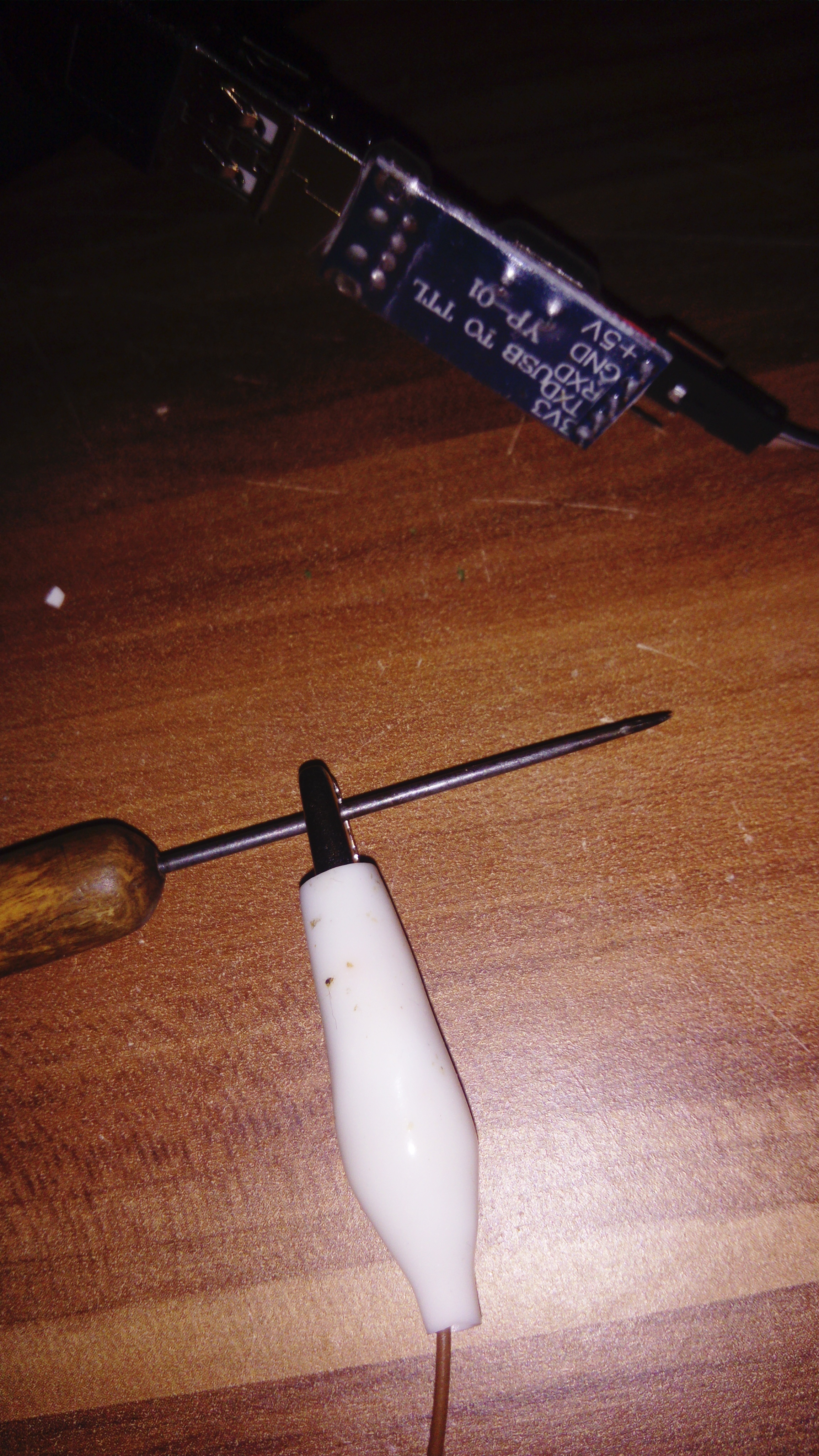

So, I made custom probe device:
Connected rs-usb converter to pc, set baudrate to 250000 and opened communication in cutecom.
Connected gnd of converter to gnd populated on icsp for atmega2560, then “touched” with the probe 3rd pin (Txd0, pe1).
Silent.
So, definitely atmega2560 is dead. Or crystal?
Thanks anyway and best regards.

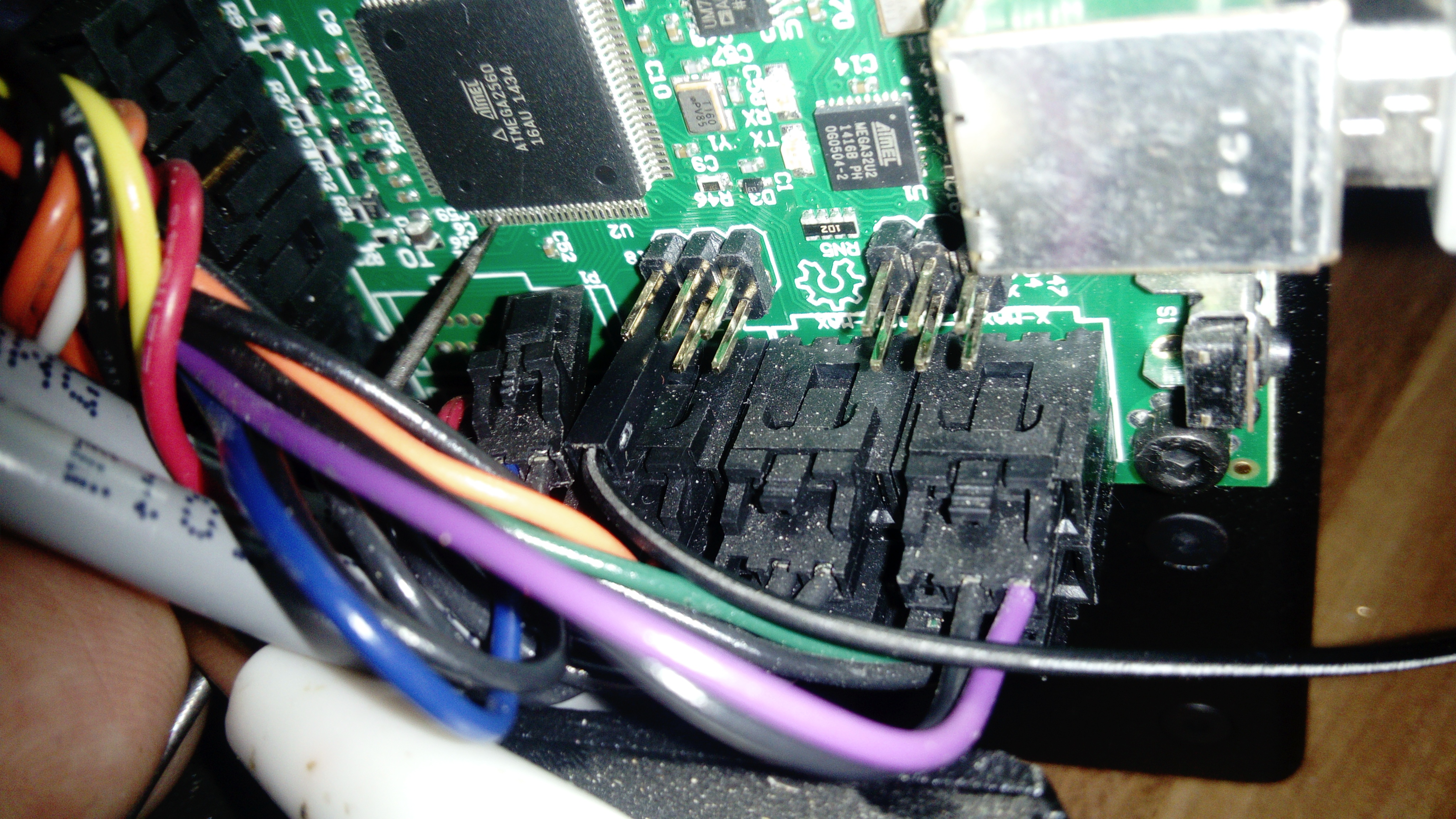

Before declaring it dead I would disconnect all wires and get it on its own onto a bench. make sure its getting good power and try again. Also try a baud of 115200.
OK, there is something weird around here.
I disassembled mainboard. There are testpoints under it, so it’s bit easier to „touch”.
Again: i’ve connected 5v and GND from RS-USB converter and it continous to be silent - there are two RX and two RX testpoints - I believe one from u2 point of view, second one from 2560.
Anyway on both pairs i can recieve what u2 sends, but there is no response.
BUT!
I’ve started to wonder about led1. It blinks twice after reset. Prevoiusly I assumed that it is connected to u2, so nothing weird, but it isn’t! It is connected to atmega2560, so it has to be alive!
It is PB7 - D13.
At the moment I’m trying to check what that means in Marlin source and in 2560 datasheet…
Anyway it doeasn’t look good at the moment but I belive we are closer to recognize the problem.
…or I’ll try to upload blink program to mega via ICSP.
