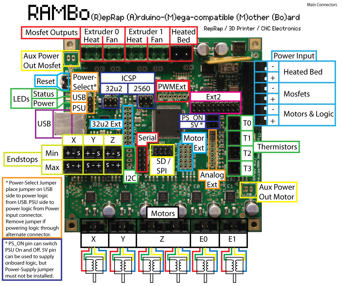

Currently I have TTL hooked up to the MX2 pins 45 and -. However, I am having a hard time testing the TTL output. Hooking up my multi meter isnt giving me a clear reading. Am I supposed to be issuing something other than an M3 XXX command? I have also tried M5. Just to add to the confusion, I tried to look at the 12V output on Fan 0 and im getting the same voltage output at M106 S0 as I am at M106 S255. Kind of feel like im missing something!

Probably he can use pin 4 or 5. They are PWM capable and it seems can be found on “PWN extensions” pin set.

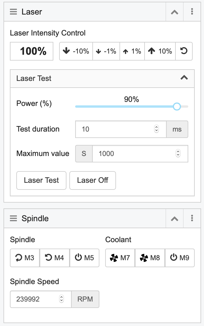

Im going to test using the CNCjs commands. Can I issue a M3 S255 and M3 S0 to test? Or do I need to call out the pin like M42 P4 S255. Im assuming there should be voltage change between 0v and 5v.

yes, pinout file defines for RAMBO
// M3/M4/M5 - Spindle/Laser Control
#define SPINDLE_LASER_PWM_PIN 45 // MUST BE HARDWARE PWM
#define SPINDLE_LASER_ENABLE_PIN 31 // Pin should have a pullup!
#define SPINDLE_DIR_PIN 32
and it seems
pin 45 is PWM capable.
in theory should work. the last task is to found it on the board
Testing between pin 45 and the ground pin next to it (a few pins over) I get a minor fluctuation but no major voltage changes
 same thing for pin 31.

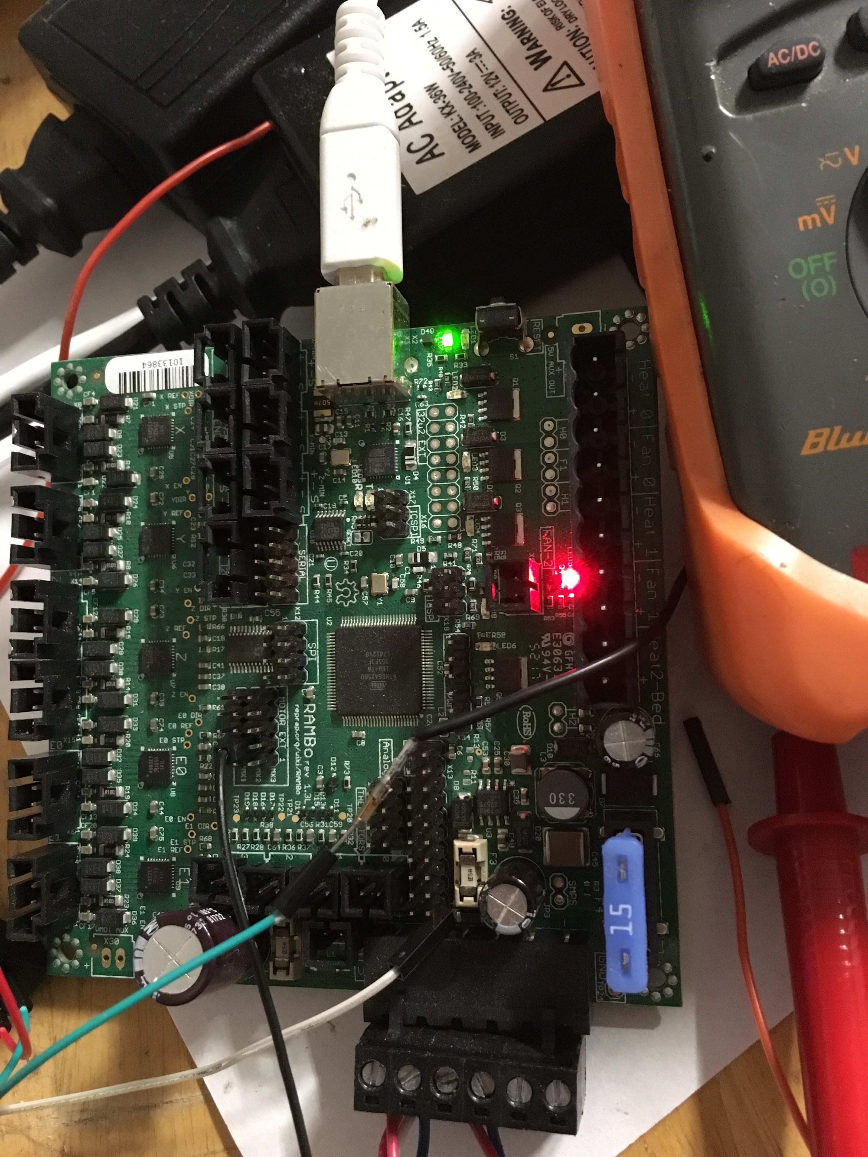

Thanks Guffy, any thoughts on why when I uncomment the #define SPINDLE_LASER_ENABLE I get a red LED between the mosfet connectors and the Fan 2 connector? Its on as soon as the sketch uploads
 oddly it goes away if I comment it out again, also uncommenting that doesnt seem make the M3/M5 commands work, but you M42 command can pull that pin high
 wanting to use this with Lightburn I think I need it to work on M3/M5 or M106/M107.

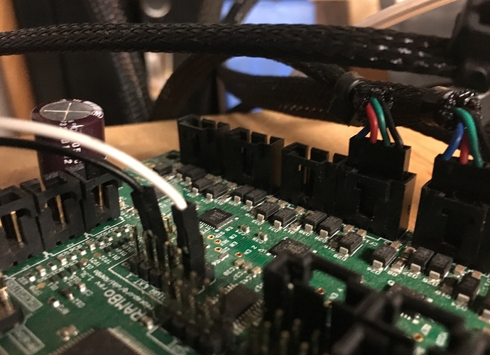

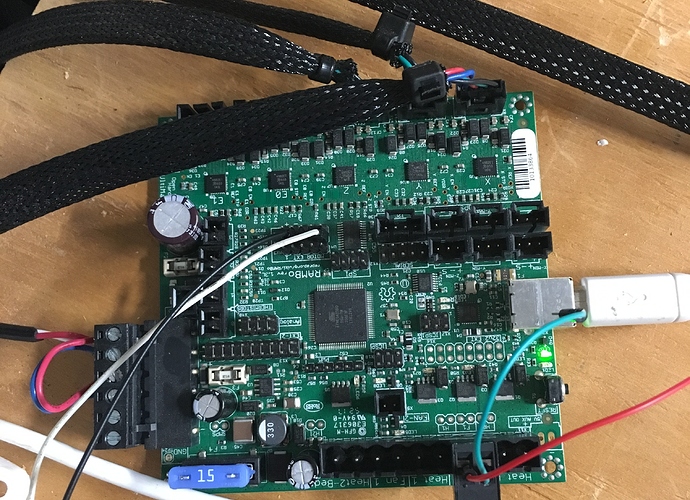

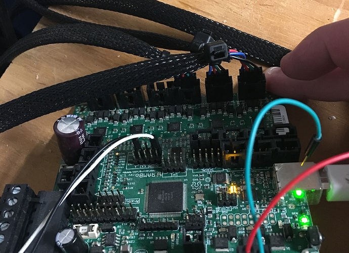

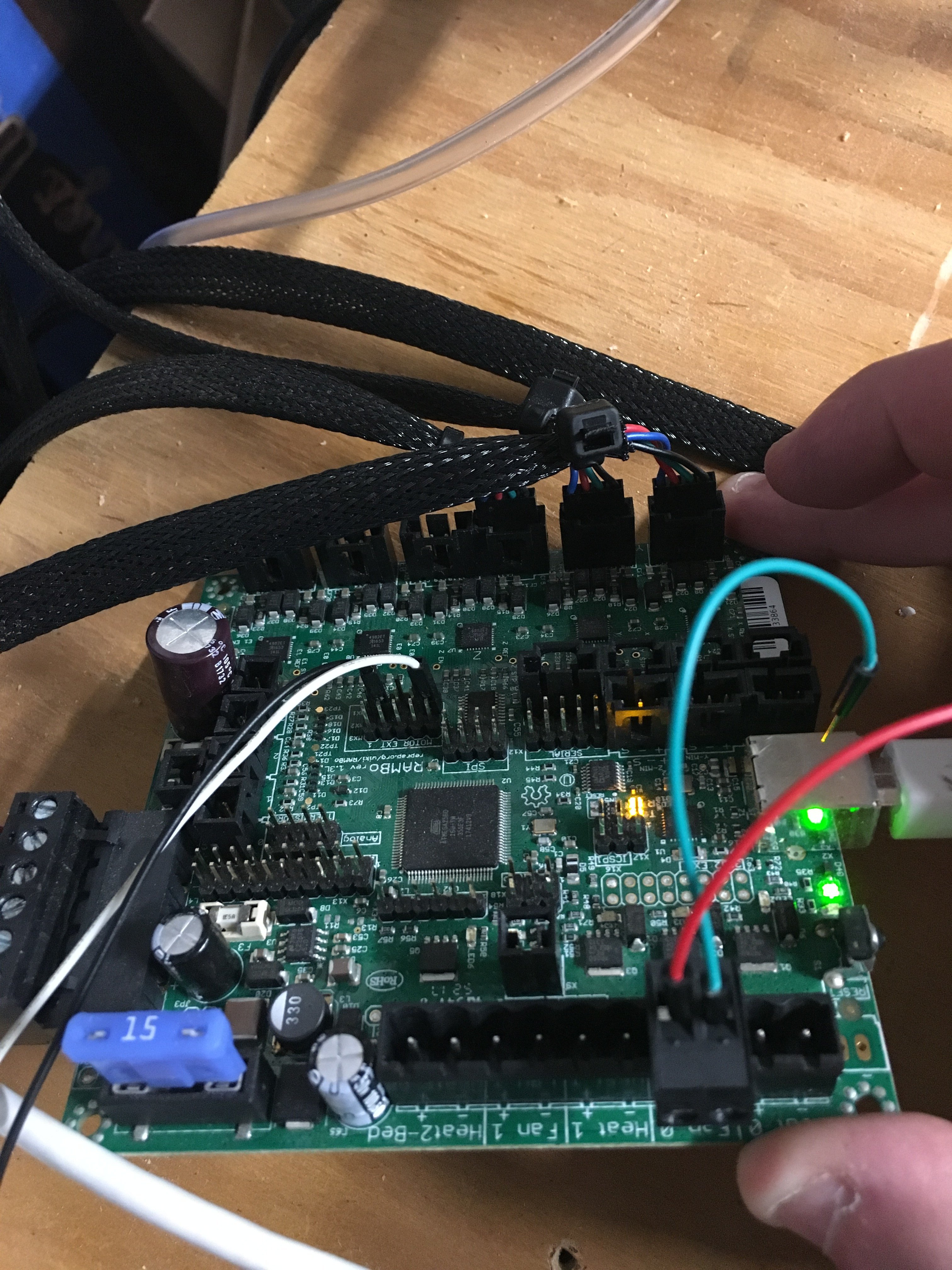

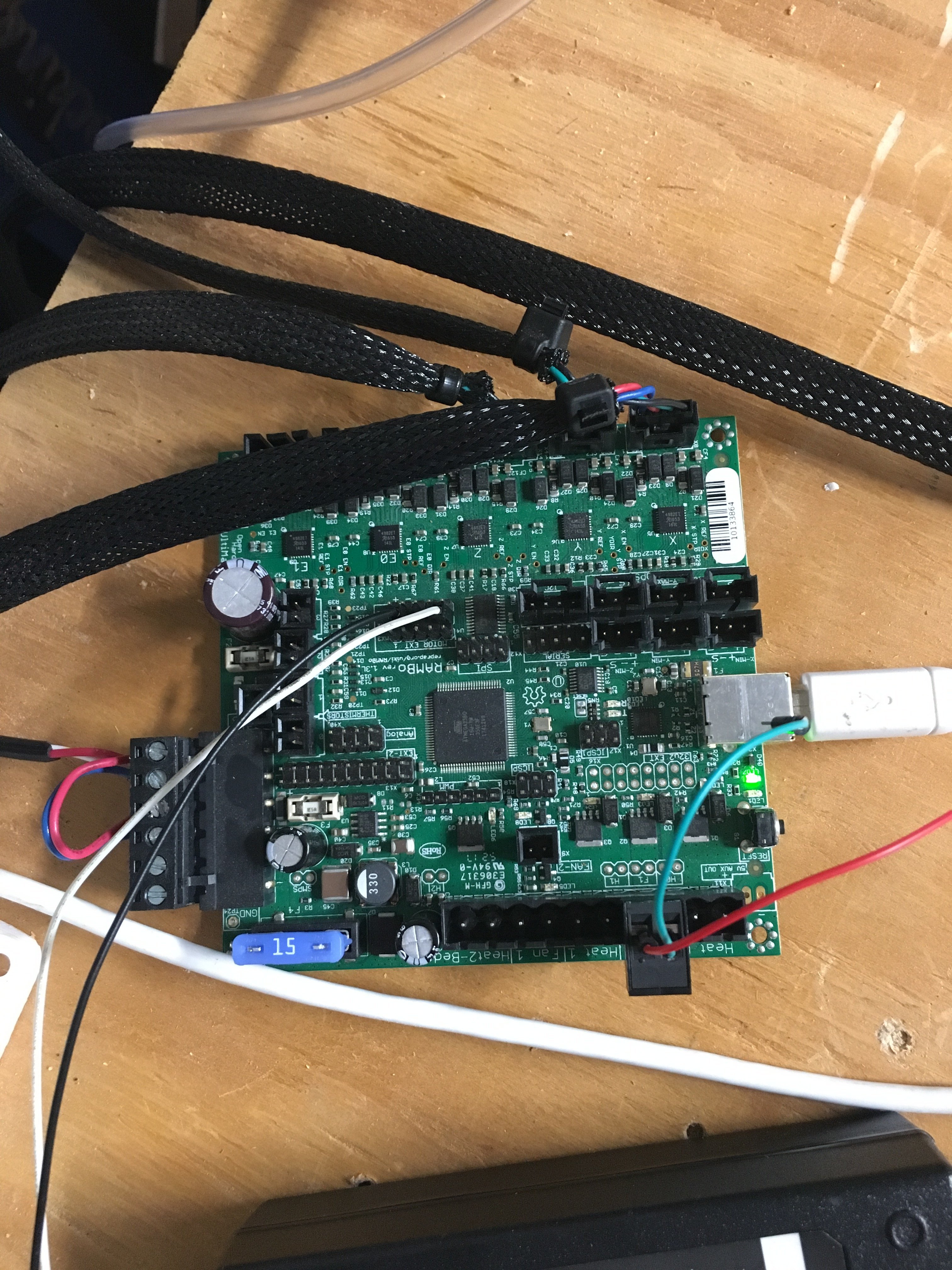

Can you show a picture with everything plugged in as you think it should be including your power supply(s)?
Uploading pics of wiring. I’m pretty sure I screwed up my firmware because now I can’t get any motion. I did notice that that I no longer get the SD Init Error on boot!

That is what I thought, you have two power supply running and the laser has said it shares the ground with the main power and signal. I think your problems are here. The board only needs a tiny bit of power, run the laser and board off the same power supply, whichever has the most amps. They could be fighting a ground difference/interference, or some other oddity caused by two power supply sharing a ground.
You have bare wires floating around naked pins in two your pictures, you need to be very careful with that.
Re-flash your board back to stock and verify it works, if it does, only change the three lines I mentioned. I will not have time to test this until after the holiday madness slows down. I am sitting on two laser for my write-up.
